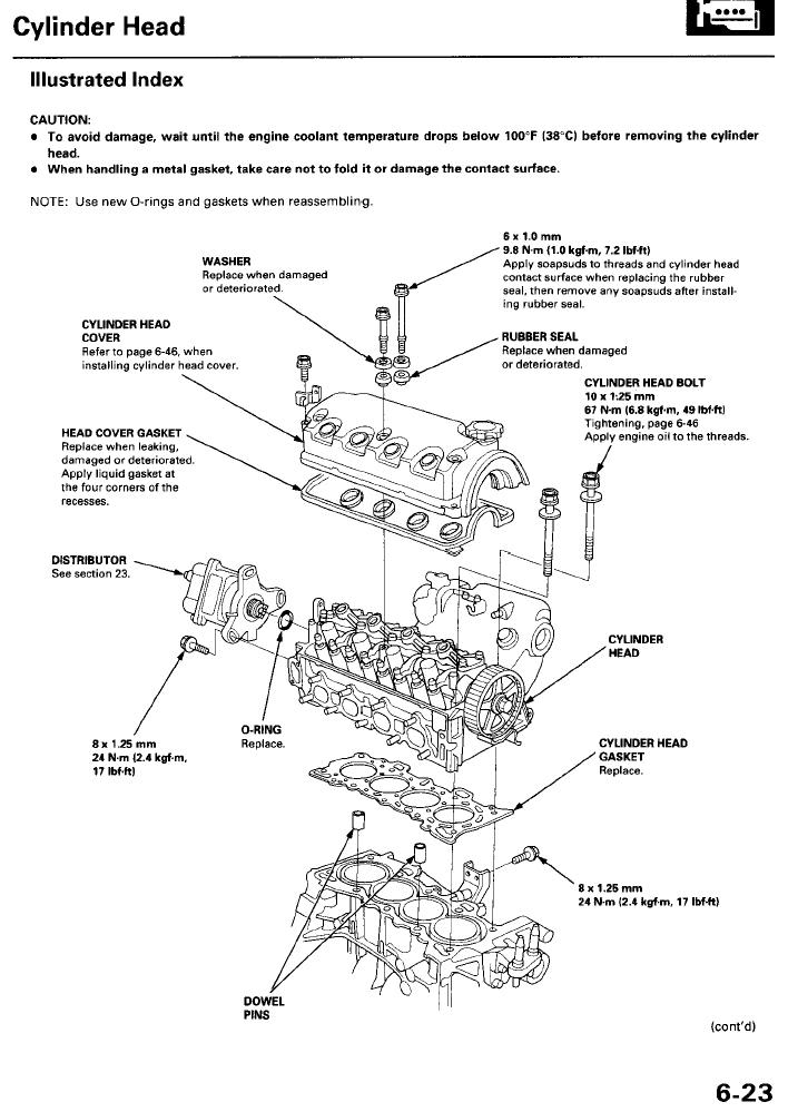

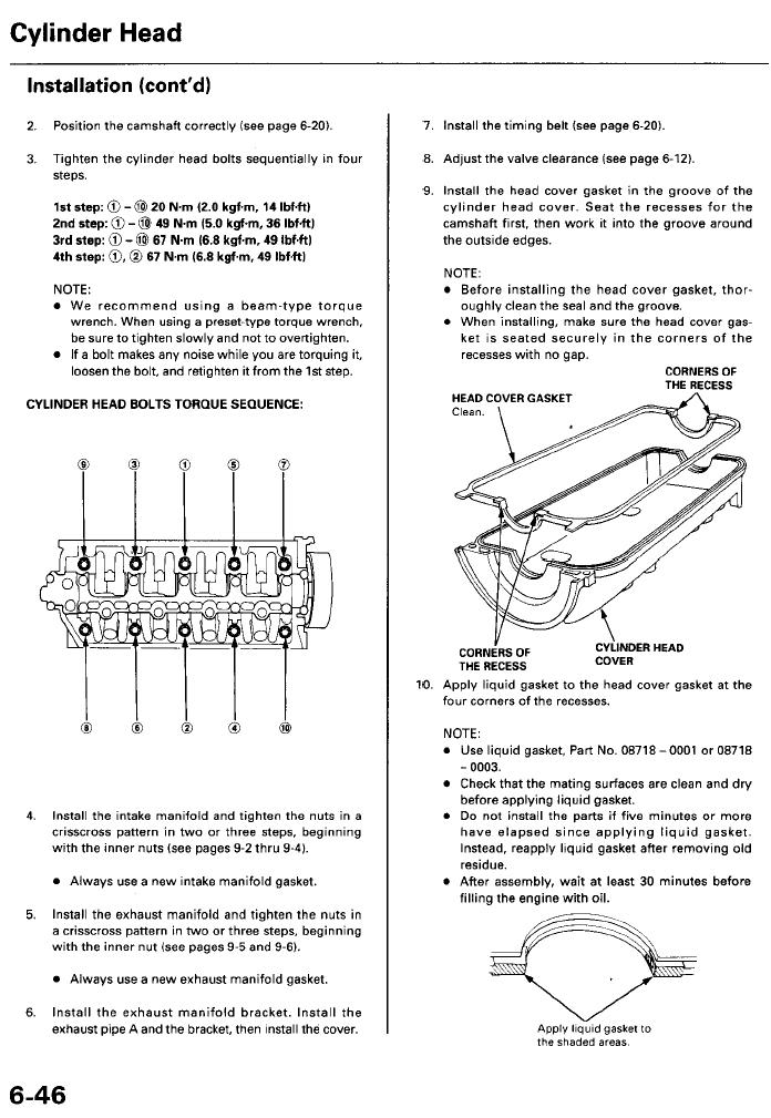

What do you mean "out of the distributor cap?" Are you sure you're not leaking oil out of the top cover which is flowing into the distributor cap? We can't help you if you don't know what the situation is.

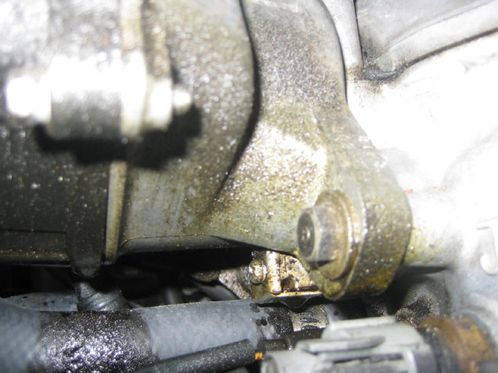

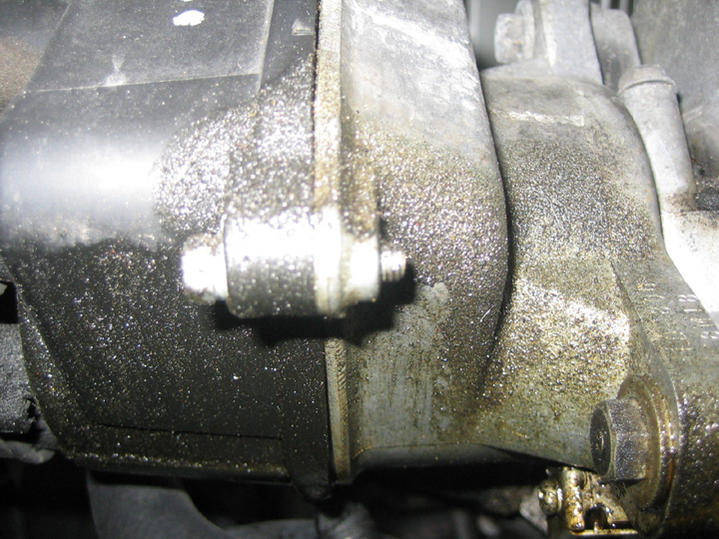

thank you for responding. please see the attached pictures to me it seems that the leak is right at the cap. What do you think?
