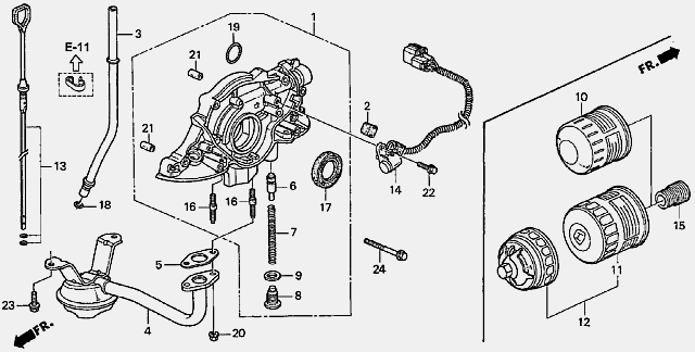

Your setup looks similar to mine, even though mines a 7th gen, but I found it easier to replace the oil pump while I had all of that stuff off anyways, it comes with the seal already installed. The only drawback is you have to take off the oil pan, which I did anyway because that was leaking also. But for some reason my pump was only about $40, yours is $93.

Yeah, as long as you don't mind pulling the oil pan, it is way easier to replace the pump than to try and pry the seal out without damaging the pump or the crank ( I did it that way the first time I changed my timing belt). Youjust get the pump, and the strainer off of the bottom of the block,( I reused the strainer, just cleaned it really good and put on a new gasket), clean the oil-pump gasket surface thoroughly, and my repair manual said to use anaerobic sealant for the gasket- expensive, but works great. The torque for the oil pump bolts is 96 in-lbs or 11 Nm, at least on my car which is an '02, but yours are probably the same size bolts going into an aluminum block, so I guess it would be the same torque.
