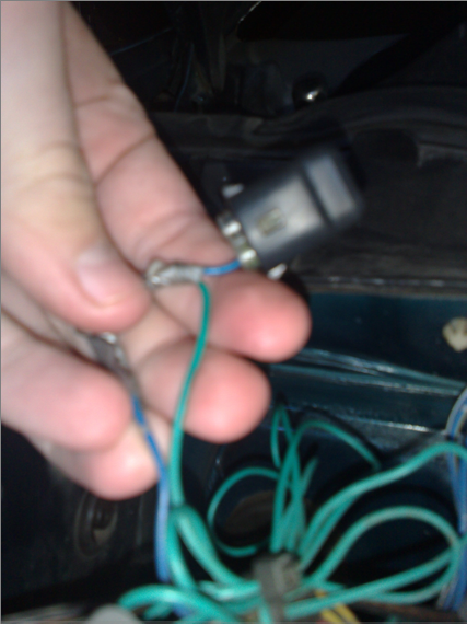

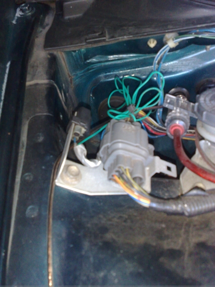

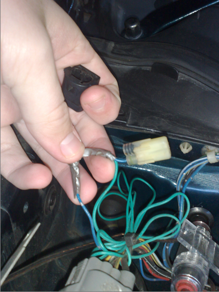

Re: Tachometer
this is on the drivers side of my car obviously but im guessing everything is just mirrored for you ...
you can see the plug im talking about next to the main harness
this is just what it looks like when u pull it off
and this is it when you pull the rubber cover off
I just spliced into the wire with the green tach wire and works fine for the past 2 years I would use heat shrink instead of tape though its one of those little jobs ill say ill do but never actually gets done...
hope this helps
