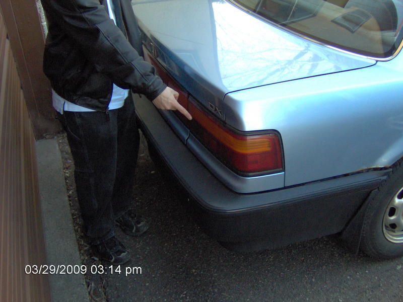

OK, here are pics of the parking lights in question.
the first 2 pics, we are pointing at the lights that should be on. the car is running an the light switch is on.
the second 2 pics show th e lights on with the switch on an the car shut down.
These lights always came on when the car was started no matter where the switch was before this problem began.
