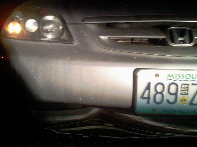

I had tycs, they were crap. period. ps ill sell them to someone for 50 bucks if they will pick them up.
That was after my wreck. dont do 90 in a 25!

yea at this point im tryin to get rid of them lol im in debt after the whole wreck thing. I might try to sell them at an import meet saturday.
Does anyone know if its illegal to have white turn signals? i cleared out my stock headlights and installed them and im a lil worried about it.
