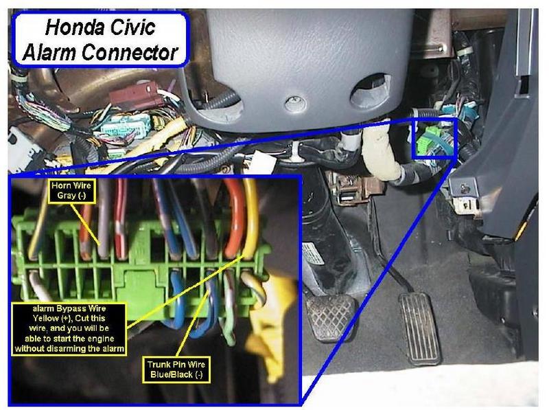

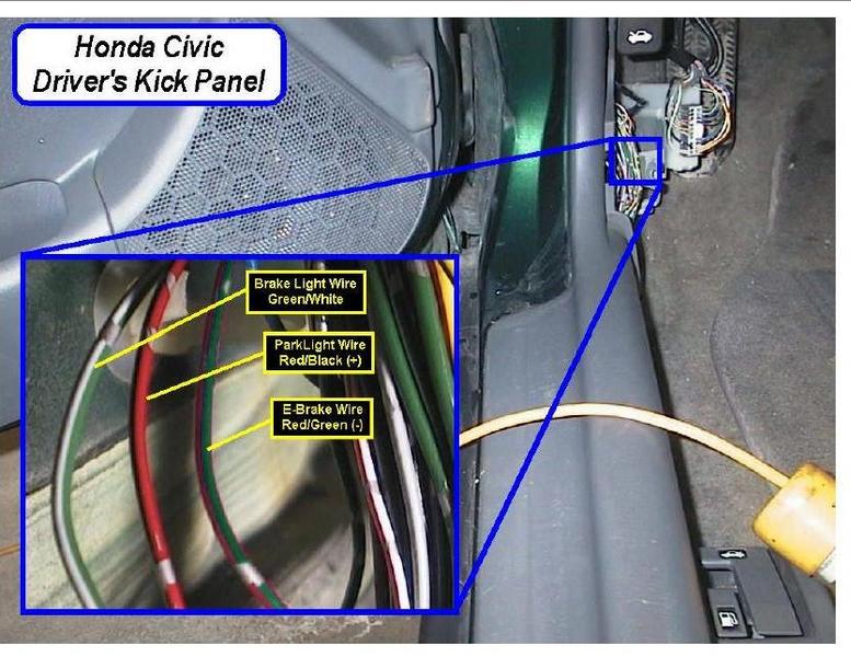

The horn uses the neg to complete the circuite, while the alarm uses a pos. You will have to wire up a relay for this.
The lights, I would also wire up a relay then attach it to the fuse box, there should be some spades that have nothing attached. One of those will be hot when the light are on. Now just hook the relay out put to the pin. That easy.

Or you can just click on the link I provided earlier and read.
Head Lamp Red/White left. Red/Blue right at Steering Column
Horn Wire Blue/Green (-) Steering Column or Green Connector behind Radio

Re: keyless entry installation
and back on track...
ID:	73222   Click image for larger version
Name:	civic lights.jpg
