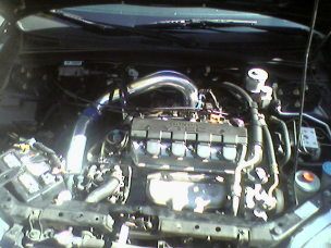

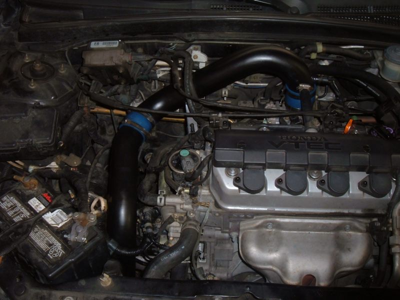

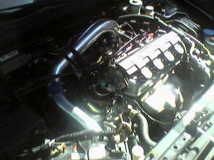

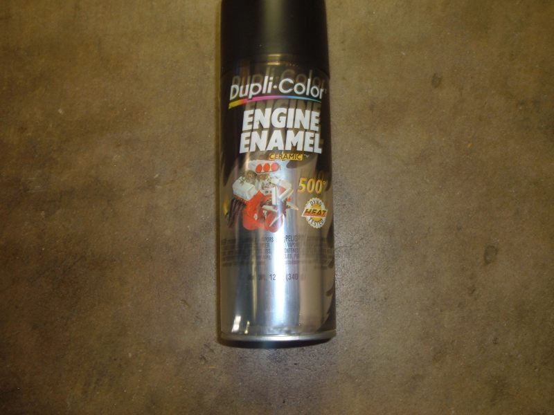

Today I decided to paint my intake pipes. Just standard pipes from Ebay with a K&N filter on it. Attached are pics of pipes before and after...(even though the pics are in reverse order) and of the paint I used. It's very simple. Simply clean the pipes of all dirt, dust, etc. etc... wash them, dry them, sand them, and then start. Spray a coat, let dry, sand... repeat. (I sanded only twice, and used about a half a can of paint) I plugged the holes up with newspaper and old rags. It comes out very nice... I painted mine black and it kinda reminded me of a K&N CAI. I suggest this as those standard pipes are a pain in the @$$ to keep clean and polished.

Nice, engine bay is a lil dirty, lol.
Did you sand down the pipe with anything first? I'm curious to see how long it lasts if you didn't.

yes I did sand it down.

I'd wash them, dry them, sand them- plug them, spray them, dry, spray, dry, spray, dry, spray clear, dry, spray clear. Sand inbetween possibly- I'm not a big fan of sanding between coats.
It looks better then ebay pipes. You def should throw some clear coat on threre. Did it take you only one can? Hmm.. yeah, engine bay needs some degreaser and some elbow action!!
good job partna- you should edit orig post and throw the sanding step in to begin with
