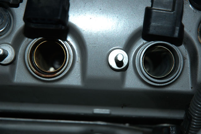

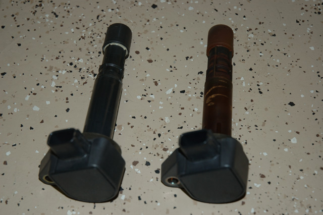

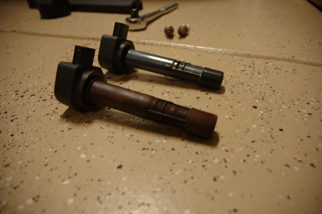

well i checked the spark plugs as recommended...
and i pulled the coil out and found the third one to be brown and smelled like gas and exhaust...
pictures are attached...what should i do? replace it? bigger issue? safe to start it up?

my car's completely stock. i replaced the plugs last night and was hoping it would go away. but the coils came out brown like the pictures above.
how hard is it to replace the head gasket?
