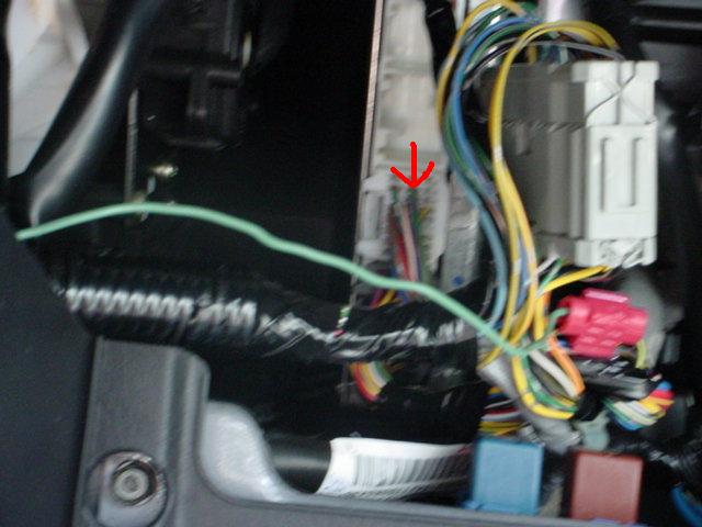

I need to no excatly where the test tach wire is, i've seen the diy but where is it at, picture would be awesome, installing a tach with fiberglassed cover to the contour of the dash, in next couple of days, any help would be greatly appreciated, thanks!!

Its wire 26 in the ECU 'E' connector.
Its blue.

where is the ecu e connector located,thanks

behind the glove compartment, ignore the red arrow in the pic

which one is the e connector, taped one blue not sure if its the right one, tach not working, lights up with console lights, getting check engine light, car runs fine like it always has, any way to get rid of this light, thanks man!!

where excatly is the test tach wire next to battery, help!!!!!!

the tach wire is on the left side of the battey when your looking inot the engine bay from the front of the car. It is a blue wire. I believe it is covered by wire loom. Just tap into that, it is where I tapped mine.
