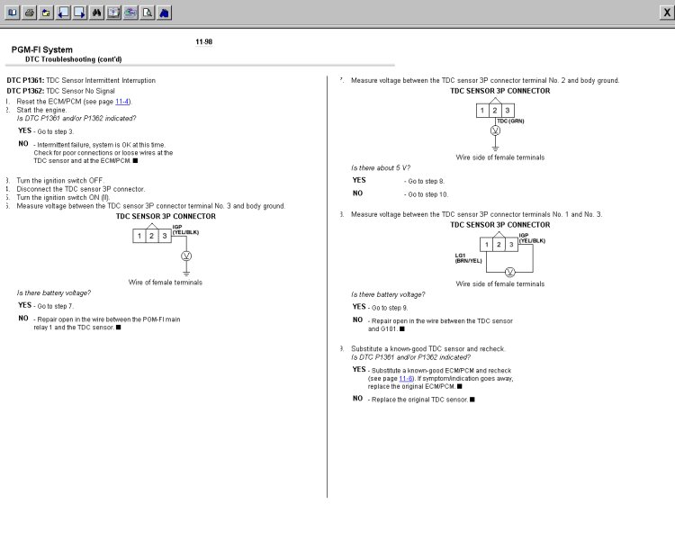

I bought a code reader....it says "TDC sensor intermittent interuption"...what the hell does that mean?
Old Nov 6, 2005
Rep Power: 812
tdc=top dead center referring to the piston position. it means that sensor has a problem. this is a huge deal. get it checked asap.

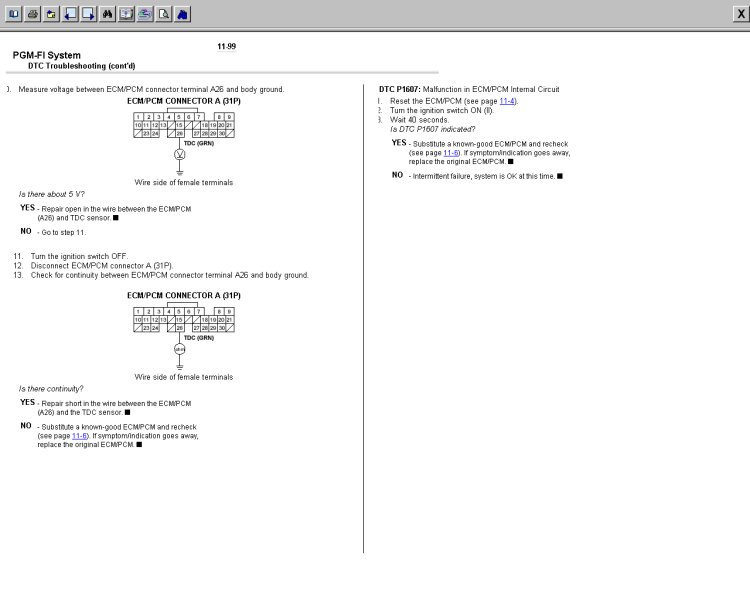

If you want to try to DIY it... Here ya go!
ID:	61918   Click image for larger version
Old Nov 7, 2005
prccivic's Avatar
Posts: 1,900
From: P-Town, CA
^^ Wow!....thats sweet info..but unfortunatly i left my car with my parents and had to drive back to school tonight, so i can't try it...my dad is just gonna take it to the shop tomorrow. thanks though
