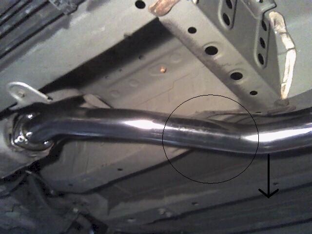

The pipe is really close to the body in taht area right after the Cat. There is no way to lower it. The closeness that pipe is to the body is totally dependant on the bends on the exhaust.
My stock exhaust even vibrated, but mostly in the rain. My new Espelir exhaust also vibrates in the same area in the rain. I really dont think there is anyway around it besides possible a wrap to dampen the sound and protect the pipe from changing temperature too fast.
ALso i seem to notice that it vibrates sometimes when my silencer is on.

Im assuming they just bent the downpipe and the cat so that the cat and pipe right after the cat (shown in my pics) are all lower. Im not sure how good that is for the car?

All you guys should try this, it wirked for me, or atleast helped a bit.
Jack the car up in both front and rear, and loosen the bolts that connect the mid pipe to the front downpipe, and also the rear bolts that connect the rear section. Once that is done, grab the midpipe and twist it or pull it down, away from the body. Most of the ratteling you hear is from the mid pipe when it crosses from inside the frame to the outside and goes under the frame rail. If you are able to make alittle more room between the frame and exhaust, it should be alittle better. If not there is nothing else you can do other then lengthning the hangers. This took away quite a bit of rattle for me. Just putting in my 2 cents. PEACE
DMAN

I guess I forgot to tell you to tighten up the bolts again. Once they are loose, try and twist the exhaust away from the frame and with pressure on the exhaust, tighten up the bolts. This should keep it away from the rail.
