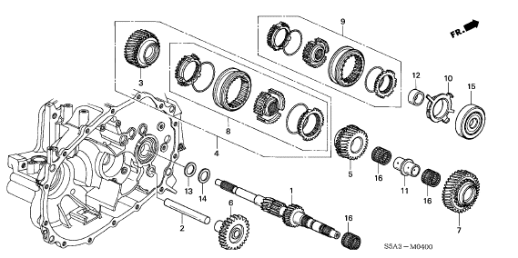

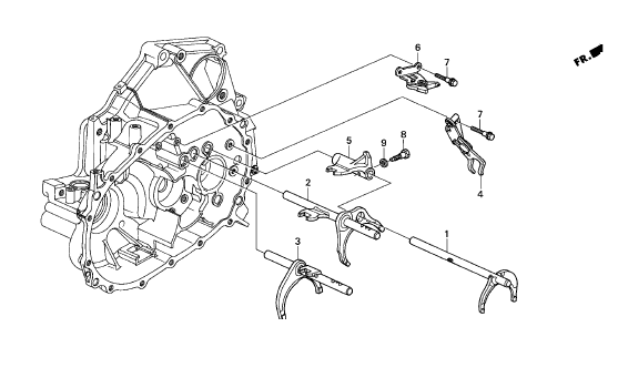

well if you think i don't then so be it... that's why I'm here to learn, now if you know alot about transmission, why don't you justify yourself so I can get this over with...
^^^ok it's the number 9, if you wanted to be all technical then yes, we will call it MT HOUSING...
^^^this is BELL HOUSING is the metal piece that covers the CLUTCH, PRESSURE PLATE AND THE FLYWHEEL...correct?
now I call the whole thing (MT HOUSING + BELL HOUSING) as a whole "BELL HOUSING" coz it shapes like a fuggin bell!
