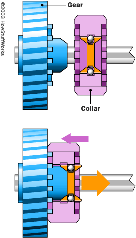

what is it doing? tell me about it, I might be able to help you out...
the synchros are inside the tranny bell housing<<<(oops )
so this is the syncros, i fuggin pretty sure it's inside the fuggin bell tranny... so where could it be if it's not inside the transmission?
ow you fvcker! sorry I missed the AT, I was talkin about the MT... but just to clear this out, the MT synchros is INSIDE the BELL HOUSING right?
