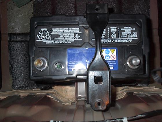

Well I have had this idea for a while and finally decided to work on making it happen.
First off you will need to relocate the battery and it's basically an extension on the end of my V2.
For those of you that have a V2 you know these things get hot quick because they're sucking warm engine bay air. So here is my idea to get some cool air flowing and possibly create a ram effect. Haven't got everything worked out yet, but just wanted some opinions.
I need to get a 4" metal coupling like the 3" one instead of what I have now.
I wanna try to find a light assembly at the junkyard before I hack my good one up because they are expensive , in case I screw up.

I thought our batteries were sealed?

Battery is not sealed. You should get an optima and get the summitracing battery trunk mount kit if you wanna do it right. Idea is good tho, especially ram air if you can make it look good. It already seems nice on the inside from the pics.
