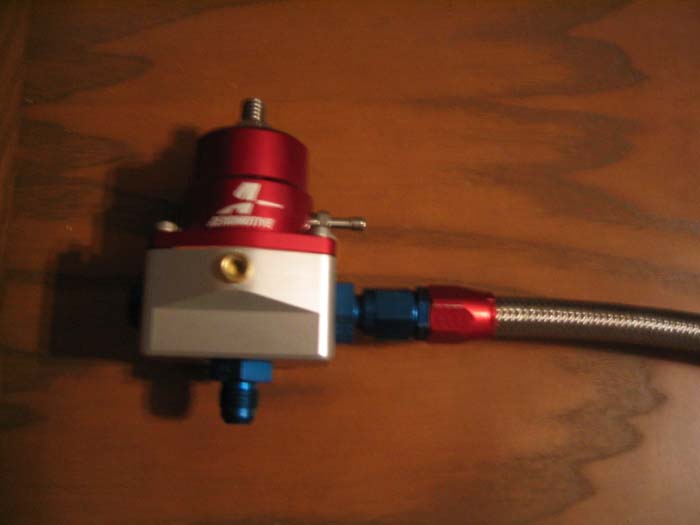

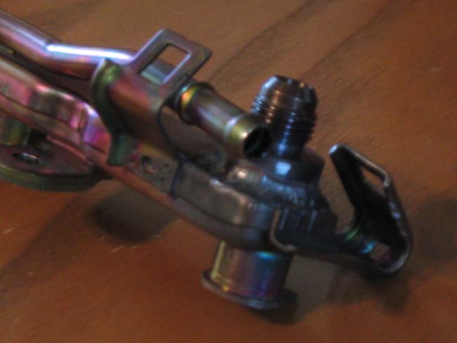

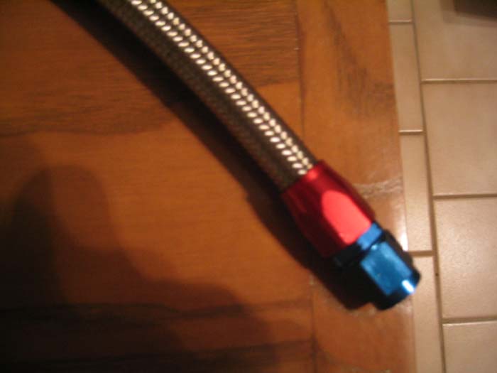

i am attempting to convert my returnless fuel over to a return setup...i am waiting on a couple more things to come in from Street Level Performance and then i will get started on it...i will make a FULLY detailed DIY with pictures for everyone...i know that there are a couple on here, but some dont have pics, and the ones with pics are not complete...but here are few pics of what i have and i am using
pics are of my fpr, fuel preasure gauge, and my modded fuel rail...also going with walbro fuel pump, and earls stainless braided line...it is going to be nice....

damn , you got those pics up quick. yeah , thats the same fpr i was looking at . pics look nice though dude .

Should be nice, btw, have you done a leak/pressure test on the rail to make sure the weld is leakproof? Before you put it on, I'd test it to 125 psi at least. Did you have the weld job done local?
Old Jun 27, 2004
opto_isolator's Avatar
Posts: 3,024
Rep Power: 313
Originally Posted by andyman97
Yeah, if he can ever get his hands on a turbo, lol.
Personally I would have it brazed on. The fuel rail is "sweated" together - and if you try and weld a fitting on, it may cause problems due to the heat. I had my fitting brazed on and had no issues with it at all...

I agree. It's always a smart idea to test it for pressure and leakage before install, though. It's no fun to put it back together and have a leak, then start from scratch.

the welder and i took that into consideration...he chose to weld it because a weld is stronger than brazing, and he also stated that the temp he would weld it at would still penetrate both metals but would not be any hotter than what a torch would be when brazing it on...he also stated that the fuel rail would come apart before the weld leaked...

was that tig welded? It looks like a REAL clean weld. Id imagine if it was tig welded it would generate less heat then brazing, but i could be wrong.

yes , it was tig welded

what modification is done to the fuel rail. is that additon for the return fuel line?
Old Jul 11, 2004
02fpcivic's Avatar
Posts: 1,222
From: Middleboro,MA
Rep Power: 298
02fpcivic is a glorious beacon of light02fpcivic is a glorious beacon of light02fpcivic is a glorious beacon of light02fpcivic is a glorious beacon of light02fpcivic is a glorious beacon of light02fpcivic is a glorious beacon of light02fpcivic is a glorious beacon of light
Hey guys if you are using that reg. then u dont need to mod the rail. its a bypass style. i set mine up with that one last year, 6k miles ago works mint. after serious hacking of the sending unit assembly i got a walbro pump in there and bypassed the factory reg. just drill a hole in the top of the sending unit and tap a brass pipe elbow into it to hook to the return. when its apart you can see where it should go. dont forget to change over to high pressure line from the pump to the top of the unit. there are two hoses originally, only use one from the pump to the top of the sending unit and find something to seal off the other one. there is a fuel filter that is built into the top of the sending unit. make sure you hook up the line so the fuel flows through the filter. leave enough slack in your hose so the sending unit will still move. its hard to get everything back into the tank so be patient. its a pain but with some common knowledge of fuel systems and some hacking skills you can easily do it
