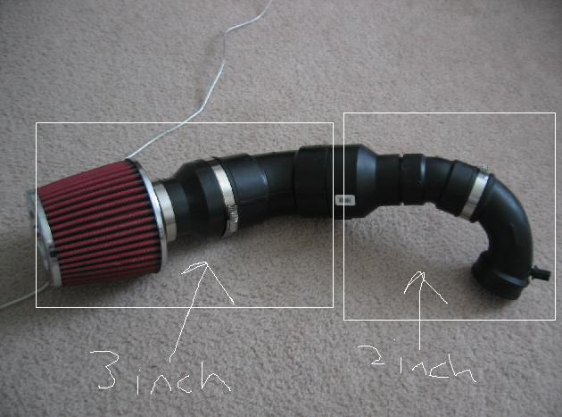

tryin to do something like the V2 huh? with the two diameters (bigger then smaller leading to the throttle body) im guessing it would compensate for flow AND velocity. flow gives high end while velocity gives low end. when the air hits the smaller diamter, itll probablyaccelerate since it will have to conform to the smaller diameters.
but remember, adding too small an opening at the TB (source) could hinder airflow since at a certain point, there would be too much velocity and too little airflow.
you have to find a reasonable compromise between the two. stock airboxes promote more velocity than flow with therestricted areas inside the box, small filter and small opening. openelement filters (cai, sri) promote flow over velocity, since the open filter element throws low end torque out the window with very little vacuum pressire that is present with enclosed filters.

heres a pic of my super-ghetto intake that has two diamters.

You need a LOOOOOOOOOOOOOOOOOOOOOOOOOOOOOOOOONG nozzle for it to work. A plumbing collector is too short of a reducer and it'll just cause recirculation zones, which inturn will actually reduce the inlet area to a size even smaller than the pipe, and slow it down since theres air basically moving "in reverse".

^^^ oh yeah good point. haah no wonder there seems to be something wrong with my "pipe." smoothness is key huh? especially for the airflow. dont want it interupted too much while in the airtract.

Well you want smooth airflow (for speed) up until the intake main, where the air should become turbulent for better combustion.
I like skarteez's intake, but it looks like it may not do the job as well as an aftermarket one.

^^^^ yeaaaaaaaaaaaaaaaaaah!!!! i know, it was more of a "hey look i made it and it sounds kinda cool" rather than "hey i made it and its plastic so its realgood."
