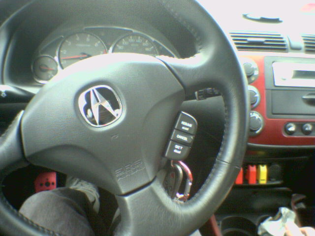

The message above was originally what I posted. I installed the wheel today, easy as pie. Below is a pic of the installed wheel in my (dirty) car. I also have a link to the imagestation gallery with another pic plus pics of my old steering wheel at the bottom somewhere.

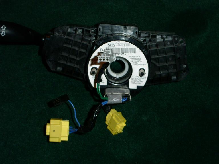

Since your in Canada, your airbag is a 2 wire, single inflator type like the jdm ones. The US airbag is 4 wire, dual inflator. So if your RSX airbag has two wires you should be good.
As for the cruise wiring, the RSX switch has the generic Honda flat 3 pin plug.

Well, installed it this morning, relatively easy after waiting the 30 minutes after unplugging the power supply. Few things:
- Wheel fits perfectly on the column of course
- airbag plugs right in
- cruise control harness (thankfully one came with the RSX wheel) had to be spliced into the EL cruise control harness. easy
- I looked for like 5 minutes for where the horn wire (brown) plugs into the RSX wheel...I couldn't find it ANYWHERE. So I clipped the harness off, stripped the wire, then just grounded it into a screw on the RSX wheel that would be hidden by the airbag assembly. Whoopsie. When I reconnected the battery, the horn started going off. So I'm like WTF, I don't wanna have to leave this thing hanging. But then as I removed the airbag assembly a SECOND time to check it out, I found that the harness plugs into a spot on the RSX AIRBAG assembly. Dammit! I took the stripped wire end and just connected it manually to the new point and then wrapped with e-tape. Reconnected batt, horn works.
Took it out for a drive, tested the cruise control and horn - faboo. I love the slightly thicker feel of this steering wheel. Yay!

Here's a couple. I'll post up a FS for the steering wheel soon enough:

Wheeeeee!!!!!
