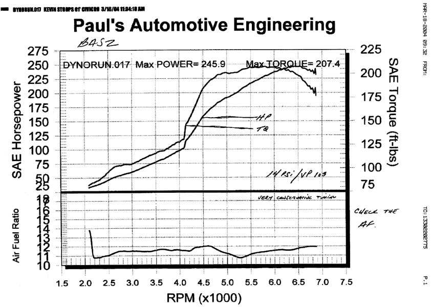

prob not something that ur lookin for but...

That dyno right there shows what a good cam could do for our car with a turbo (granted its a stock VTEC cam) - just imagine what a custom cut cam could do with FI and PnP and intake manifold.....aaaggghhh.......

I thought that dyno was from someone that turboed the car with the TD kit?!

It is - but the dyno shows where the turbo and vtec kick in. Vtec is just a stock cam with greater lift - so the head can breathe easier.....much better for turbo setup.....

whoa people that is not a dyno of the TD kit, its a dyno of my custom kit

very respectable.
