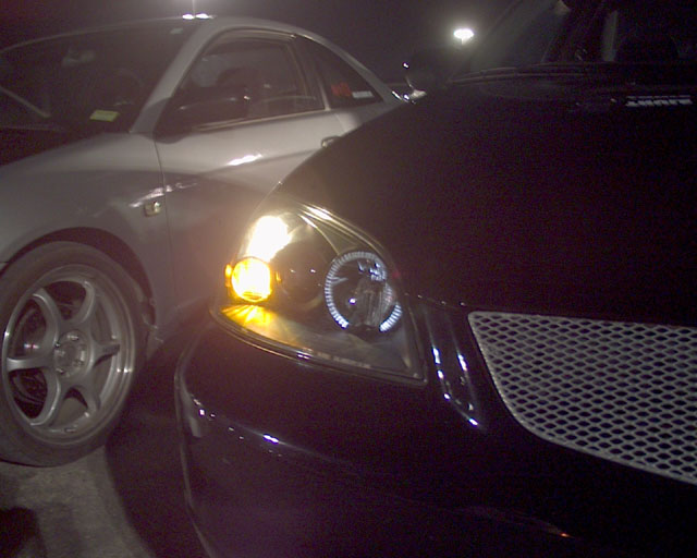

They do have a bead of silicone already in them. And then they are snapped together. I redid them completly and did angel eyes, and then resealed. Haven't had a problem since.

pix
here are my lights after I did angel eyes, if u're interested, let me know.

Old Mar 5, 2004
Rep Power: 812
Wow those are very nice!

damn very nice, id say if u have to time and experience do it, otherwise like me - let it slide
