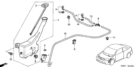

Trying to fix your problem wouldn't really be too hard for the average DoItYourself'er, but there's a lot of work. You're going to have to take your front bumper off to see the main part of the container. The container isn't clear so you probably won't see it's contents very well, but you should check for any damage (maybe your fluids are leaking out).
There's not too many parts involved so it won't get complicated. You can probably take out the container yourself and see if anything inside is stalling. But as i said, for the experienced modders, this would be a cinch. If you don't feel like stripping and messing around with your front end, you should take it to the dealership and let them handle it. They should cover that under warantee.
Here's the few parts involved with the windshield washer system:

thanx thats very helpful
i'll just chose a day when im off and go stripping...mad stripping
