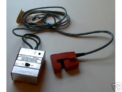

will this work ?
THIS IS A SNAP ON MT255 IGNITION TIMING ADAPTER. It is a used timing light adapter and it converts the double signal passing through the secondary ignition wires into one signal on most automotive distributorless ignition systems. This allows the inductive pick-up timing lights to monitor timing with the MT1221, or both timing and engine advance with the MT1241P or MT2261AP. A single 9V battery (not-included) powers the MT255. It would cost over 250.00 to buy this off the truck, but why pay those high prices when you don't have too. It is in great condition!
Add this to your collection!

not with our civics...most DIS-Igniton options will not work.
JET V-force can advance ignition timing but this will not.
