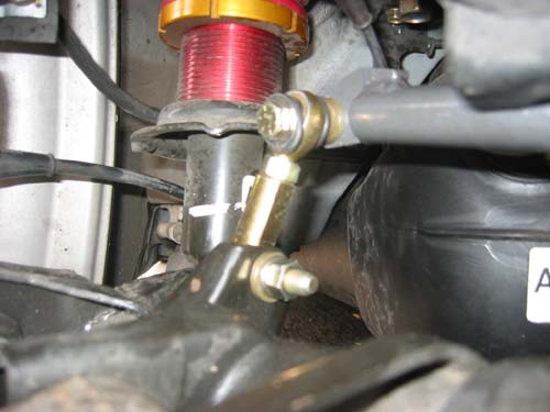

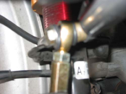

sorry the pictures suck, its my phone that is taking the pics
my front sway with b-pipe off
rear sway endlink
front endlink

omg...from the pic of the rear endlinks, it seems that hondaluver's ex and mine are different. Looks from the pic urs points inward like the one in Grey's DIY pic, i'll try to get a pic up asap

HondaLuver: I think you installed the rear endlinks wrong. See how the front is installed? See the bracket that's attached to the lower control arm in the front? The flat side of the bracket should have the endlink on it. The back of it should just have the nut and washer. Unless your way of mounting it allows the endlinks to be more squared up?
Also... On the front. It looks like the whole assembly is loose. Did you tighten it to 47 foot pounds?

Grey: in pic #2 - that's the way i have it on mine too...that's the only way to get the endlink even slightly square with the mounting point. else it'll be a worse slant than the one i have now...

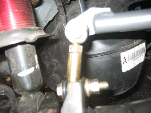

here's mine, i had to use THREE washers at the top (endlink - end of sway bar) to easy the angle a little, but its still pretty badly slanted.

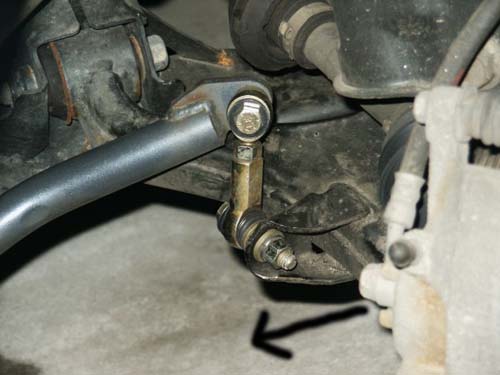

grey: here's the one on your DIY for reference...notice the direction of the mounting point..i marked the direction with that black arrow...the one in my pic points up.

another view of mine.

u can kinda see the slant, but it's worse than it looks, the pic is just blurred a little...bad focus

u can't really tell, but the black rubber bushing on the left is pushed so far out that it is wedged over the aluminum washer on ITS left side.

Ok, the pic you're referring to shows the front lower control arm, not the rear. That's why the mounting point is pointing sideways and not up. The mounting point in the rear points up. I didn't expect you to have to mount the endlink on the other side. Are you sure it wouldn't be better to mount it the way I intended? From the pictures it seems that the "crookedness" would even out across both ball joints instead of just one. Remember that the endlink itself can be crooked. It's the ball joints' perpendicularity that should be maintained.
Can someone try to mount an endlink the way I intended and send in a couple of pictures? Also, these pictures are taken when the suspension is at full droop. Remember that when the car is lowered to the ground the "crookedness" will be straightened out. If you take a picture of the enlinks when the car is on the ground, then you'll see that the angles are much more perpendicular.
Anyway, someone please please try mounting them the way I intended... I can't imagine it in 3D from the pictures, but it seems to me that the angles are better the way I envisioned. After all, I'm copying the stock endlinks, so there shouldn't be a problem. Wait, do the stock endlinks in the rear mount like these that you guys mounted? I don't think so, right?
