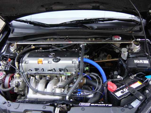

Old Sep 28, 2003
civicvtec1ps's Avatar
Search and Learn
Posts: 14,004
From: 909, Socal
Rep Power: 432
Originally posted by R1Style
Are you sure? Because I wanna get a RSX Front Strut bar...
what kind?
i know spoon ones fit. dc5@em2 has it
Old Sep 29, 2003
R1Style's Avatar
Posts: 7,785
From: London, Ontario, Canada
Rep Power: 370
I was looking at the Mugen
