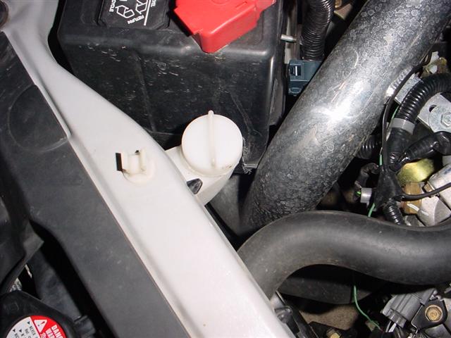

Cut the corner off the tray. Then it fits.
Its dark, but lemme see if I can get something to show up.

Try that.

Boilermaker1: does the battery sit flat or is it on an angle after cutting the tray? for some reason, i don't seem to have that much clearance between the pipe and the tray. i mean, the pipe is touching the fan shroud, and is touching the metal plate the battery tray sits on.
once the bracket for the grounding screw is in, i can't move anything.
thanks for the help guys, it's really appreciated.

Something isn't right. It sounds like you've got it set too far forward. Unbolt the clamps and the bracket in the picture, and push the whole intake towards the firewall. I've got the battery sitting flat, where the tray should be and it all goes back together with ease.
