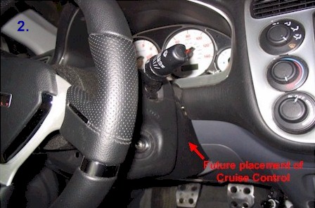

DIY: Cruise Control Relocation

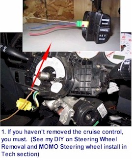

1. Install time (with cruise already removed) 1.5 hours
DIY: Steering Wheel Removal (airbag) and MOMO Steering Wheel Install
http://www.7thgencivic.com/forums/sh...+wheel+install
Name:	first (removal of cruise from column).jpg

Name:	pic 1 (future placement of cruise control).jpg

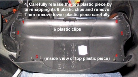

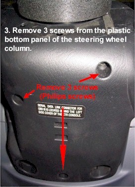

Name:	pic 2 (unscrew bottom of steering column).jpg

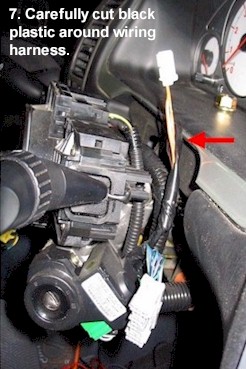

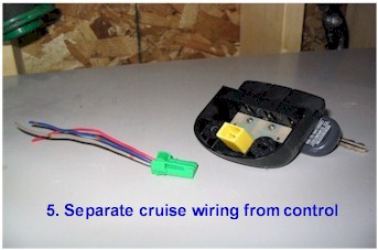

Name:	pic 4 (separate cruise and wiring).jpg

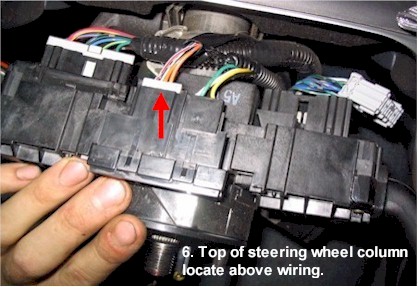

Name:	pic 5 (top of steering column - wiring).jpg

Name:	pic 6 (open wire harness).jpg
Old Sep 11, 2003
poor jaysun's Avatar
Posts: 1,156
From: Alberta, Canada
Rep Power: 293
poor jaysun will become famous soon enoughpoor jaysun will become famous soon enough
Name:	pic 6.5 (wire cutting from plug).jpg

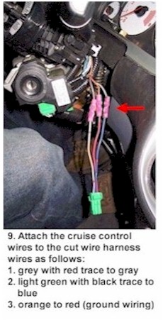

Name:	pic 7 (attach wiring with cruise wiring).jpg

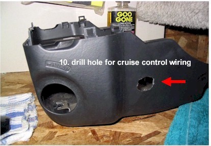

Name:	pic 8 (drill a hole for cruise wiring).jpg

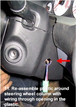

Name:	pic 9 (re-attach lower plastic with wiring through hole).jpg

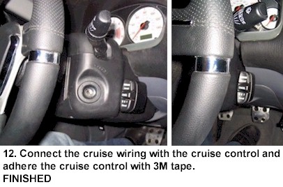

Name:	pic 11 (attach cruise control to column).jpg

How strong are they stuck there? Is the hole that you dirlled noticable at all or does the cc buttons cover it all the way? Looks great bro.
~nick~
It is held very strongly, 3M tape is used to hold your body kit to your vehicle along with a few other clasps and screws. We carefully drill the hole and rechecked not to over do it. The plastic has a slope to it ... so you have to build up your 3M tape on itself to get the correct fit
IT WILL HOLD. I chose 3M tape because if I need to make any changes I can easily remove it.
