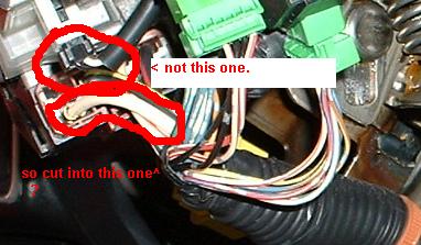

there will be a manual that comes with the kit. You can get ideas on how to at least set it up on the doors, if the 7th gen isn't in the manual.
The kit I bought was an older Spal kit for european cars. The civic wasn't in my manual, so I spent one day trying to set it up on the door (without any drilling).
I didn't bother adding power for the switches' lights, but I would guess the led lights up like the fog light switch; off white/ dirty white.
I tapped into the 12v constant in the sterring column. If you do it from there, you have roll/unroll your windows even when the car is off.

that thick white one is your constant 12V, you shouldnt cut it, just try stripping it back and attaching the 12V window wire to it...or using a relay you can hook it up to the ignition wire and 12v+ so that it only works when they key is in the on position. i didnt buy illuminated switches. i just used the ones that the seller threw in for me and if you decide to get tricky with it, you can even buy an automotive rocker switch and mount it on the drivers side, so you can turn windows on and off...just in case your passangers are button happy. or you leave someone in the car and you dont want them to drain your battery by winding the windows up and down constantly.
