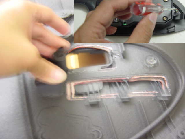

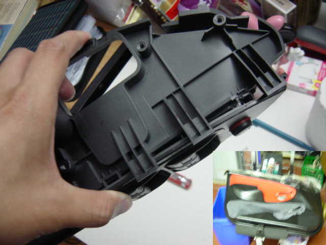

2. Once the door panel is removed, turn to its back, you will see 6 screws, remove them all and unclip in a good angle to remove the whole arm rest unit.
Arm rest is composed of 4 pieces, they are all clipped and hold by screws, it is obvious how to remove all parts if you need to pain them.
FOR coupe, you will have to drill out rivet and replace them by screws, but for sedan there are only screws.

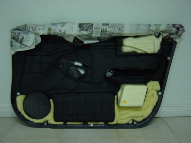

page4

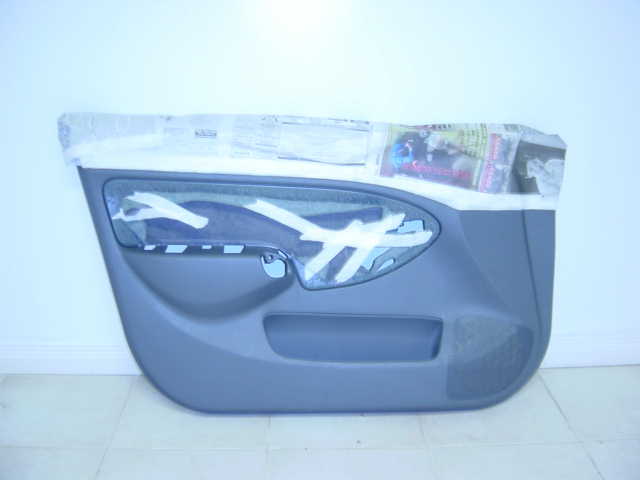

4. spray on rubberize undercoat at the back of the door panel for deadening effect. Use sleeping foam to cover all little space at the door panel for rattle absorbsion.

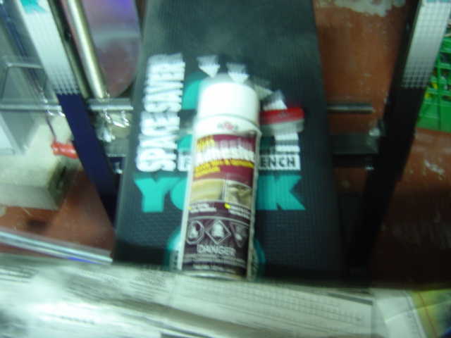

5. Fully cover the area where you want to insert the leather on with this spray adhesive. This is the only adhesive I know of can glue on leather. DO NOT USE "GOOP" or any other glus which can harden when dries!!

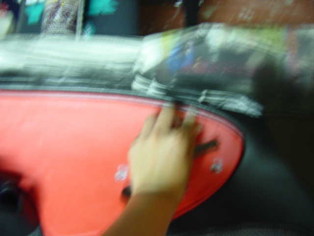

6. Use the stoke fabric as a templete and cut a piece of leather.
The piece of leather will better be 0.5cm larger (over all in term of circonference) than the oem fabric because it will make inserting easier.
So spray the sdhesive at the area where you want the leather piece on. Then put on the leather piece and insert the edge gently to the clivage using your finger.
YOu don't need to worry that there is no glues in the clivage, as long as the leather is nicely glue on the area, its edge will just stay in the clivage because of the flexibility property of leather.

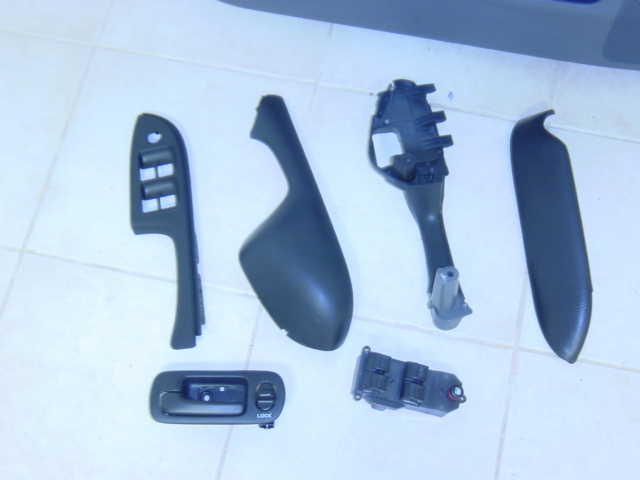

here are some detail pics of how to put back arm rest pieces and a pic of leather VS fabric

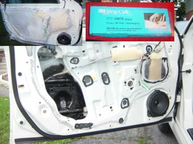

page9
9.
cheap deadening.
just need to cut out some rubber mat and glue on the holes on the door.
use the gum like glue shown on the pic. This is like the factory gummy glue which is used to glue on the OEM white sheet.
the gummy glue is very flexible and sticky, it is alphalt base so it can also absorbe rattles.

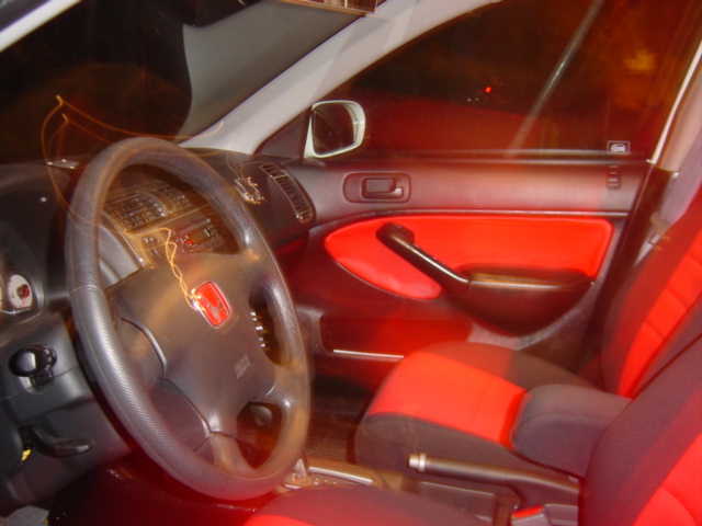

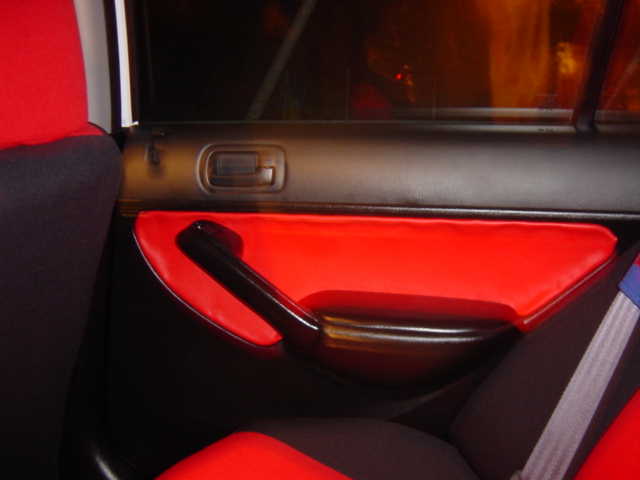

result
result
