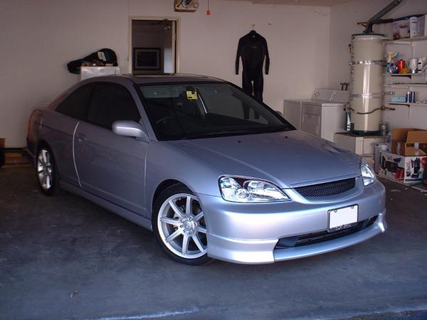

how do i do it? i dont like that big h there with that nasty plastic line through the middle..how can i take that out? i see most of the civics without them on this board and it looks damn clean
i cant find it in DIY
someone please help me
this is what im lookin for it to look like
(picture taken from one of the board in "members rides)

you have to buy an altezza grill from ebay or any other place that sells them. you can try to do a DIY, but ive never seen anyone else try it.
heres how to take it off:
1. read the DIY on how to take the front bumper off (its in the *how to clear out headlights DIY*)
2. look at the back of the bumper and take off 2 screws on both sides of the upper grill
3. under the upper grill you will find 4 plastic screws, unscrew those and pop the pins out.
4. the grill will just slide off (towards the front of the bumper)

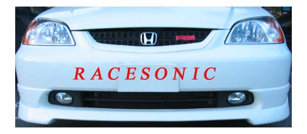

i bought an rs grill from ebay, i have a 2002 coupe. now i see everyone says they dont fit right, and u have to remove the radiator cover.. ok.. i can deal. but the grill is black, and my car is black. no, there is a slight difference, but should i paint it?? i mean i dont think the grill is a "focus" point (i have projector head lights, so that's where the eyes go), but anyway, just wondering what u guys thought.
Old Aug 21, 2003
fine02civicgurl's Avatar
*BoY*CaR* *GiRL*DRivER*
Posts: 1,335
From: home of the sugarbowl Champs
fine02civicgurl is an unknown quantity at this point
this is what it is (this is not my car)
It just doesn't fit the coupe radiator/grill cover. Other than that, it fits. If you have a coupe, you can get the sedan radiator/grill cover [you don't have to have a radiator/grill cover].
As for painting the grill. You don't have to. You can check out YS' ride. He has the altezza grill and left it unpainted. Though it would look better if you get it painted, IMO.
