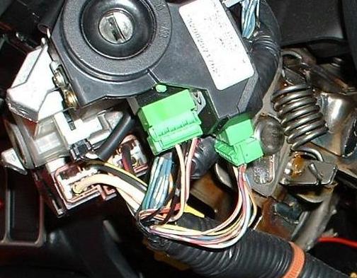

check it out
I installed power windows in my doors a few weeks back. The evil genious SkipBarber walked me through the electricals. The wire I circled here is the constant 12v. I tapped into that, and now I can lower/raise my windows even with the engine off. BEWARE: I drained my battery dead because I kept playing around with my windows after I installed them
the other thinner wire I circled, I thought maybe could have been another power source, but we figured it may be for the Immobilizer system. Good luck!

by the way, the colours may not alway match on our cars. Skip's was black, but my 12v was white. You can tell it by finding the main hose with all the wires inside, and then looking for the green (or black) largest harness, and the 12v should be the thickest gauge wire in it.

thx a lot. that helped..now does anyone know what wire the ignition wire is?

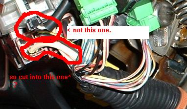

here's an overview to give you a better idea of the area.

i think the black/yellow wire is the ignition wire...i remember a wire like that in my teg that i tapped and a wire wire was the 12v constant like XxSoVeReiGNxX said....any know for sure about the ignition wire?

hey thx a lot. i found the wire i needed, the Vehicle Wiring Database helped me out.

the wire is the ignition(black/yellow) wire under the dash. It becomes grounded when the car is off and un-grounded when the car is on. So my LED's will turn on soon as the car is off and turn the LED's will turn off once the car is started..no switches needed
