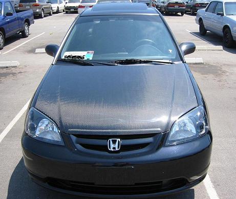

here is a pic of my hood

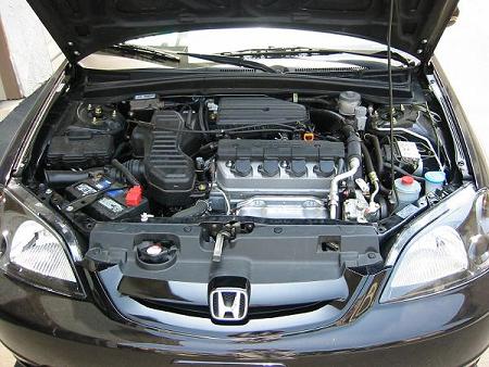

here is a pic under the hood
the installer said that i shouldn't have the hood pins on the corner leveler
instead he is going to put a extender by the silver sticker that he is going to
revet on
how is ur set up working, how do u keep ur hood leveled?
do u use the rubber bumps on the middle of the chassis?
please post a pic how ur set up under the hood
