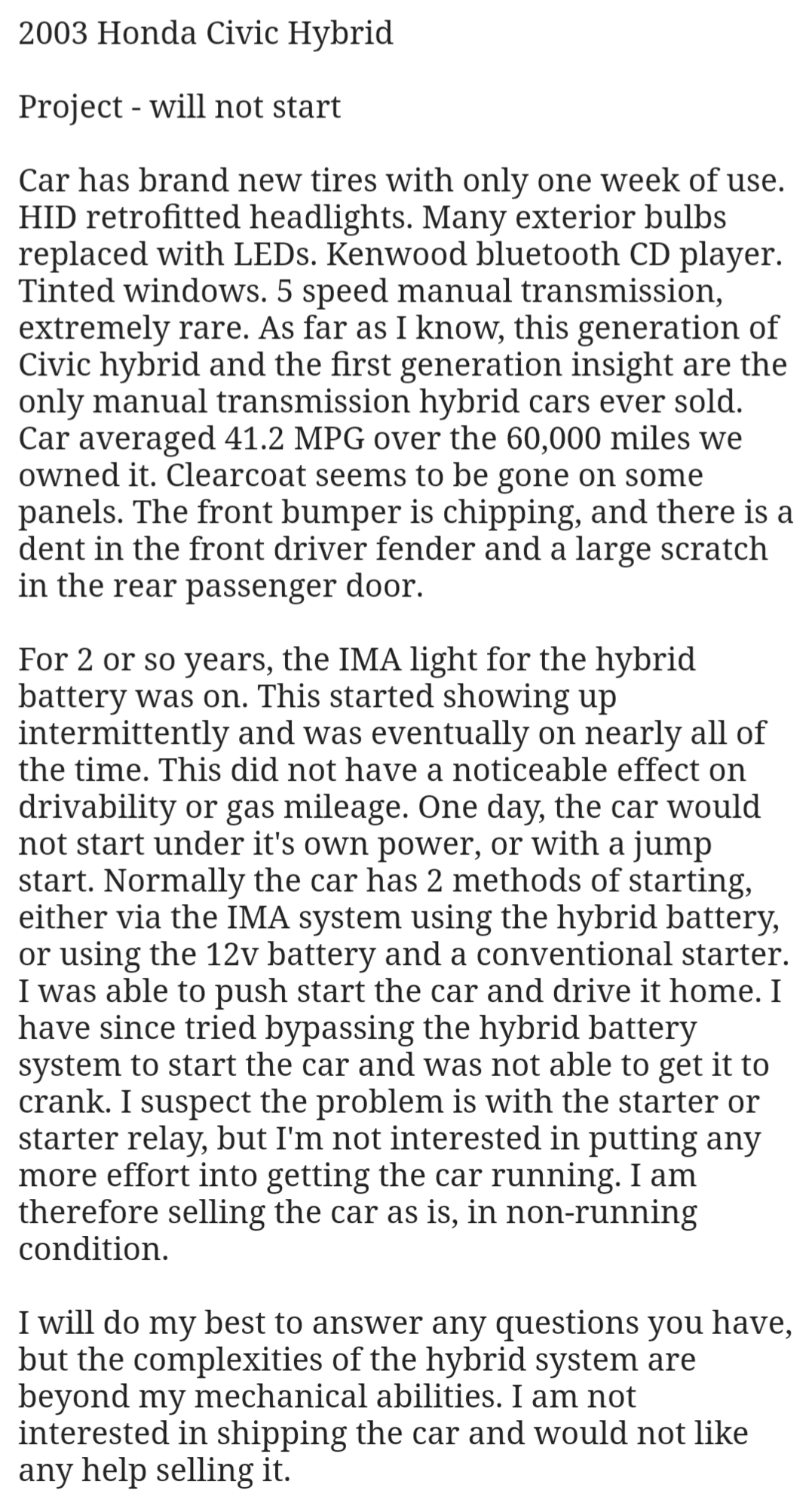

Hello all,
For $500 this evening I purchased a 2003 HCH in non-running condition. I have attached the craigslist post. I revived the vehicle by jumpering the clutch position switch under the dashboard with a paperclip. Since then only the vehicle maintenance light remains lit, and the vehicle has been great getting me and from work tonight, however there seems to be some knocking. Also I believe the battery was completely dead and has not quite fully charge yet, so I haven't really seen the boost function.
I have several questions.
-Is there a negative aspect to leaving the clutch position switch jumpered?
-My hope is that the knocking sound is due to being filled with 87o e10 as confirmed by conversation with the previous owner. Does this sound reasonable? Is it worth seeking out fuel without ethanol or paying for higher octane?
-Are there other common causes of knocking in these engines, that I should investigate?
-Are there other good resources on the net that you fine experts may recommend?
-What attributes should I be monitoring while driving to assess the condition of the battery? I am planning on replacing it soon however the longer I can wait the better.
This is my first unkillable japanese crap-box car and I'm very excited to be going down this path
. Thanks in advance for your help.

Re: 2003 HCH with suspected knock
The symptoms the seller listed are what you see with a worn out hybrid battery. Is the mileage around 100k miles? Happens around then.
The car will continue to run to about 250k miles with a worn out battery (with the IMA and check engine lights on, and the hybrid system much reduced in effectiveness). At that point you'll start to see the red battery light coming on too at idle, indicating the 12v battery isn't getting charged (it is charged from the big battery). However while keeping revs above 2000 rpm, everything will be fine still. Just be careful not to idle for long, and it's fine. You'll probably want to pick a bigger 12v battery too - the battery box is big enough to ~double the size.
If you're keen, you can recondition the hybrid battery. That involves taking it apart, testing each cell individually, and replacing the most worn out sticks with new ones. That typically extends the life by 15,000 miles or so only.
Or you can replace the whole pack, giving you another 100k miles, but that costs ~$3000, so probably isn't worth it.
