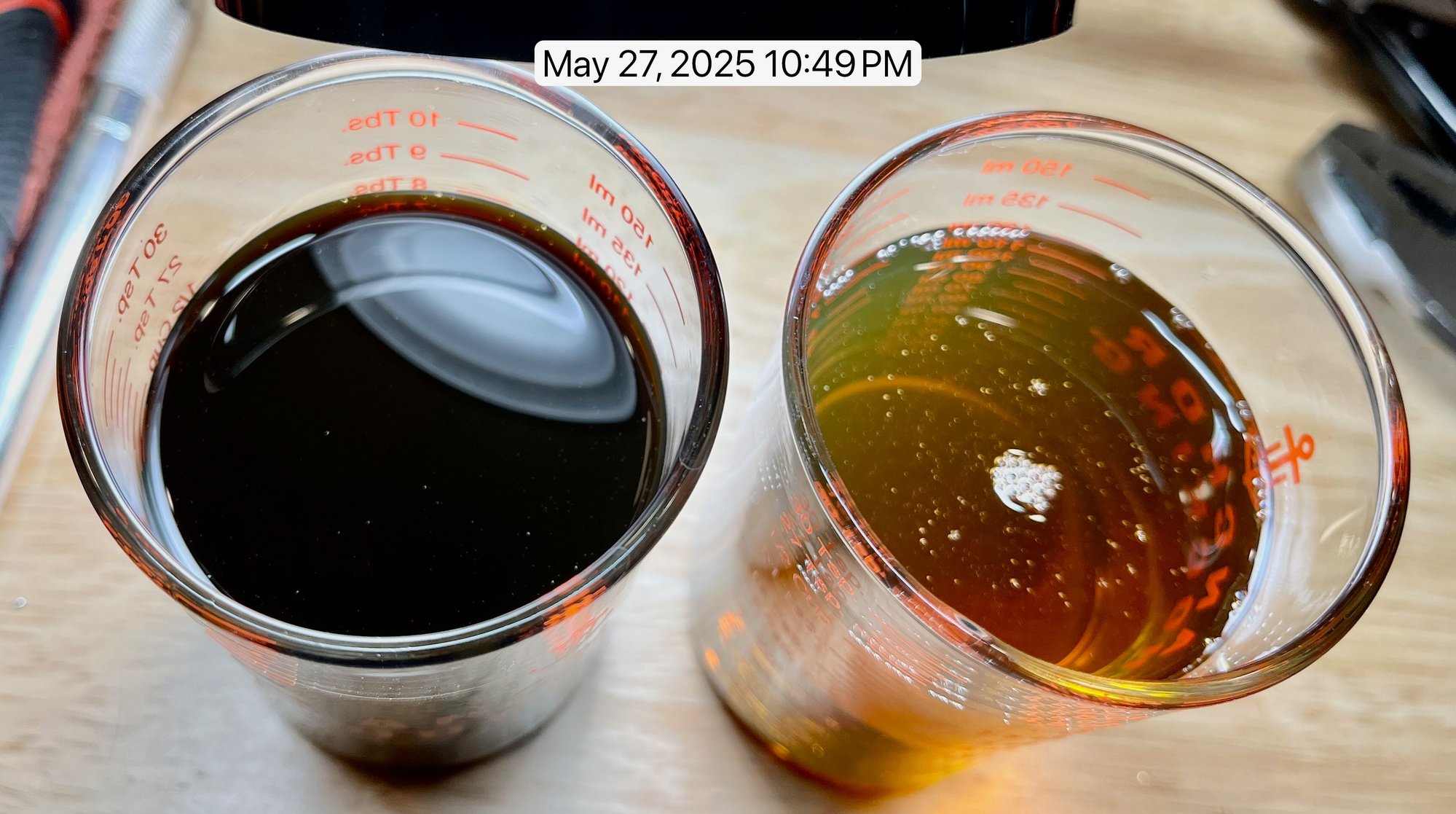

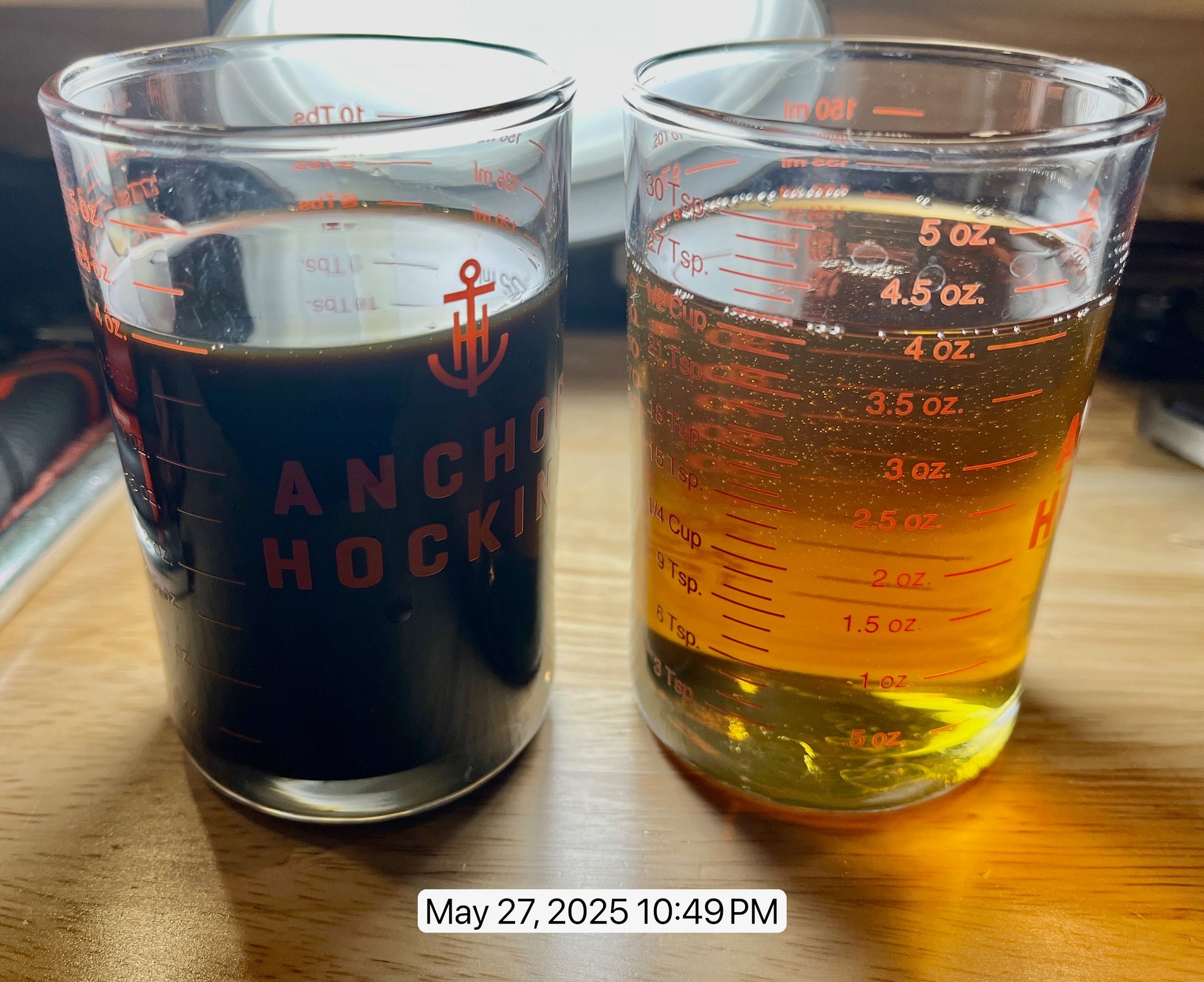

I recently had a local Honda dealer change the oil in my 2007 Honda Civic EX and they overfilled the engine with new Castrol full synthetic oil that I had supplied to them.
Following are PICs of a sample of the excess oil that I siphoned out of my engine (on the left-in the PICs) after only 3 days of driving and 189 miles!
This is compared to new-unused oil (on the right-in the PICs).
The oil I use for this car is Castrol "EDGE ADVANCED FULL SYNTHETIC" SAE 5W-20.
Engine oil drained from '07 Honda Civic (3 days, 189 miles).
Engine oil drained from '07 Honda Civic vs. new oil.
After only 3 days (189 miles) of driving (top view)

Ever done an oil change on a diesel? Black as tar the instant you start the engine.
how many miles on the motor? how often is the oil getting changed?

The car has 180k, that's why the oil looks like that.
could try an engine flush to clean it up a bit
and how often are you changing it?

1 oil change in 32,000 miles? There's your issue.

15k miles is a lot more than I'd be comfortable doing, and I do almost exclusively highway. There's going to be a lot more breakdown than if you changed it even 5k miles sooner. I suspect if you pop the valve cover off, you'll see what I'm referring to.
Oil gets dark from all the carbon buildup and sludge and crap in the engine, which accumulates over time and mileage (regardless of the mileage on the oil). That's what Colin's referring to. Throw in extended oil intervals and it develops into exactly what you're showing us.

You’ve said this already but you don’t really seem to be understanding what we’re explaining to you.
When you run an engine, oil degrades and will leave deposits in the engine. The longer intervals you run your oil, the more deposits are left in the engine. When you drain your oil, it does not drain the engine of all said deposits. A car with high mileage and long maintenance intervals will accumulate dons of deposits and gunk in the engine, so much so that when you add fresh oil, deposits mix into it and show what you have now.
Does that make sense? I understand it’s only been used for 200 miles, but this is the product of deposits and gunk left in the engine.
Unless you never drive in the city ever, 15k miles is too much, even for full synthetic. It’s certainly more than what the filter will be able to handle.
