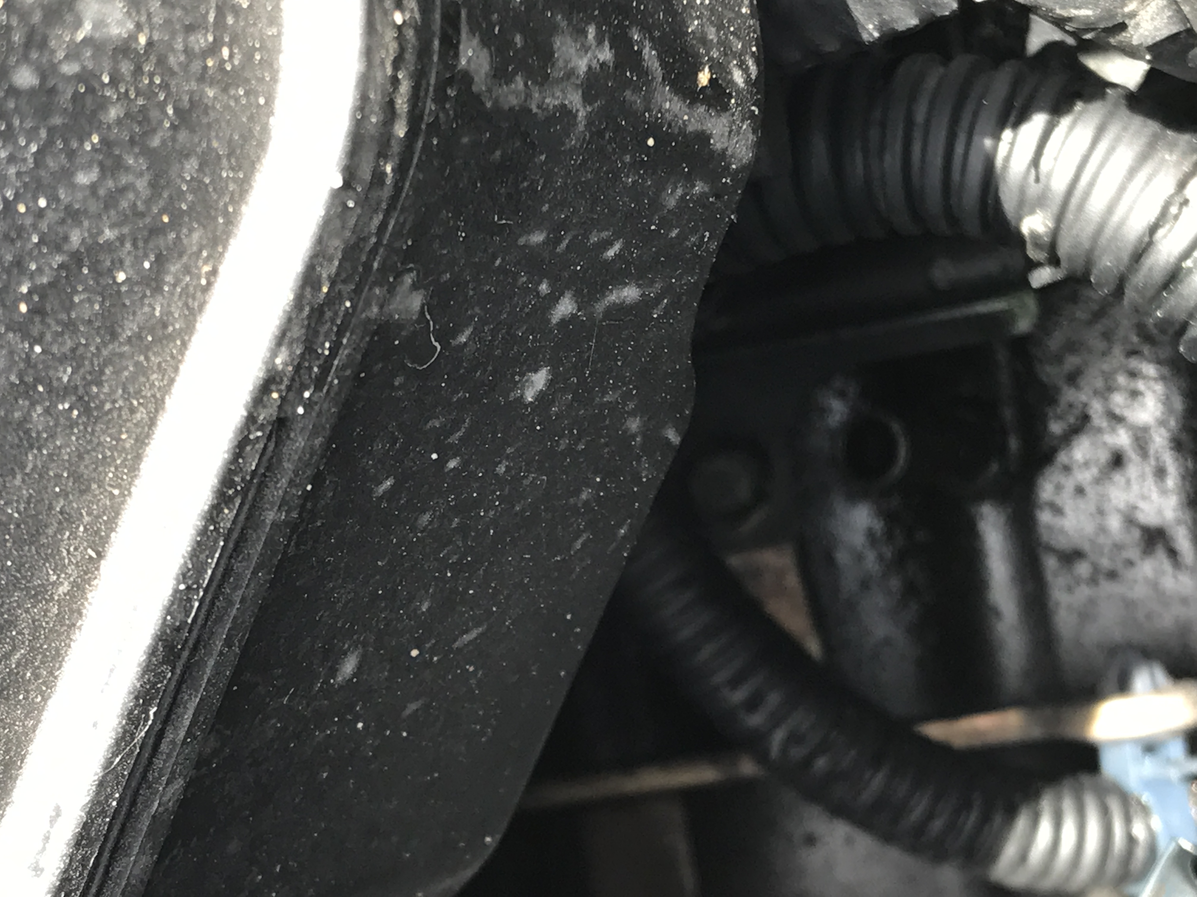

Hey guys ive been searching for what this port is but cant find it! help!!! This is directly under the air box on the passenger front side of the engine

i think thats the vent tube for the tranny, its just supposed to have a vented cap to keep junk out

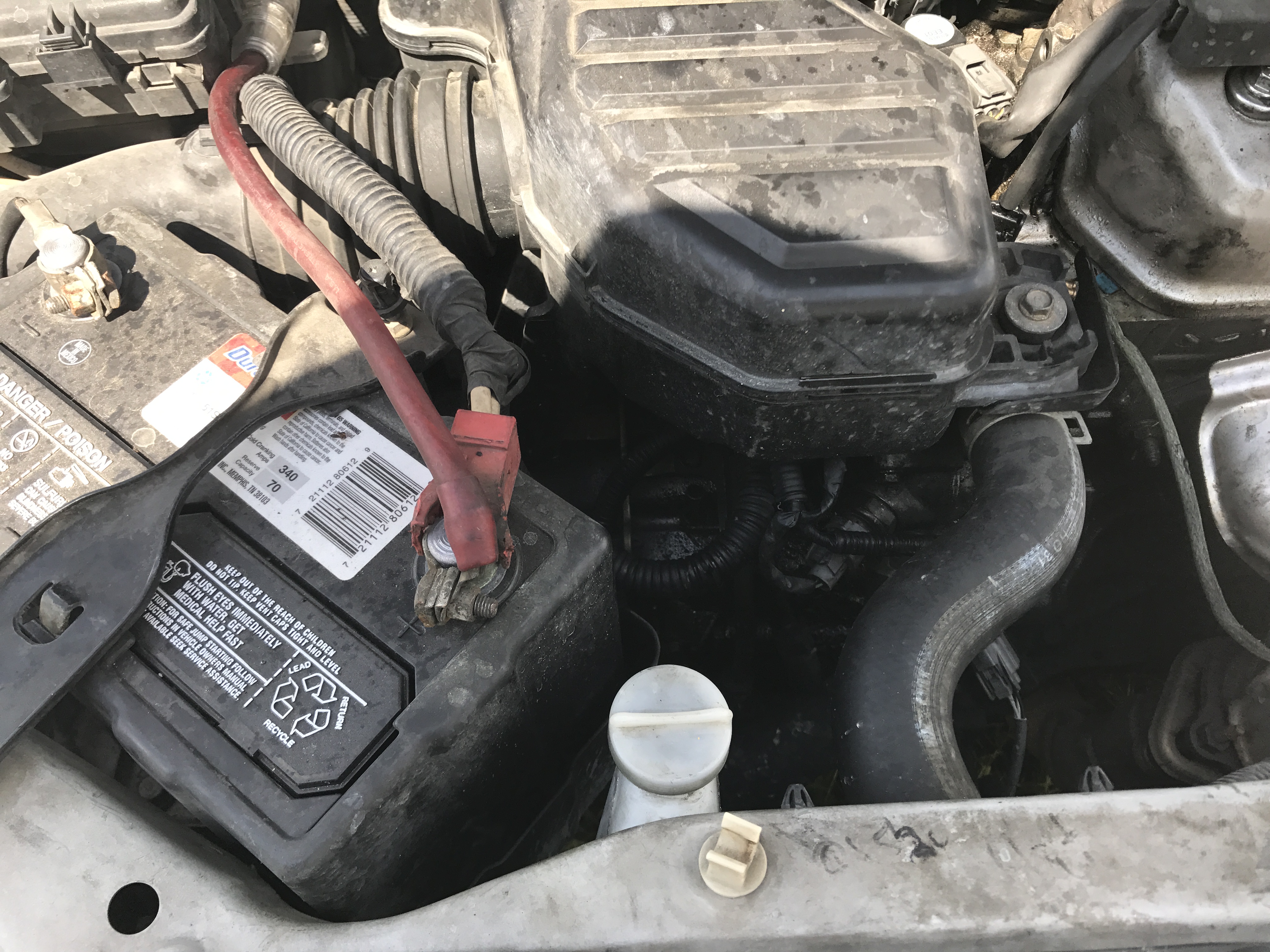

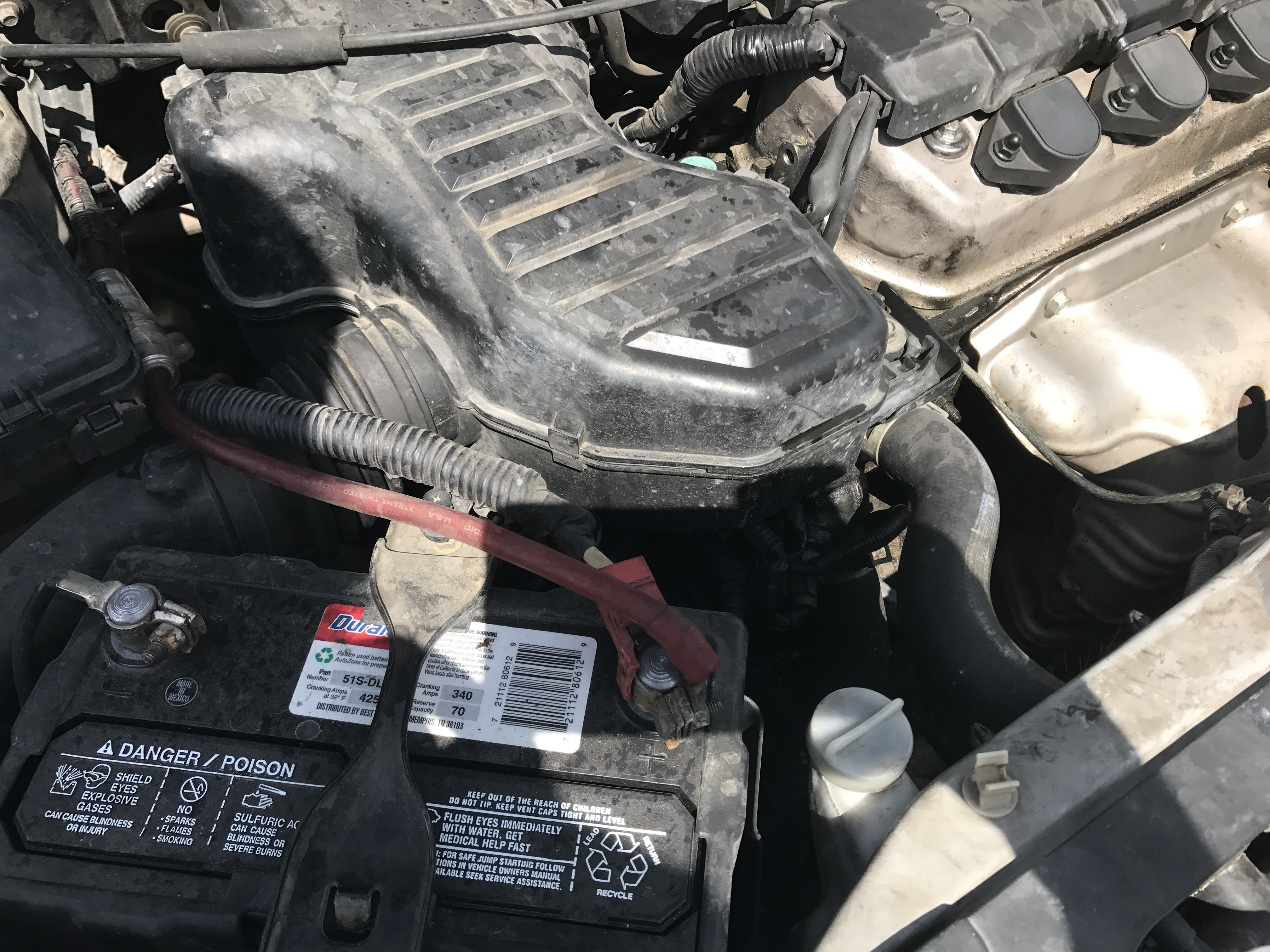

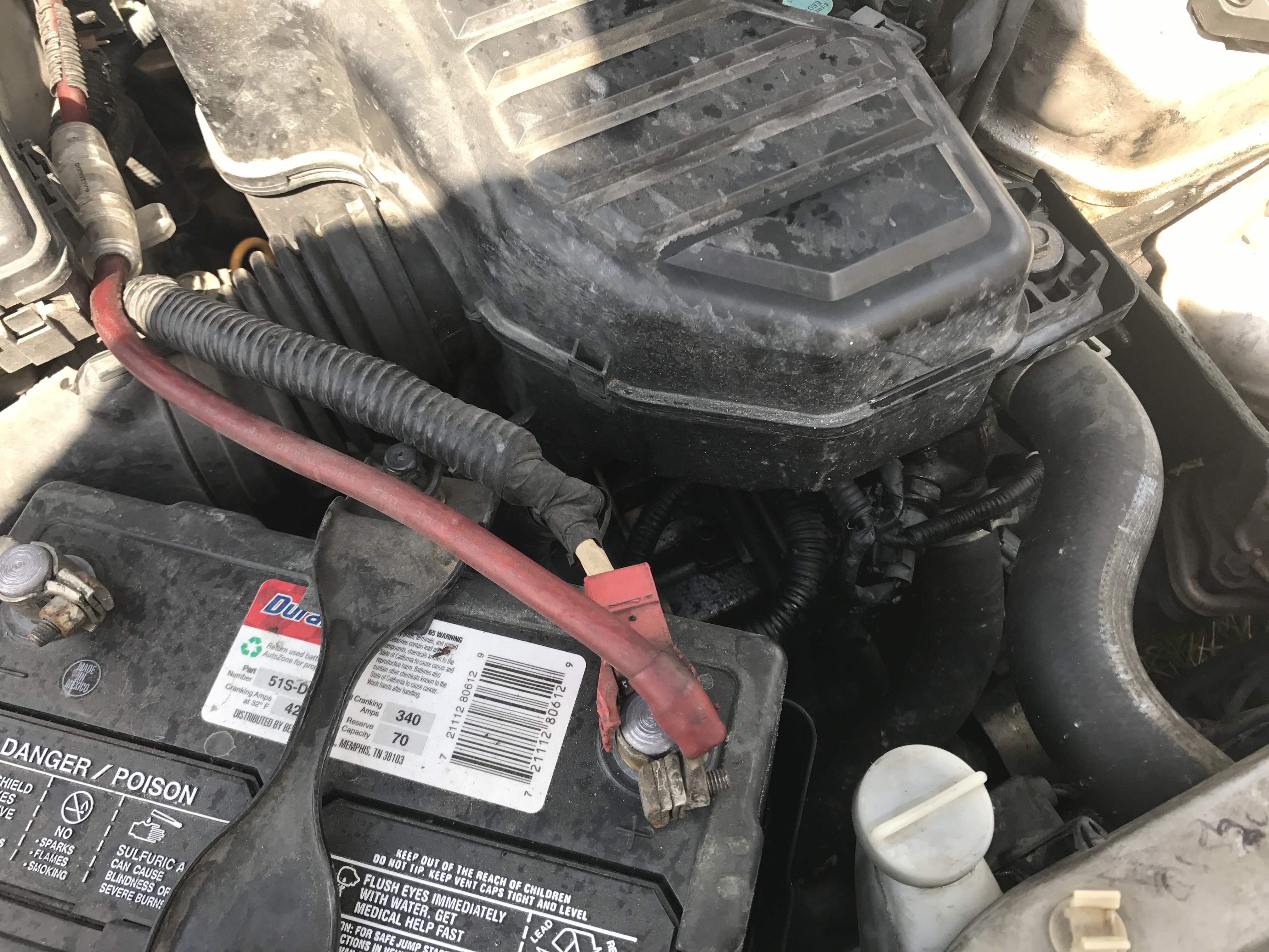

some further photos of where it sits

Breather vent, the vent cap to keep all that dirt out is missing.
Nab one at a salvage yard, or buy one from a dealership
Couple different Honda part numbers were shown, but I kinda suspect either would work
21396-PX5-000
21396-P20-000
Either should be around USD $5
