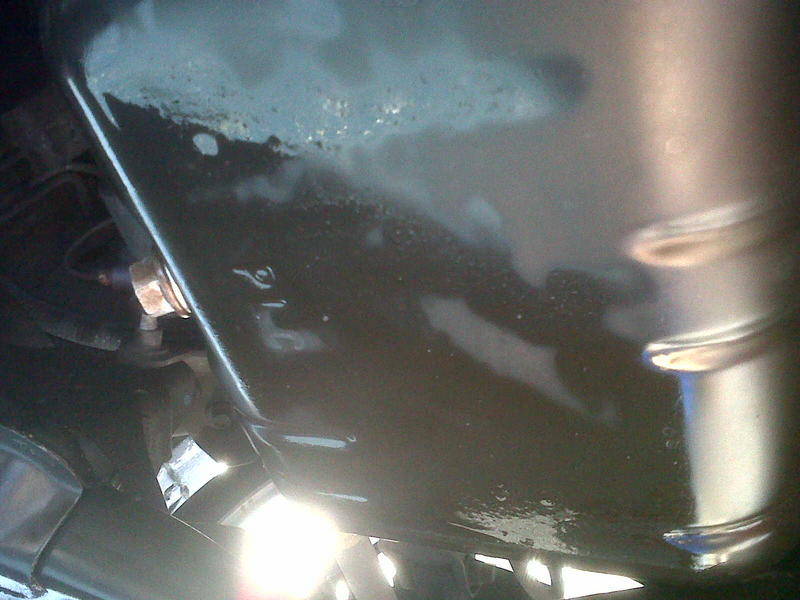

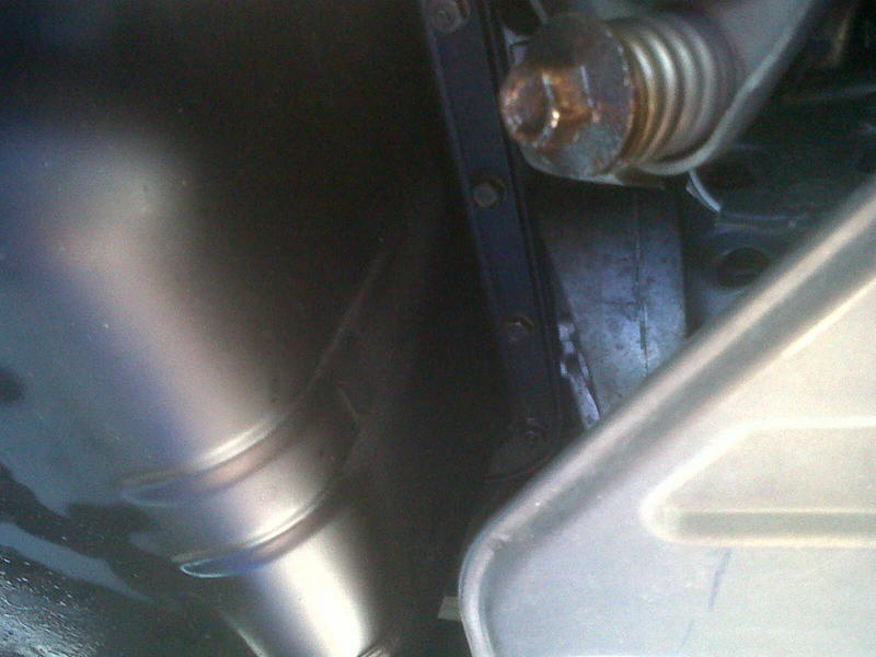

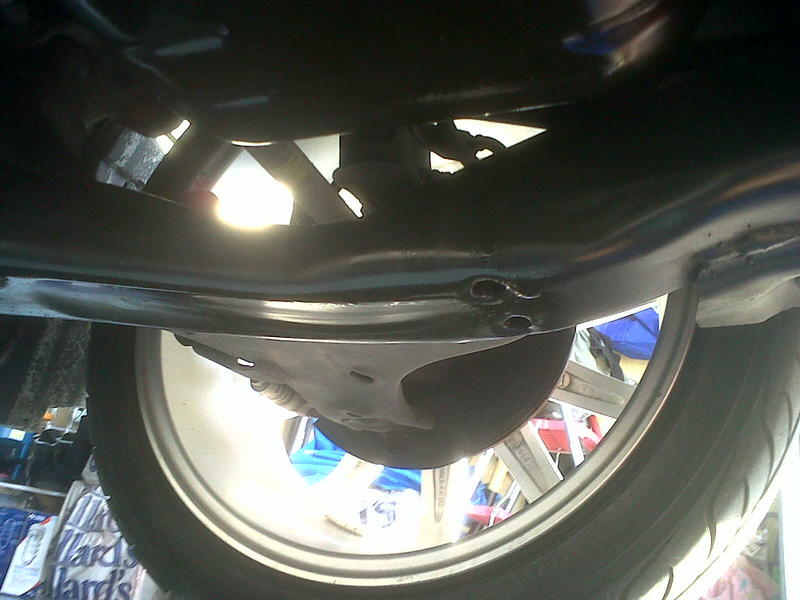

Re: Oil Leak and timing belt
I have several pictures attached.
Will it hurt if I wait like 2-3 months?
Gotta save at least $700-800 for all these work...
I would appreciate any comments and suggestions...
Thanks!
The first and second one are telling. It would be safe to assume it may be an oil pan gasket leak. That being the case, changing one out shouldnt warrant a trip to the stealership....
And you could wait as long as you need too, just make sure to top off the oil regularly, if it is indeed a slow leak.
