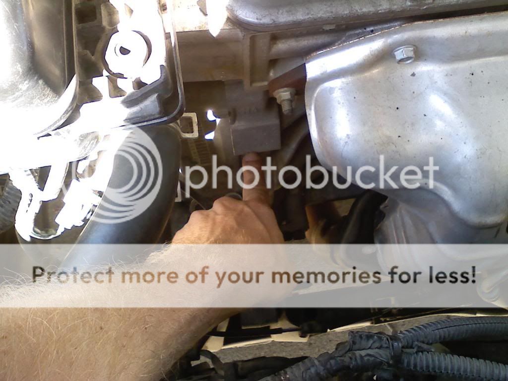

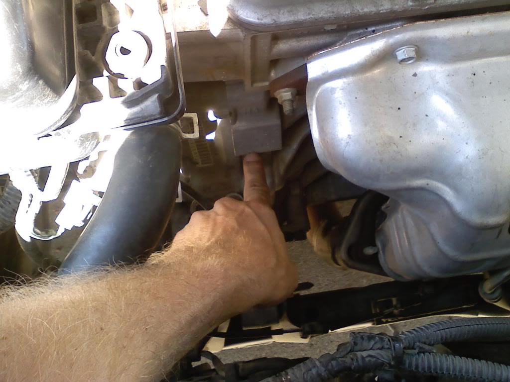

If your belt configuration doesn't look like this then please look at the engine block and tell me what it's stamped with here:
