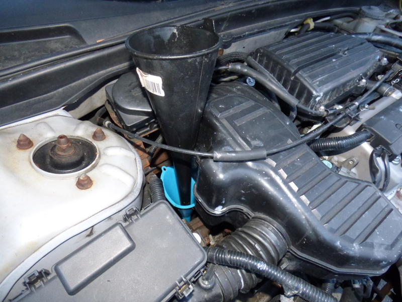

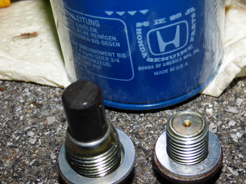

When I found the plug I thought the fluid spatter on the frame as it drained, so I stuffed paper towels above the frame.
It took 3 or 4 good whacks with the sledge to break it loose and the crush washer was pancaked a bit with a bit of a lip on the outside edge.
The fluid still had a bit of a red tint, so maybe it had been drained once before, maybe not. It took 2.9 qts, but I let it drain for an hour while I changed the oil in both
the 02 and the 06.
And I thought I was good with my longneck funnel. What a surprise I got when it wouldn't fit.
I had to grab my smaller long neck, drop that down in the fill hole then put the big long neck inside the small one.
geez, what next....
Thanks again for the help.
