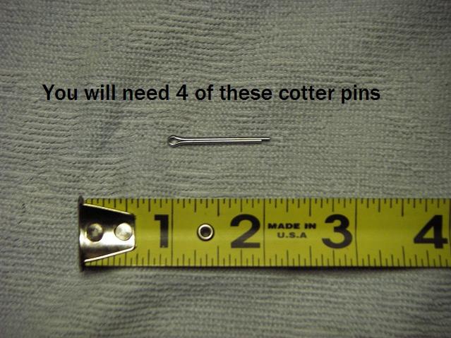

-Part no. 94201-20220 split Pin ( better known as a cotter pin)

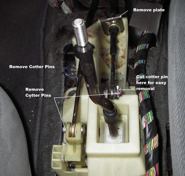

10. Pull the plate that secures the right shifter cable using the adjustable pliers.
11. Remove the cotter pins that secure the ends of the shifter cable.
12. Free the left shifter cable by turning counterclockwise until you can pull it outClick image for larger version

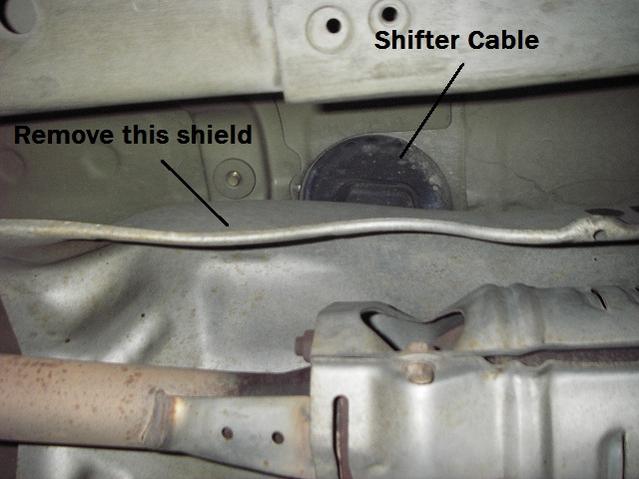

14. Remove the heat shield that surrounds the Catalytic Convertor Using a 10mm socket. This will expose the rubber cover where the shifter cable enters through the inside.
15. Remove the two brackets that hold the shifter cable using a 10mm socket
16. Detach the rubber cover where the shifter cable enters the car.

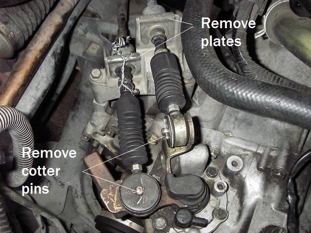

17. Remove the cotter pins and the plates that hold the shifter cable in place. Use the adjustable pliers to remove the plates. Pull toward you then upward.

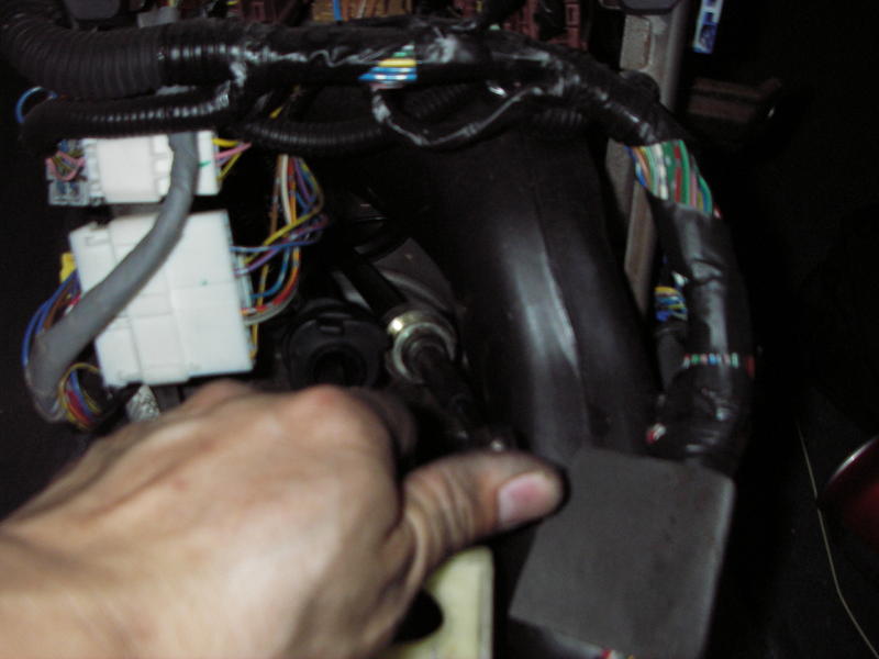

18. From the Inside, position the cables so that they can exit through the opening in the hole.

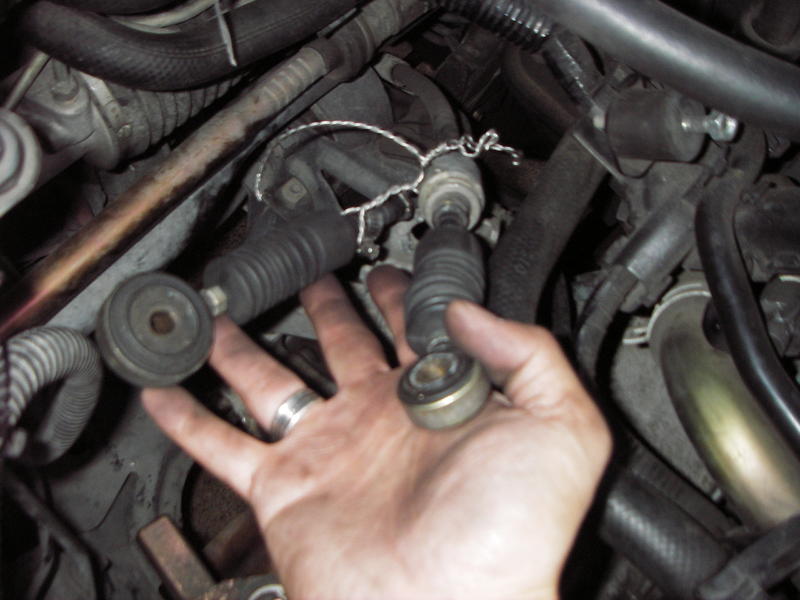

19. From the hood, position the cables so that when you pull from underneath, they can be maneuvered through the back side of the engine bay and below.
20. From underneath, Carefully maneuver the shifter cable by pulling the cable forward.
