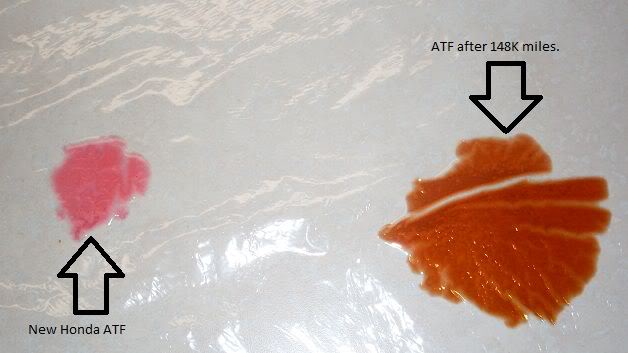

I'm not sure how it looks now, I can check after work. What color should it be? What should I look for?

Pull the dipstick and let the fluid drip off onto a piece of paper towel, refer to picture below to compare completely spent to fresh atf.

if you have an empty oil bottle with gradations (the big 2.5L bottle), you can pour the atf in there to see how much was drained out, then put that much back in. mindbomber that atf looks really good for its age. mine was dark black at 18k miles lol.
Wow you went 148miles on 1 ATF change? Im surised yours isnt black. I change mine every year as well as the ext OEM filter but because i just changed mine after just 4 months and noticed a noticably darker ATF than new I might do it every 6 months and the filter every year.
