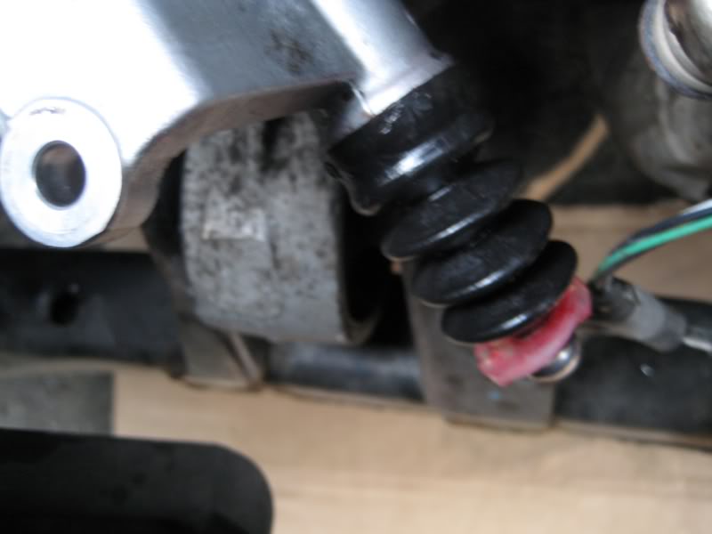

At first I thought I just had the inside pedal noise. I used the white lithium grease I found at the parts store. I took off the plastic pieces by the pedals and got down there with the flash light like a contortionist and looked at where the clutch connection goes into the firewall. When you press the pedal about half way you notice the opening get a little larger. So I wedged the flash light under the floor mat to free up both hands. Then I pressed the pedal down and put the straw of the grease into the hole and gave it a good spray. The pedal noise was gone.
That's when I realized that I had the noise in the engine bay as well. So I started looking at that. I wasn't sure how it worked and ended up taking it apart. I started by shooting some grease randomly behind the boot, but when I checked it, it still made noise. So I decided to take it loose. I realized once I got it apart I was shooting the grease at the wrong spot. Now that I understand how that joint works I don't think I'll have to remove it next time. You have to shoot the grease toward the passenger side around the ball. If you are like me it's one of those things that may not understand until you take it off. It wasn't hard, I had no problems with the pedal going to the floor, I assume as long as you put it together correctly it'll all be just fine.
As someone said all you do is remove the two 12mm bolts that hold the slave cylinder on. Once the bolts are off the assembly more or less falls apart in your hands. Take note as it's coming apart so you know how it goes back on. It's not hard at all. The ball goes toward the passenger side, the shaft to the drivers side. I sprayed the ball down and the fork it goes into. I put it all back together and the noise is gone! Yes!
Again, now that I know how it works, if I have to do this again I might be able to do it without taking it apart, but it's certainly worth it to get rid of that annoying noise.

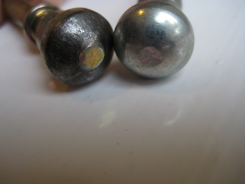

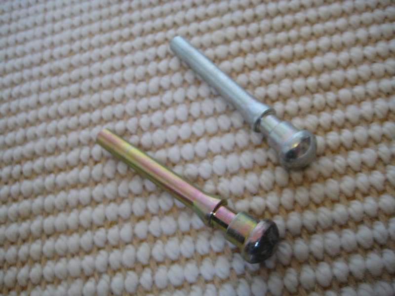

I've recently bought an 03 Civic 1.4 si at auction, will be sorting out a few niggles before putting it on the road. Anyway this guide was very helpful finding the source of the clutch squeak - when I packed the slave cylinder push rod socket with grease, there was silence for 5-6 pedal presses.
I figure the push rod ball end is too worn for greasing to be a long lasting fix, and got a new one today from the local Honda dealership (part number 46948S5A003, £7.87 + massive VAT).
I'm not fitting it till the rain stops, hopefully on the weekend.
One thing I notice is that the old push rod seems to have been plated with something like brass - possibly to cut down on noise, before it wore away? - whereas the new one is unplated.
Old push rod:
[IMG]
[/IMG]
Old versus new, goldy one is the old push rod:
Comparison of the ball ends:

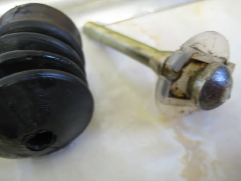

Bit of sun today. I cleaned everything up, fitted the new push rod, regreased with Castrol red brake grease, and... no squeaks! Let's hope it lasts.

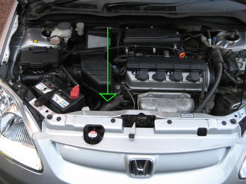

Rockstar18729, I took some photos to show where everything is. Bear in mind this is a Brit car, yours may be different. Hope it helps.
First off, this is the worn push rod, with plastic thing and rubber gaiter as it came off the car:
With the bonnet open, the area to look for is between the exhaust headers and the battery:

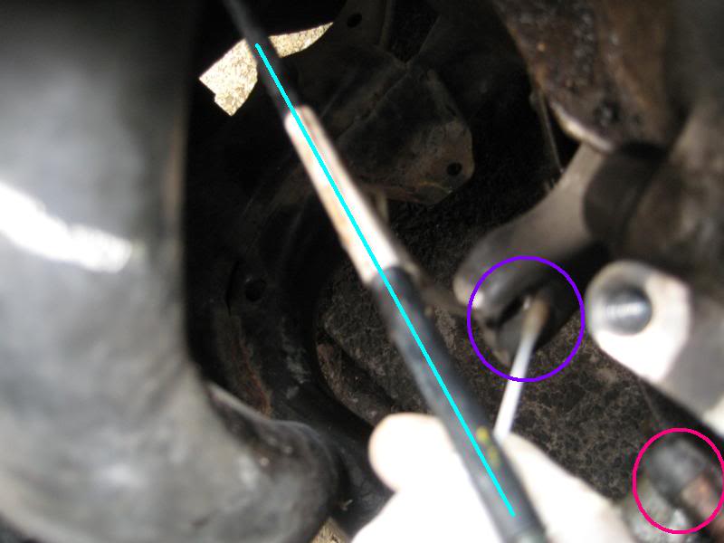

Closer in still, here is the hydraulic pipe (highlighted in blue) that leads into the slave cylinder, the slave cylinder's bleed nipple (pink), the bolts you have to unscrew to free the slave cylinder (brown - one hidden behind an electrical connection) and the rotating nut (green) that you will spin the slave cylinder around to get the push rod out.
When you've disconnected the electrical wires as described in the op's guide,unscrew the bolts (brown) reach your hand into the rubber boot and disconnect the push rod from its fork by rotating the slave cylinder around the nut (green). This way, the rigid hydraulic pipe (purple) isn't bent or stressed. In the photo below, I've removed the rubber boot and spun the slave cylinder away from the fork by 180 degrees, to ease clean out old grease and dirt from the fork, and pulling out the worn push rod.
Cleaning up the fork (purple) with brake cleaner, rigid hydraulic line highlighted in blue for some reason:
New push rod lightly greased (I filled the fork cavity with grease), gaitered, and put in place on the slave cylinder:
To reassemble, I rubbed grease into the rubber boot, swung the slave cylinder back around towards the fork, pushed the big rubber boot over the push rod's rubber gaiter, clicked the push rod into the fork, and eased the rubber gaiter into its cavity. I needed an extra pair of hands to photograph all that, so I'm afraid there's no pics. I didn't need to jack the car up.
