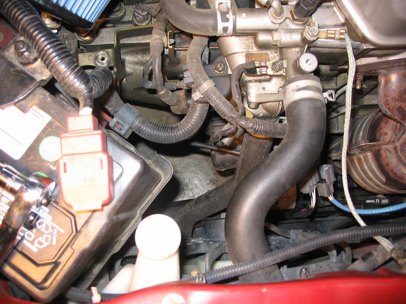

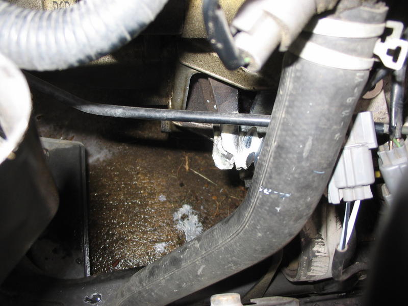

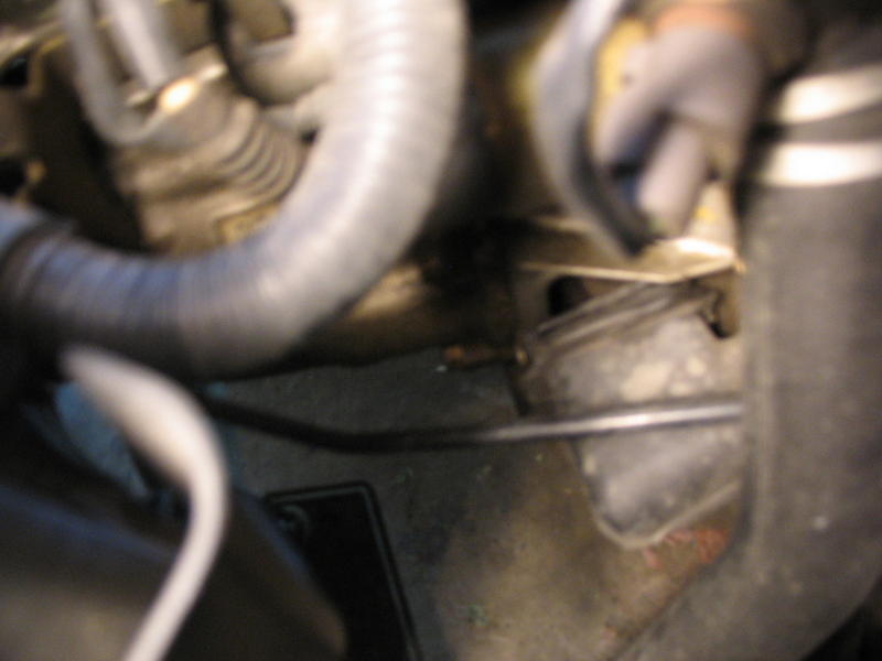

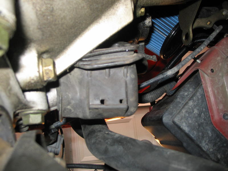

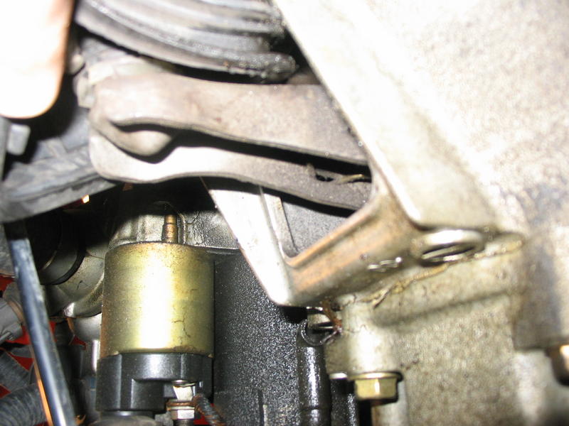

ok i just did this today and took pics for everyone to enjoy...
first you're going to want to unhook your 02 sensor wires from their mount (this was done on a dx but i believe the ex wires connect at the same bracket)
next you're going to unbolt that bracket and the bolt next to it, these are what hold the clutch piston to the block.
look at pics 1-3 for a good look at where the black cover is the piston is right next to it i just didn't take a pic of it... picture 3 is from under the car. jacking the car up is not necessary but it made it a lot easier to get the under side all lubed up imo...
next pull off the black dust cover and you should see this... (see pic 4) pic 4 is also from under the car
now just use as much white lithium grease as possible... i actually did it once form top once from bottom then bolted it back together and pumped the clutch a few dozen times and then did it from the top again... pic 5 is how it looked after i lubed it all up
when i unbolted the piston i actually pulled the rod out away from where it contacts the shift fork... and it came out of it's boot and i thought i screwed it up but it actually just sits in there... so i sprayed the top of it and where it sits on the shift fork before reassembling it all...
and reassembling is the hardest part because you have to get that rod to sit in the piston and on the shift fork with the black dust cover on it and keep it there while you thread the bolts in...
but it was totally worth it... no more annoying squeaking!!!
p.s. i also sprayed some of the grease on the rod where the clutch pedal goes into the master cylinder from inside the car because that is a typical spot for squeaking as well as the joint for the pedal.
i hope i covered everything please ask me any questions if i forgot something...

If the squeak sounds like it is in the interior of the car when you step on the clutch, then you need to spray the lubricant in the hole.
If the squeak originates from under the hood, locate the clutch slave cylinder. To the left of it is a rubber dust cover (if you are looking down at the engine bay). Take it off and saturate where the clutch release fork meets the clutch slave cylinder.
1=Dust boot 2=Clutch slave cylinder

Hope that helps with the under hood squeak. Don't have enough time to post interior clutch squeak. Maybe later.
