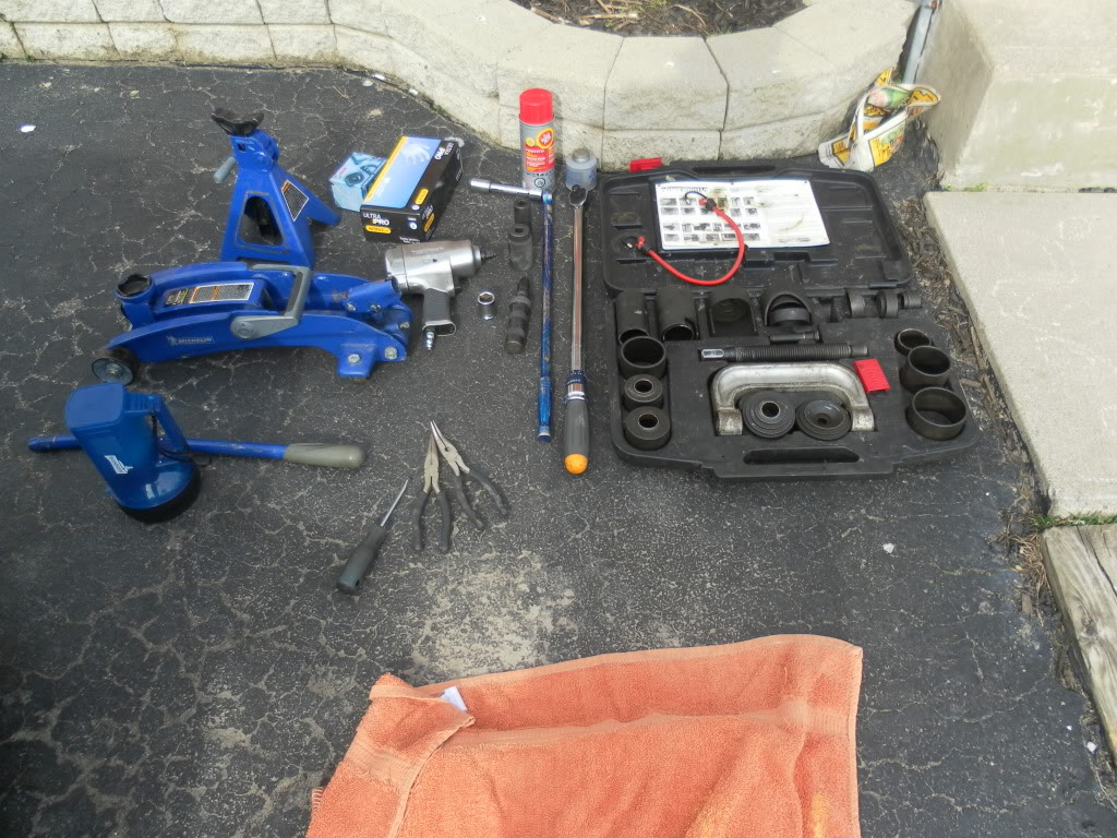

This is what your going to want to have when you start the job:
A new ball joint
A hydraulic jack
JACKSTANDS, USE THEM
A ratchet set including 10mm, 17mm, 19mm, and 22mm ratchets.
An axle nut impact socket
A good 3' breaker bar helps A LOT
A torque wrench
Some extensions will be necessary for your ratchets.
A 22mm impact socket for use with the ball joint press tool
A hammer
A good set of needlenose pliers, mine had a nice bend in them.
A flathead screwdriver
A bungeeee cord
Anti seize paste
An impact gun helps but is not necessary, obviously a compressor too.
2 Brand Spankin' New Axle Nuts
latex gloves help keep your hands clean.
Here is what I had on hand:
Most importantly: A Ball joint press tool I'm showing this twice because you NEED it if your doing this at home.

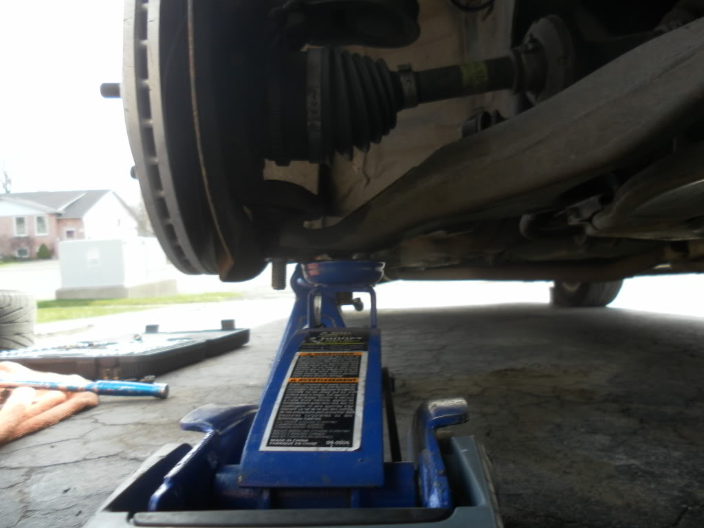

2. Great, now put the wheel back on the car and just snug up the lug nuts. Put the car back on the ground and grab your breaker bar, an extension, and the massive axle nut socket. Get that baby in there and break the 134 ft/lbs of seized on torque off the nut free. If you can't get the nut free this way, you will need an impact gun. Here is what the socket looks like passing through the rim:

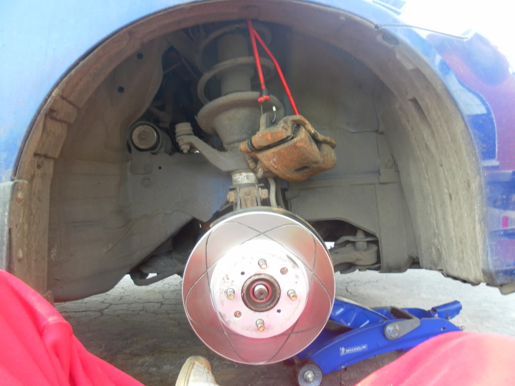

3. Great, now take your stupid wheel back off the stupid car ( a bit repetative I know, if you have access to air tools you can remove the axle nut with the wheel off to begin with which makes it a lot easier. ) After the wheel is removed take these two 17mm bolts off of the caliper, and hang it up out of the way all nice like. DO NOT REMOVE THE BRAKE LINE BOLT!!!:

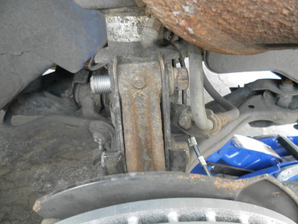

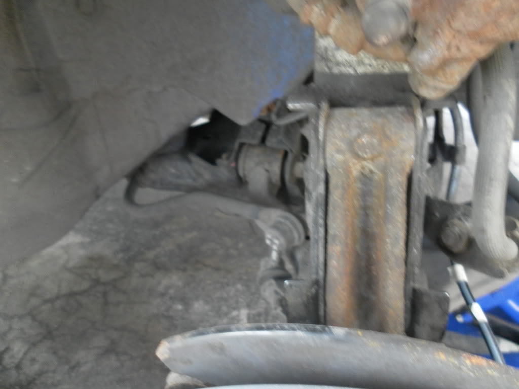

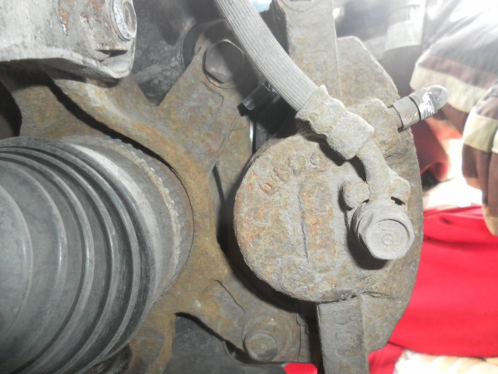

4. Now, remove the two 22mm nuts off the strut assembly, these are attached at 71ft/lbs and are probably seized a bit so it might be a bit of a battle to get them out. LEAVE the bolts on, you will need them there to break the balljoint free from the lower control arm:

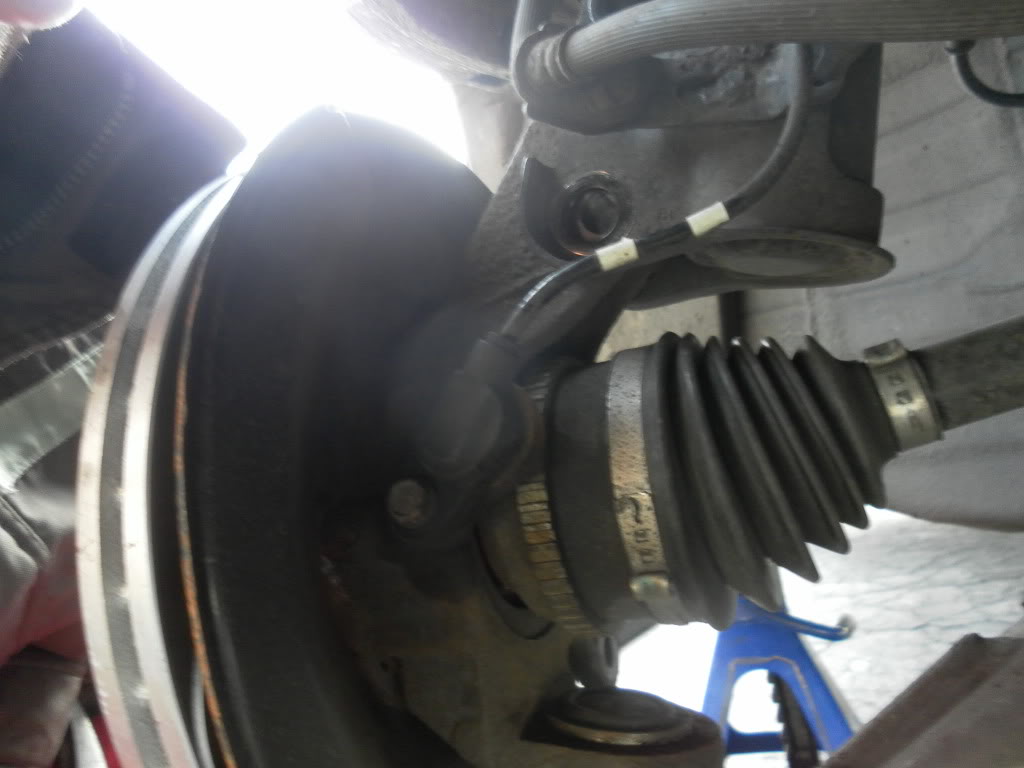

5. Now your well on your way, and it's time to remove the vehicle speed sensor. This was a ROYAL bitch because I was terrified to destroy the sensor and it was seized in. Remove the 10mm bolt, then I ended up having to get a pair of vice grips and attached them tightly to the sensor. Then I slowly started to spin the sensor until it came free. DO NOT disconnect the sensor connector, remove the entire sensor as a whole

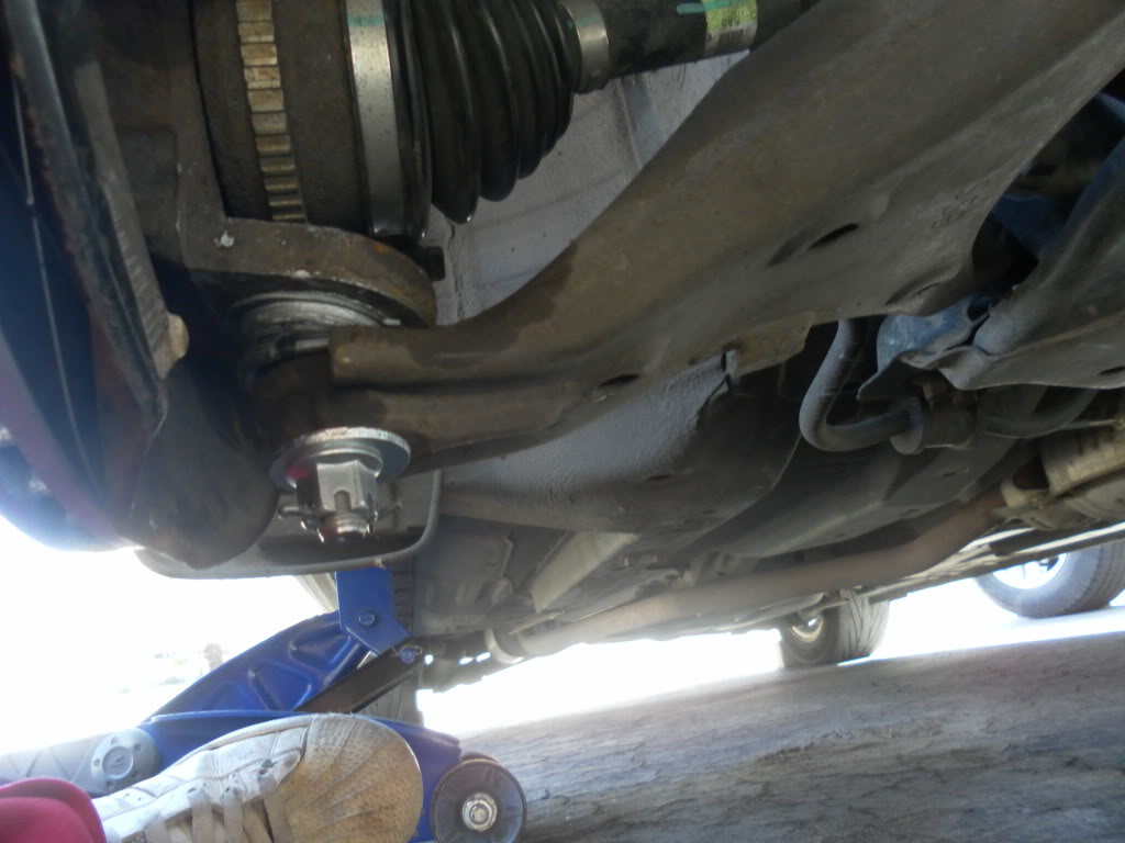

7. Now its time to break the balljoint free from the lower control arm. There is a very simple method to doing this that will save you LOTS of time if you do it this way. It involves your hydraulic jack and a ratchet. What you do is jack up the lower control arm until you can fit a ratchet between the knuckle and arm itself:
8. Fit the ratchet inbetween the LCA and knuckle.

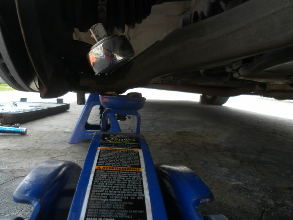

9. After its in place, simply lower the jack all the way down and you will hear a "POP" sound. If you look the ball joint should be seperated from the control arm:
10. Now you can use a hammer to drive the axle (spindle) back into the knuckle, you can use a regular hammer as long as you don't smash on it. You really shouldn't have to hit it very hard. If you cant get the axle fully out from behind you can get it when you remove the last two bolts off the knuckle.

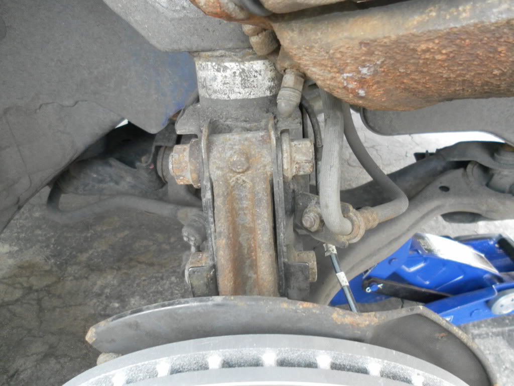

11. Great, the hard part is done, now you can remove the two bolts from the strut assembly. Sorry this picture is a little bit fuzzy but its basically the two bolts that you removed the nuts from earlier. You can tap them with a hammer to get them out. Just don't go buck wild and mess up your threads.

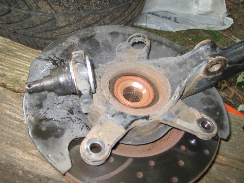

12. The knuckle will want to come out easilly, but you might have to hammer the lower ball joint upwards a little bit to actually remove it from the car. This is where a second person comes in handy, but it can be done by one person. So your kinda doing three things at once here, making sure the axle is fully clear of the knuckle, making sure the balljoint is coming out of the lower control arm nicely, and balancing the knuckle to make sure when it comes free you don't drop it. Great, now the knuickle should be out of the car.
13. Hold the knuckle in your hand with a smile. If you can accomplish this you can do most suspension work on the front end of a honda civic yourself. Anyway... here it is:

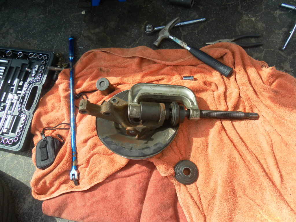

14. Now to press the ball joint out with your fancy *** tool. This is where an impact comes in VERY handy but you can do it with a ratchet. You look at the tool and it looks pretty confusing. Luckilly, you only need a few of the pieces that come with the tool. You have to make sure you select an adapter that will allow the ball joint to "Push" out and an adapter does not sit flat up against the knuckle, it should actually sit up against the flat piece on the bolt of the ball joint. It's very hard to explain but hopefully you get it. It should look like this to remove the ball joint:
15. I cheated and used my impact even though this is an air tool free guide, but I have done it with a ratchet, as you can tell I'm messy as hell:
16. You should have no problem pressing the ball joint out with this method, it might take a little bit of time and a little bit of muscle. A vice would help a lot to keep things stable if your not using air. Pressing in the ball joint is pretty much the exact opposite, just make sure you put a **** ton of anti seize paste on the knuckle where the ball joint will seat. The push side has to be up against the flat part of the ball joint. You can actually attach the C clamp right to the ball joint, it fits well. Make sure you select an adapter on the bolt side that allows the joint to slide through fully. You know the ball joint is fully seated when it sits flush up against the knuckle. Some aftermarket joints like the one I got come with rings, you have to insert the rings into the groove on the ball joint on the bolt side. Use the two little holes and insert a pair of needle nose pliers into them, then spread the rings apart and fit it into the groove. It's a royal pain in the *** and it's nice to have two people for this. It's doable by yourself It should look something like this when you are finished pressing it in:

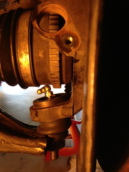

17. I forgot to take a picture of the ball joint installed on the knuckle so I stole one from the other DIY guide, sorry greeen01civic4d

21. Now to reinstall the caliper. Just carefully slide the caliper onto the rotor and install (after anti seizing) the two 17mm bolts on the back and torque them to 80ft/lbs.

Make sure you have the two strut bolts in place when you are doing it. I spent a lot of time on the first one only to realize that it won't work without the strut bolts there. If that doesn't work you need to use the puller.
SO.. Make sure these two are still in:
And the ratchet is like this:
Drop the suspension down. Sometimes you may have to put your foor ontop of the rotor and push down with some force to break it free. You need to jack up the LCA to get the ratchet in there. And release the jack at full speed to make sure you have the most ball joint release force you can.

Help!
Hey all,
Took on this job thanks to the great write up!
Bought a couple of Moog K90332 ball joint, which appear to be correct for the 2002 Honda Civic EX 4dr that I have. Even spoke to Federal Mobile several times about it and they said it was right. They are the manufacturer of Moog parts.
Anyway, Moog parts come with a zerk grease joint (90 degree) and I pre-installed it before attaching the knuckle. When I tried to put the knuckle back in the zerk joint hits the CV boot and won't go in. So I removed the zerk joint and got the axle back through the hub, but seems there is no way to get the zerk joint installed. Even if I went with a smaller (non 90 degree) zerk, there would be no way to grease it, and the ball joint is not pre-greased.
Anyone else had this problem? At this point, I don't think this ball joint is compatible with the 7th gen (or at least my 2002) civic.
I have attached a pic that shows the axle installed all the way, the ball joint castle nut has not been secured, but the joint is fully inserted. The knuckle has not yet been reattached to the strut assembly, but I don't think that is going to change anything either. The zerk fitting is just resting on top of where it should be installed.
Thoughts?
-- Peter
