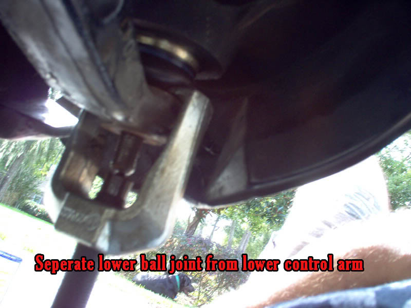

now BREAK the ball joint.
there is a few ways u can do this:
1. go to autozone and RENT (free) a ball joint separator. this is the best and easiest way.
http://www.autozone.com:80/autozone/...uestid=4135097
here is how it looks like in action: (borrowed form hond@tech thread)

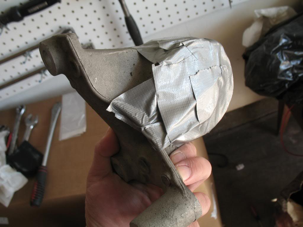

prep the LCA.
tape the bottom of the broken bushing.
make sure the center cylinder is CENTER

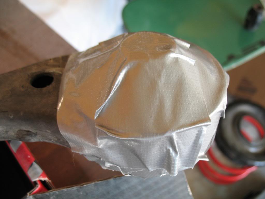

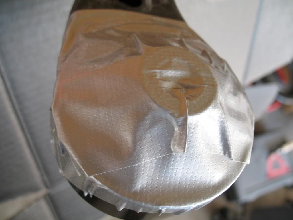

press on the bottom so polyurethane wont fill the cylinder
i also cut a piece of the lower part of the cup, and build a little wall around the TOP of the bushing mount area. that way, you can fill the polyurethane almost to the top.
then saran wrap the bottom with some more ductape and more tape. MAKE SURE U TAPE IT WELL SO IT DOESNT LEAK. u will be sorry and make a big mess if it leaks.

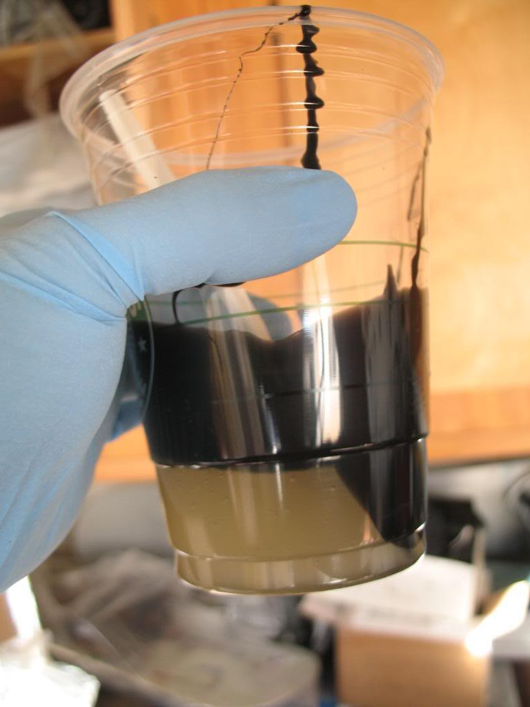

you want to mix it in a plastic container....not paper, wood...etc again read instructions that came with it.
i work at starbucks so i get unlimited cups.
i poured and measure it
mix it for 1-2 FULL MIN.

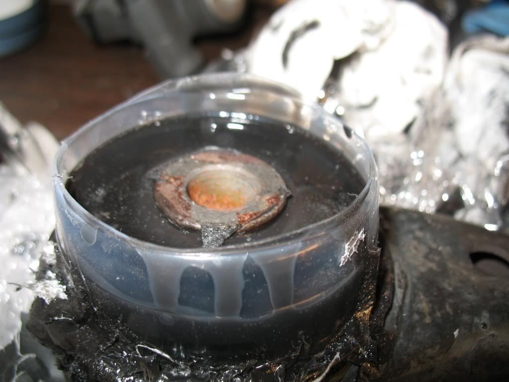

pour it in.
you will notice i put a piece of tape on the top of the metal cylinder thing. thats to prevent the polyurethane to come in and ill the hole. we dont want that.

so put the center back in, make sure its centered and tape the bottom
REMEMBER TO TAPE IT WELL and remember to also use SARAN WRAP after the tape.....and some more tape.
