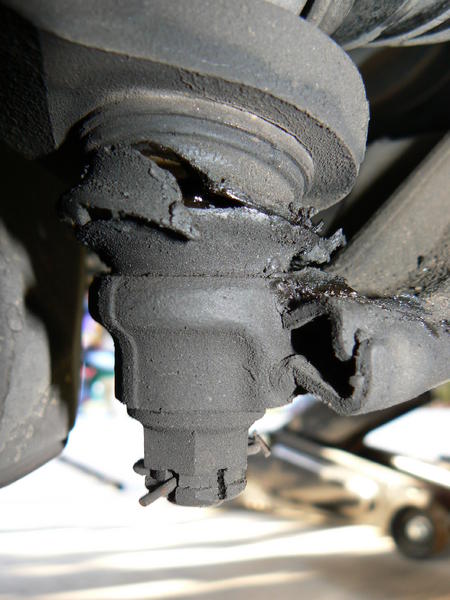

at 285,826 miles on my 01 civic. I started noticing some noise (klunking sound) on the passenger side when I go over the imperfection on the roads. I decided to do my front pads and noticed this. This is the first time I am changing them.
Problem is the pic of the ball joint is on the driver side.

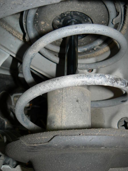

The only thing I noticed on the passenger side was the strut boot sitting in there inside the spring.

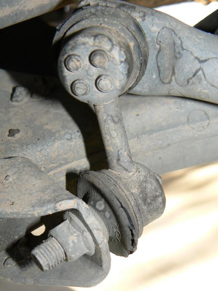

I did see that the sway bar links needs to be on the driver side.

285k? Holy crap batman. Everything is going to need to be replaced. I have a clunking noise too. I hoped it would go away with new ball joints, but no such luck. It could be strut time.
The reason I say everything will probably need to be replaced is because chances are many of those things have needed replacing for sometime now. Their worn out nature has probably caused strain on the other components and are now probably getting close to failing too. A 285K you've got your money's worth out of those parts and it's time to just replace everything in that area. It'll be around 1 grand in parts (including shocks/struts if needed), but your car will ride like new again.

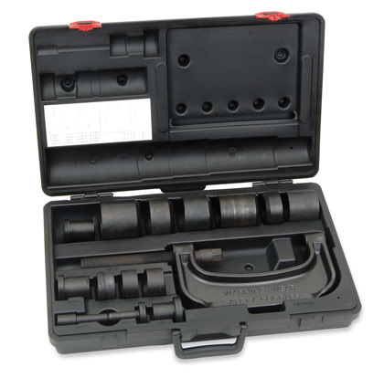

Thats the press tool needed to install the balljoint.
