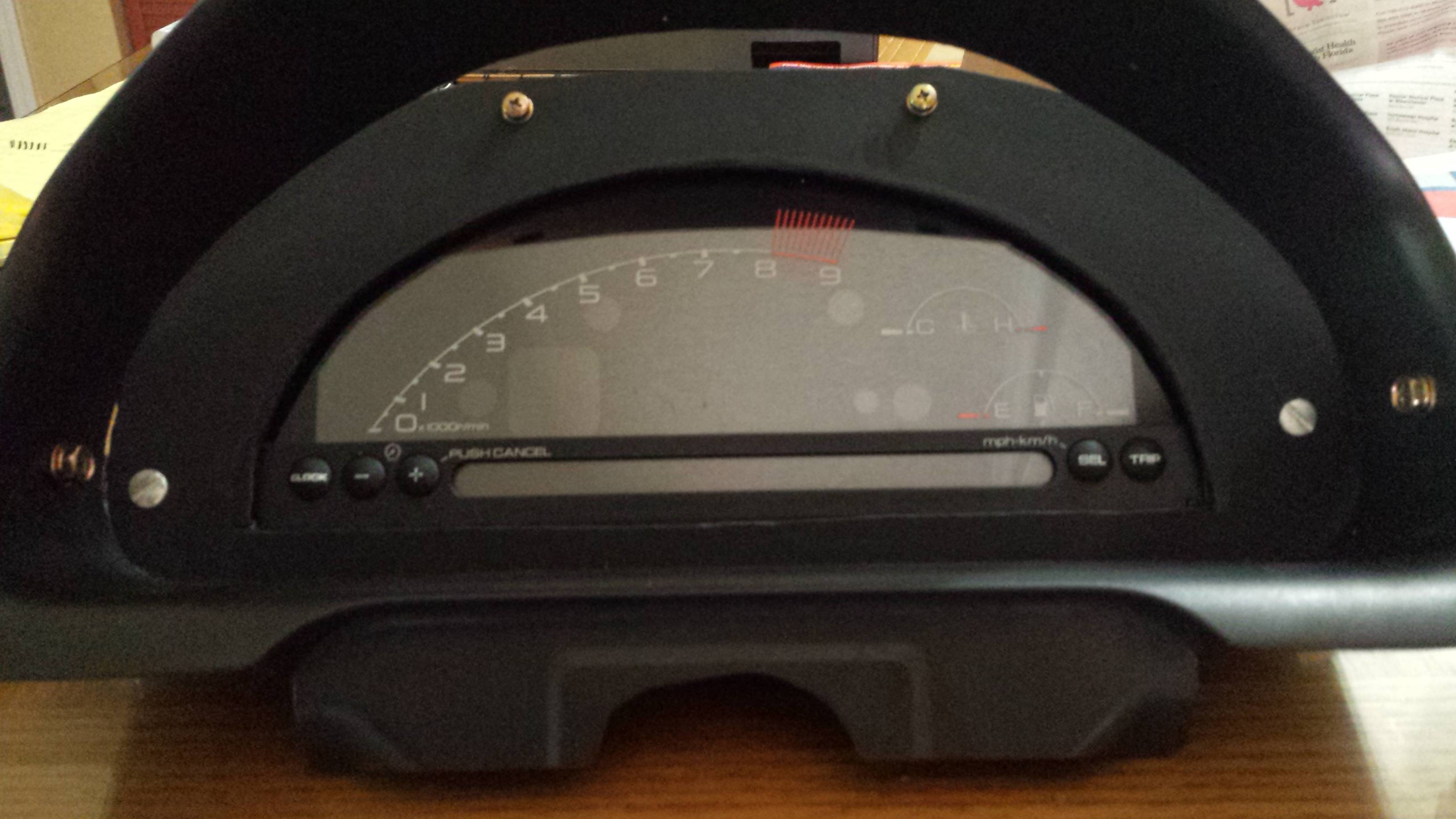

Cluster Shroud you dont mind tearing up.
Acrylic/plexiglass/fiberglass (something to cover up the cluster)

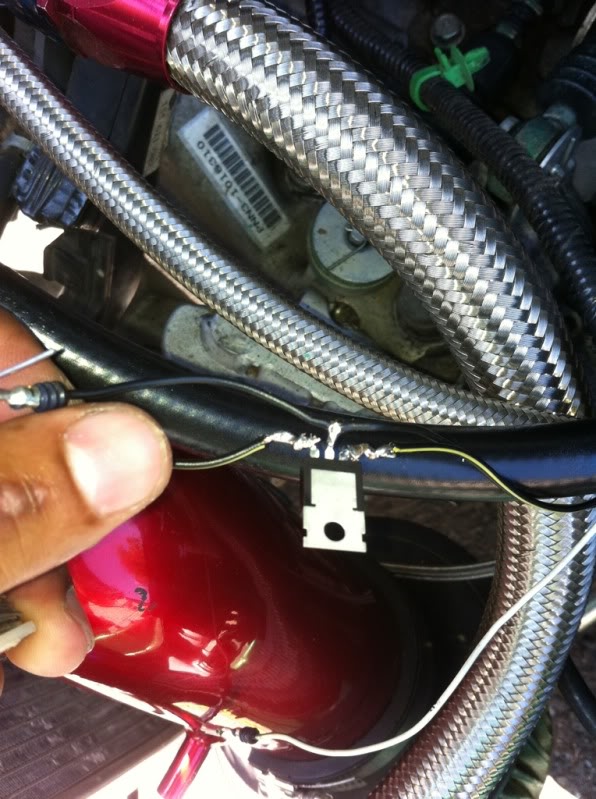

With a knife cut a small part of black wire and connect middle pin of voltage Reg. This wire is the ground

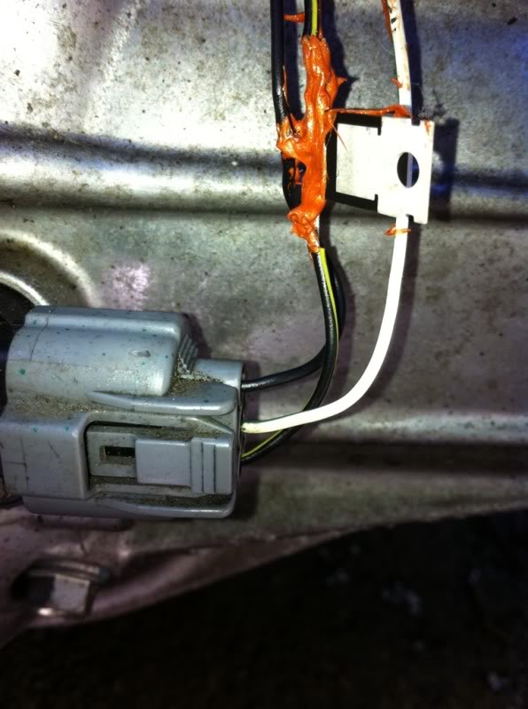

On the out side of the voltage Reg. Cut Black/yellow wire and solder the wire on each end. It doesn't matter on which pin u use. - what we doing is Control voltage that is on the black/yellow wire. 02-04 harness n ecu send 12v though this wire! 05-06 needs 5v!
For protection all the wires I use high temp silcone

<timerone.h><timerone.h><timerone.h><timerone.h><t imerone.h> PART 5: BRACKETS AND MOUNTING</timerone.h></timerone.h></timerone.h></timerone.h></timerone.h>
<timerone.h><timerone.h><timerone.h><timerone.h><t imerone.h> </timerone.h></timerone.h></timerone.h></timerone.h></timerone.h>
<timerone.h><timerone.h><timerone.h><timerone.h><t imerone.h> There are multiple ways to mount the cluster into your car.</timerone.h></timerone.h></timerone.h></timerone.h></timerone.h>
<timerone.h><timerone.h><timerone.h><timerone.h><t imerone.h> If you have oodles of money you can make your own carbon fibre shroud. Or if you are a broke *** college kid like me then you can spend about 5$ at your local homedepot and have something that looks ... decent.</timerone.h></timerone.h></timerone.h></timerone.h></timerone.h>
<timerone.h><timerone.h><timerone.h><timerone.h><t imerone.h> Here is how I did mine.</timerone.h></timerone.h></timerone.h></timerone.h></timerone.h>
<timerone.h><timerone.h><timerone.h><timerone.h><t imerone.h> 1. Cut shroud: Name:  qDc9ATX.jpg
Size:  985.6 KB</timerone.h></timerone.h></timerone.h></timerone.h></timerone.h>
<timerone.h><timerone.h><timerone.h><timerone.h><t imerone.h> 2. Buy acrylic sheet from homedepot (4$) and cut out your bezel.</timerone.h></timerone.h></timerone.h></timerone.h></timerone.h>
<timerone.h><timerone.h><timerone.h><timerone.h><t imerone.h> Name:  NTzzN1e.jpg
Size:  789.0 KB</timerone.h></timerone.h></timerone.h></timerone.h></timerone.h>
<timerone.h><timerone.h><timerone.h><timerone.h><t imerone.h> 3. Use the scrap aluminum to make your brackets. (My brackets come from the back of the cluster, and screw into the acrylic sheet. From there the brackets come forward to screw into the shroud)</timerone.h></timerone.h></timerone.h></timerone.h></timerone.h>
<timerone.h><timerone.h><timerone.h><timerone.h><t imerone.h> Name:  cW9wSdd.jpg
Size:  889.0 KB</timerone.h></timerone.h></timerone.h></timerone.h></timerone.h>
<timerone.h><timerone.h><timerone.h><timerone.h><t imerone.h> Name:  fgbsStk.jpg
Size:  885.2 KB</timerone.h></timerone.h></timerone.h></timerone.h></timerone.h>
<timerone.h><timerone.h><timerone.h><timerone.h><t imerone.h> 4. Once you are sure it fits. Paint it.</timerone.h></timerone.h></timerone.h></timerone.h></timerone.h>
<timerone.h><timerone.h><timerone.h><timerone.h><t imerone.h> Name:  YpobrOD.jpg
Size:  442.8 KB</timerone.h></timerone.h></timerone.h></timerone.h></timerone.h>
<timerone.h><timerone.h><timerone.h><timerone.h><t imerone.h> 5. Drill holes on the side of the cluster shroud to mount it.</timerone.h></timerone.h></timerone.h></timerone.h></timerone.h>
<timerone.h><timerone.h><timerone.h><timerone.h><t imerone.h> Name:  tKh5jXF.jpg
Size:  967.0 KB</timerone.h></timerone.h></timerone.h></timerone.h></timerone.h>
<timerone.h><timerone.h><timerone.h><timerone.h><t imerone.h> Name:  AeYnfg8.jpg
Size:  353.2 KB</timerone.h></timerone.h></timerone.h></timerone.h></timerone.h>
<timerone.h><timerone.h><timerone.h><timerone.h><t imerone.h> 6. Mount in car and enjoy.</timerone.h></timerone.h></timerone.h></timerone.h></timerone.h>
<timerone.h><timerone.h><timerone.h><timerone.h><t imerone.h> Name:  ALZF6mb.jpg
Size:  351.3 KB</timerone.h></timerone.h></timerone.h></timerone.h></timerone.h>

<timerone.h><timerone.h> Without bezel:</timerone.h></timerone.h>
<timerone.h><timerone.h> </timerone.h></timerone.h>
<timerone.h><timerone.h> With Bezel:</timerone.h></timerone.h>
