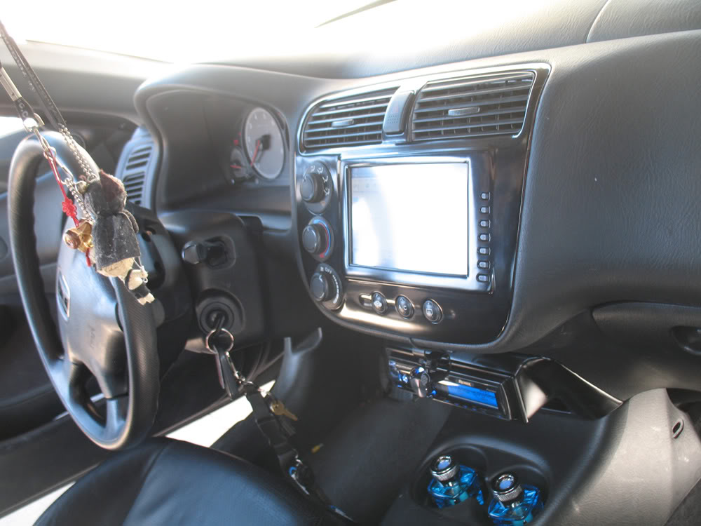

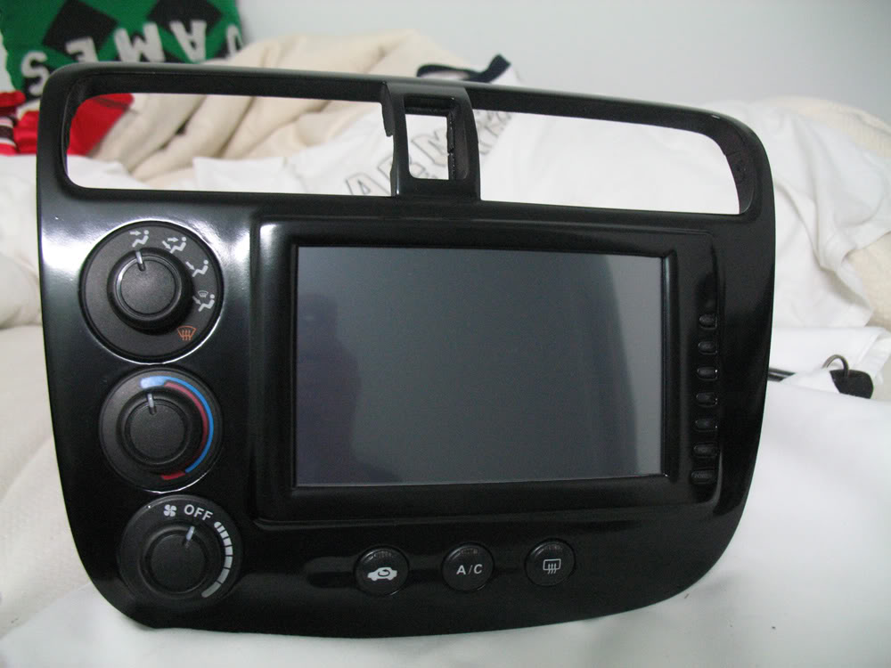

i have molded a few screens to cars but this is one of my recent ones:

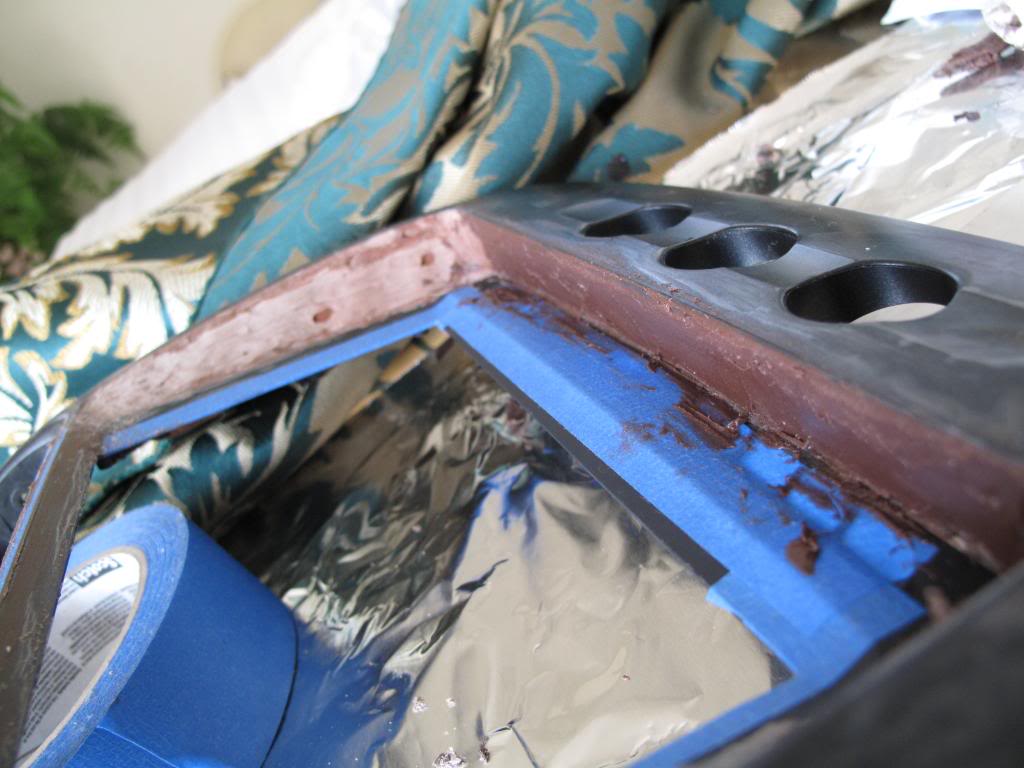

i put glue on the top of the bezzel where it meets the dash. its a dark gray color:
let it dry for 15-24hours (depending on eproxy)
AND DONT TOUCH IT OR ELSE YOU WILL F**K UP THE POSITION.

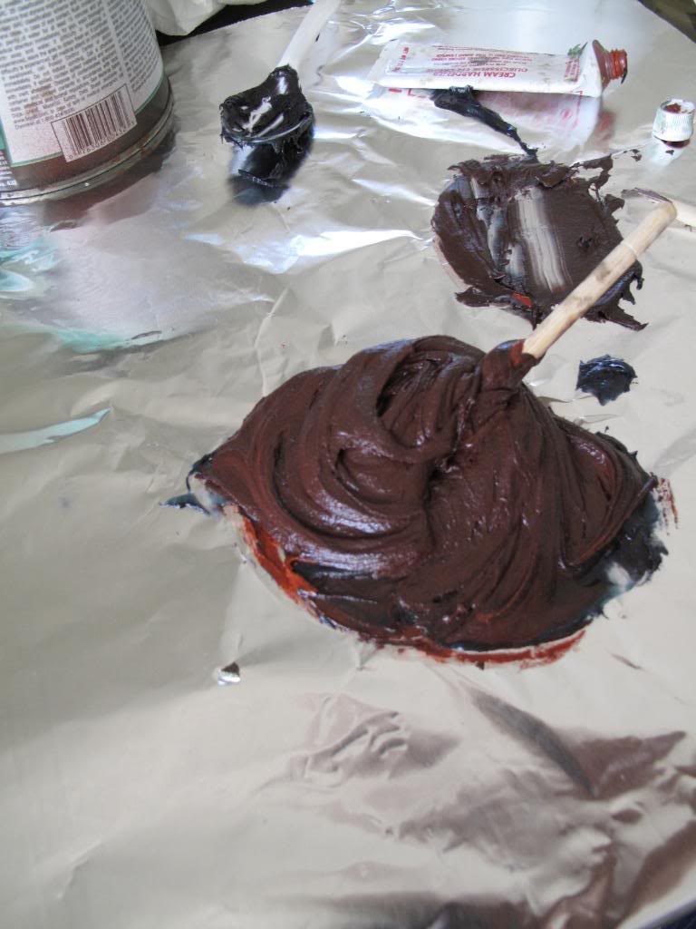

put some alu foil on a desk, and put tape over it (this will be ur mixing plate)
i forgot to put tape and i ripped through the foil...and smeared the glass table... not good.
mixing bondo is easy. you put a nice blob on the mixing area, and just add a line of hardener on top, and MIX!!!
(there is a proper way to mix bondo)
how to mix: watch @ 1:40
http://www.youtube.com/watch?v=DU4rL...eature=related
the REAL proper way to mix: this method takes out all air bubles
http://www.youtube.com/watch?v=A8gsOlw_gSI
if you are asian like me, you should have more chopsticks in ur house than you have grass outside... so im sure i can spare a few.

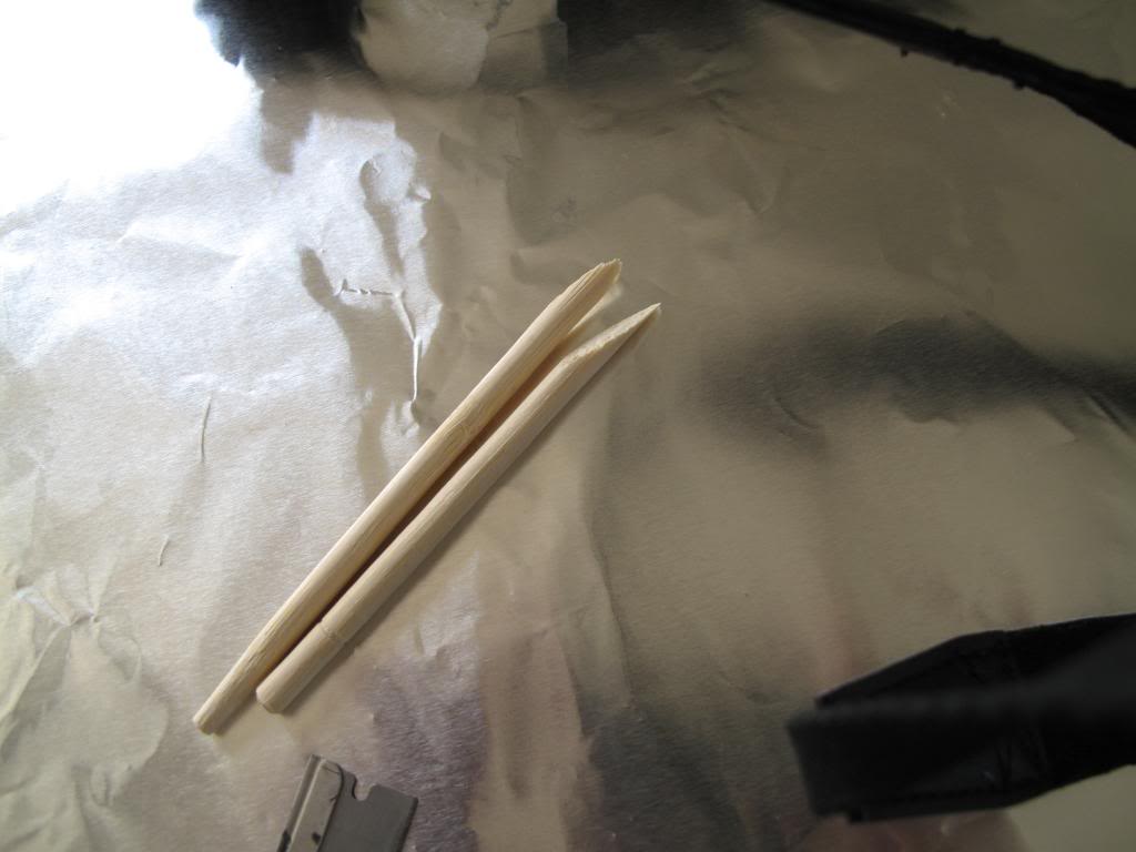

here i cut a wooden chopstick at an angle to use it as a mixing stick...but anything else would do... (plastic knives work great) you just want something disposable.
mix it, and mix it well.
you have aprox 2mins before it hardens up (i used a lil bit too much hardener, thats why)

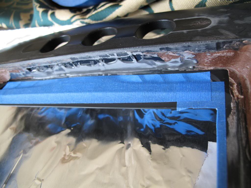

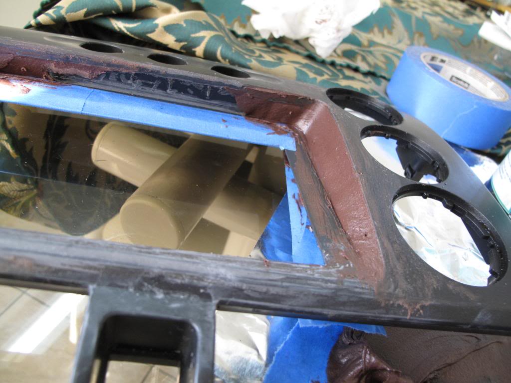

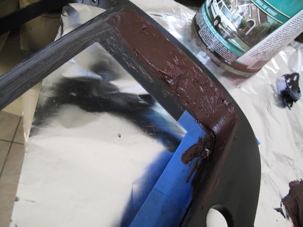

APPLYING BONDO/MOLD:

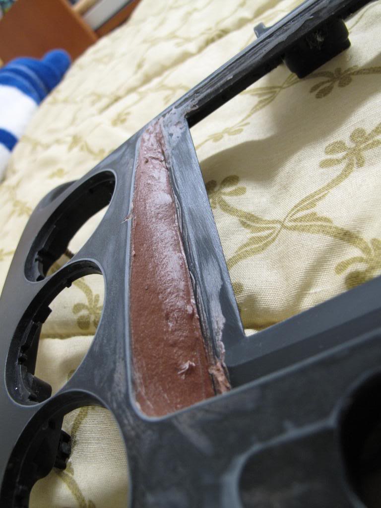

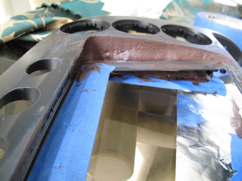

the first step is just to get a nice base and shape, dont worry about it being 100% smooth...but try to get a decent shape out of it. it will save you time...
ONLY WORK SMALL SECTIONS AT A TIME. DO NOT TRY TO DO THE WHOLE MOLD IN ONE MIX!!!!!!!
i did the top right corner first.

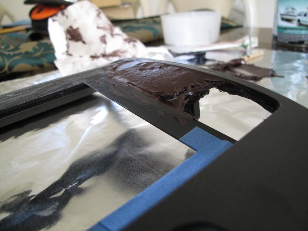

same corner, diff angle

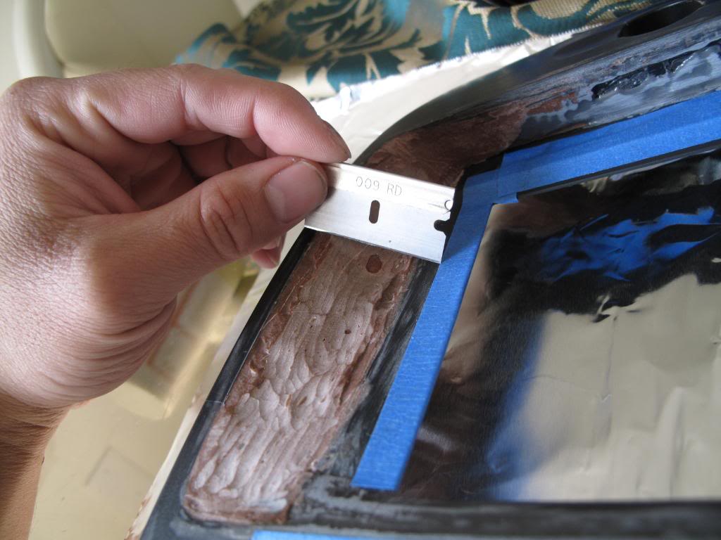

i used a razor blade and scrapped of to make it as "ideal" as possible.
get the idea????

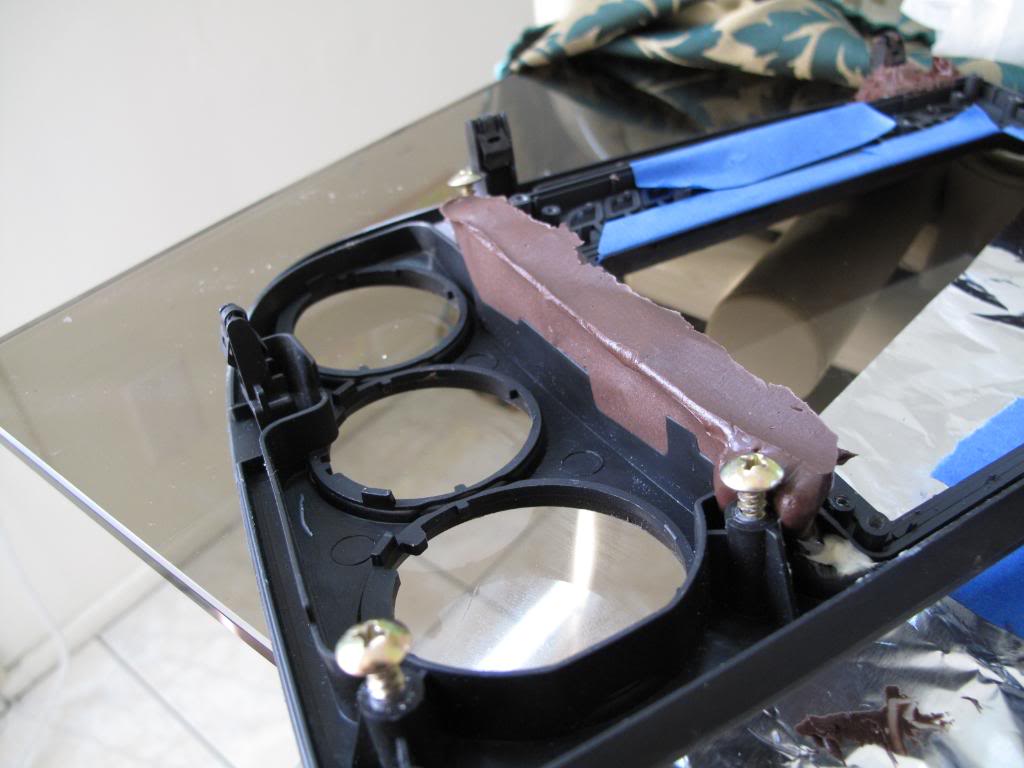

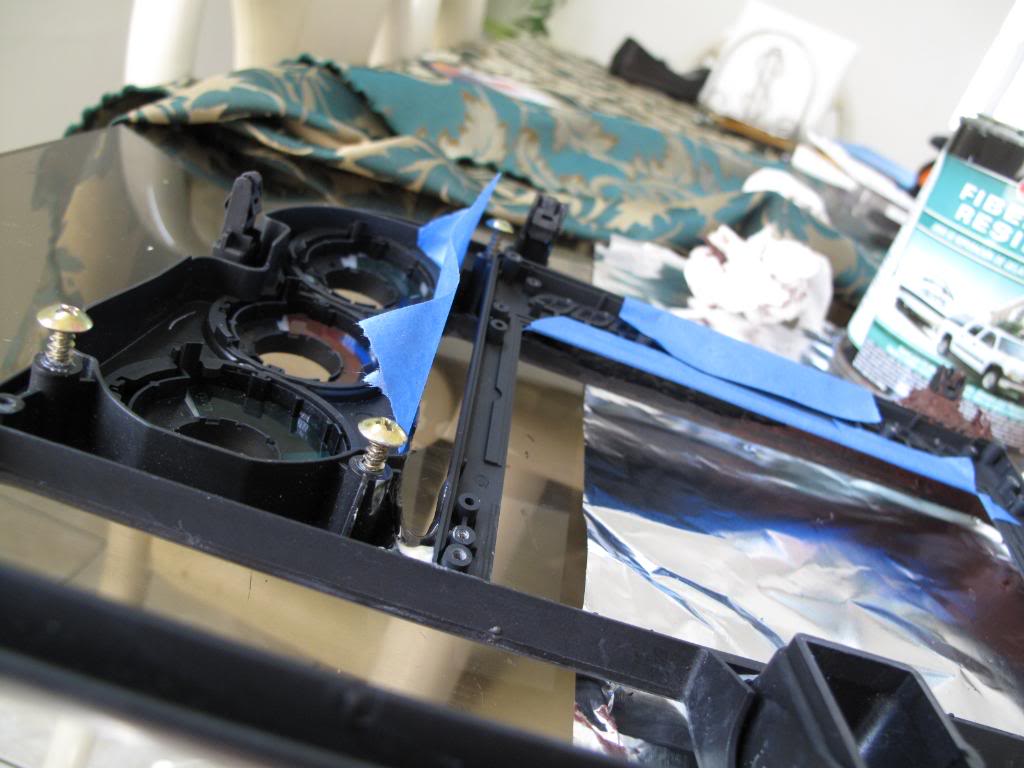

now here is a shot of the back:

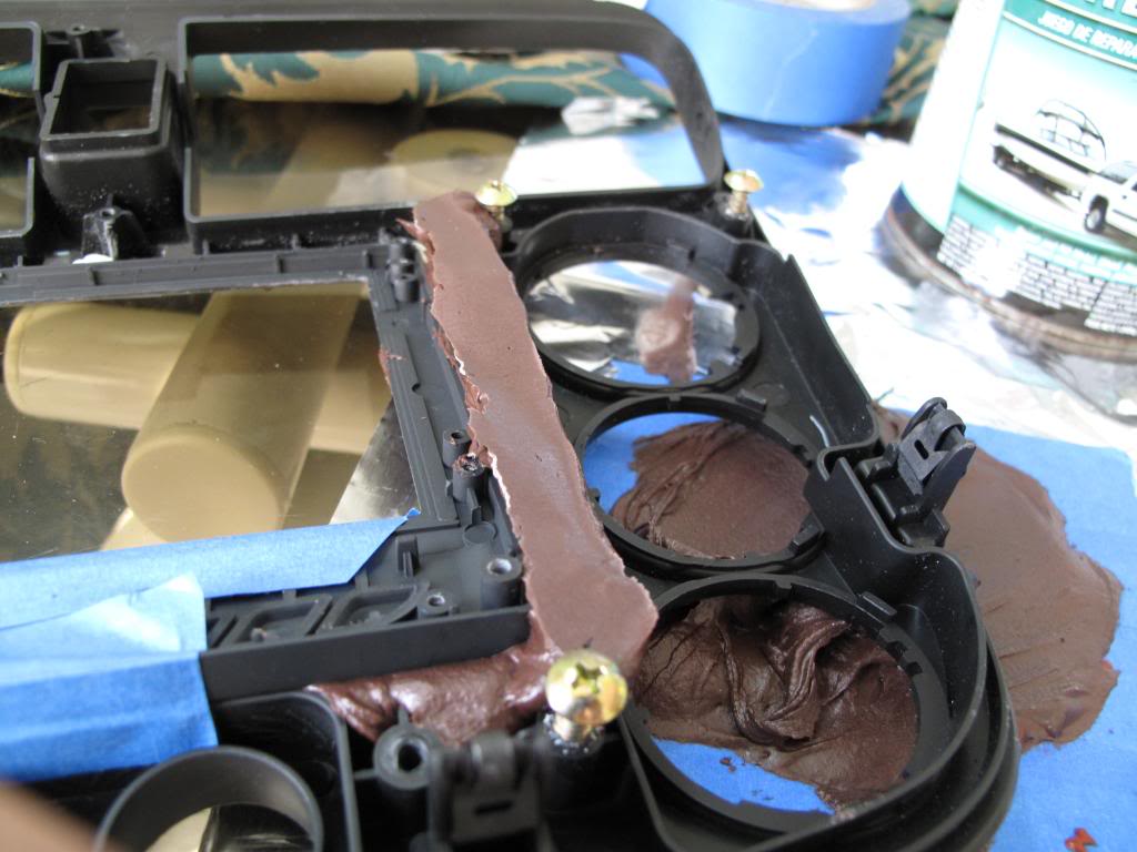

NOW, time to do the lower right portion...
if you are **** like me, you will take the bottom/back to create a bowl...plus you can control how much bondo you put in and it wont drip everywhere or get messy.
front view:

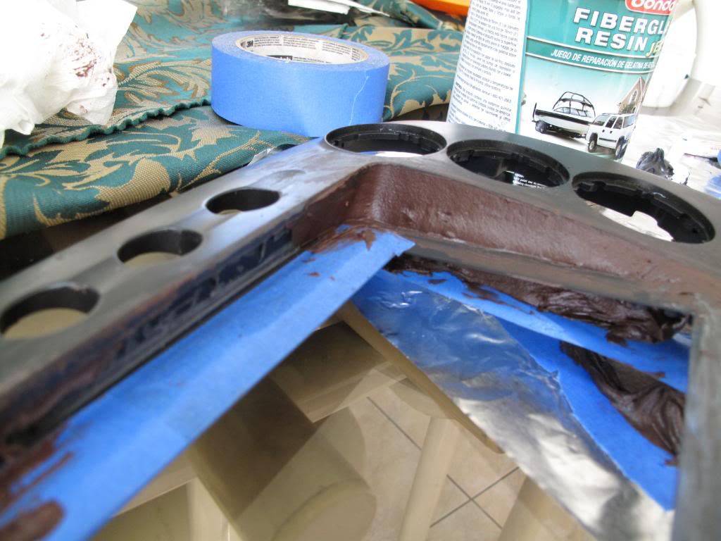

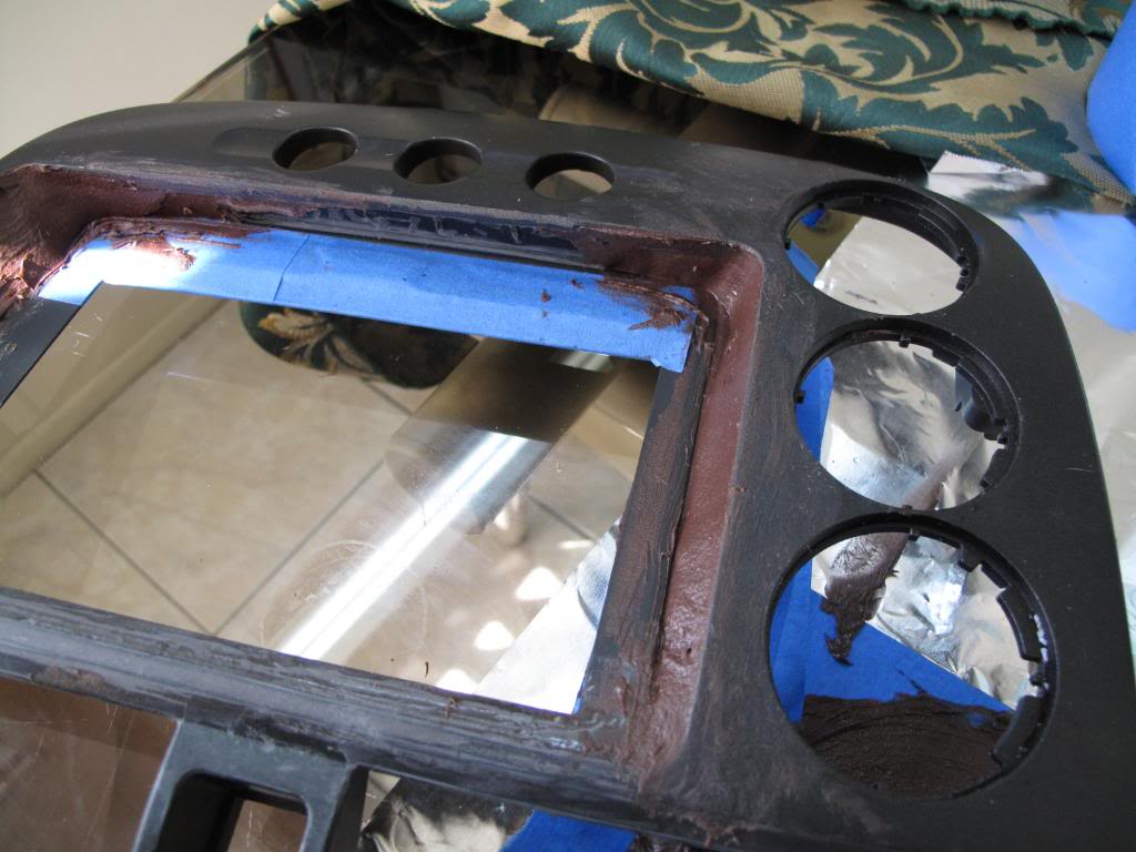

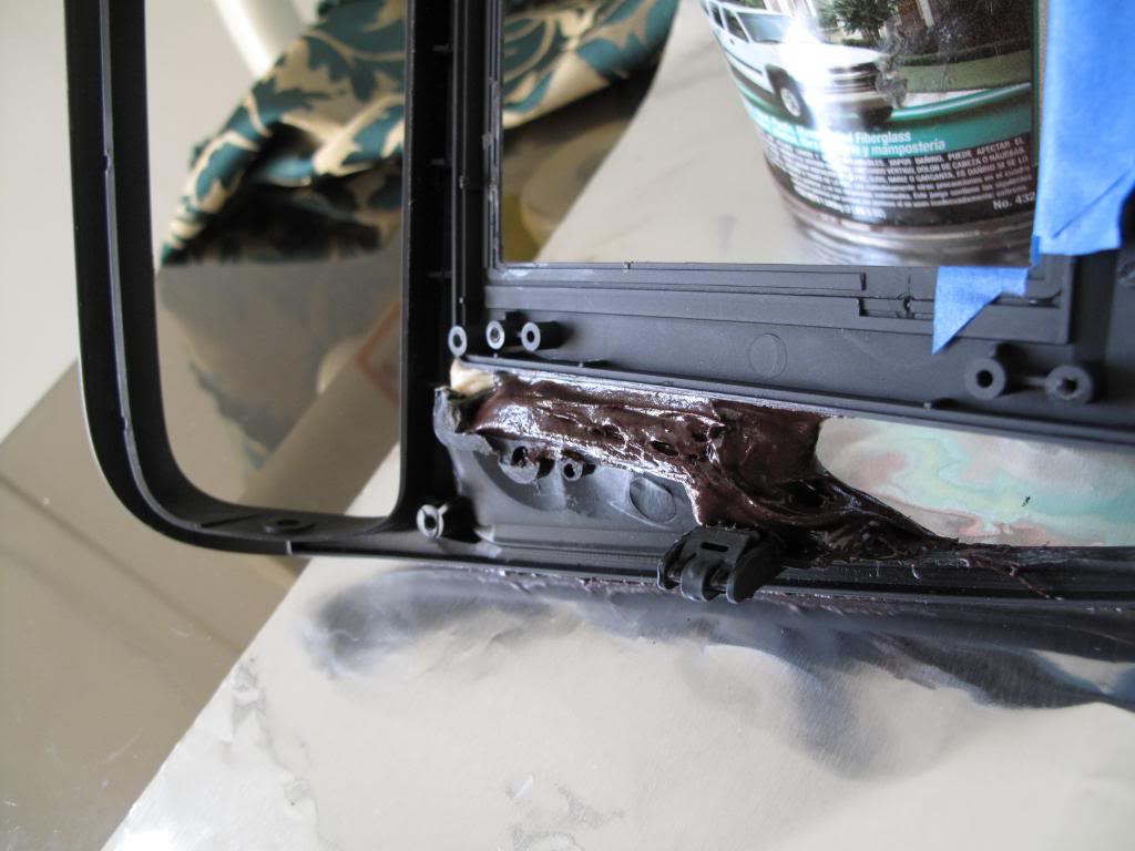

put some bondo down on the lower right.

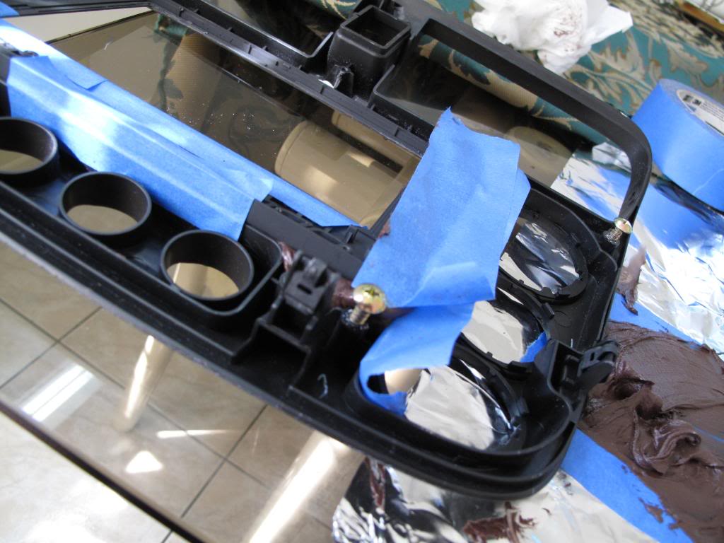

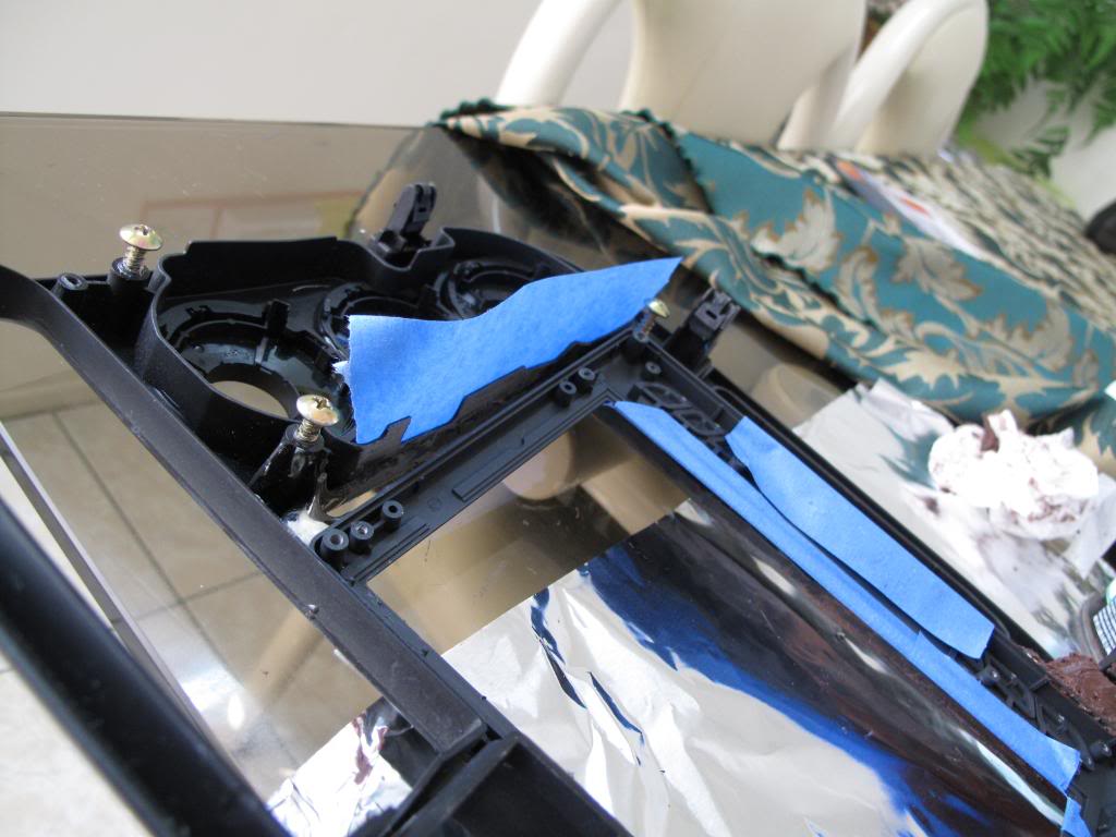

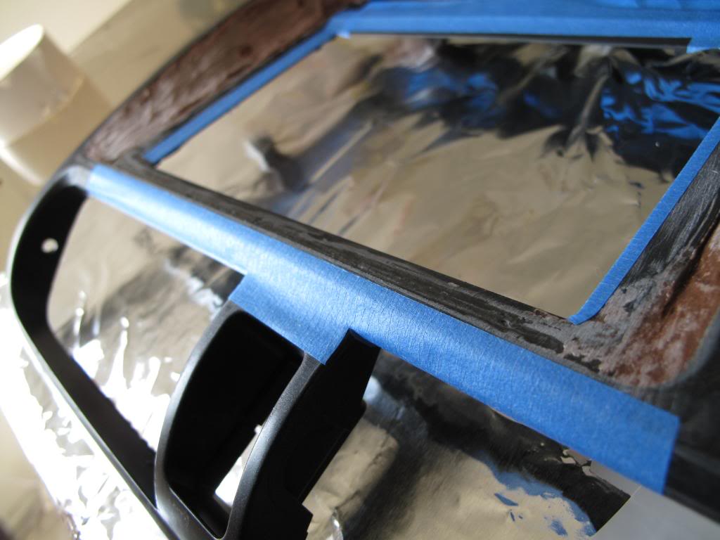

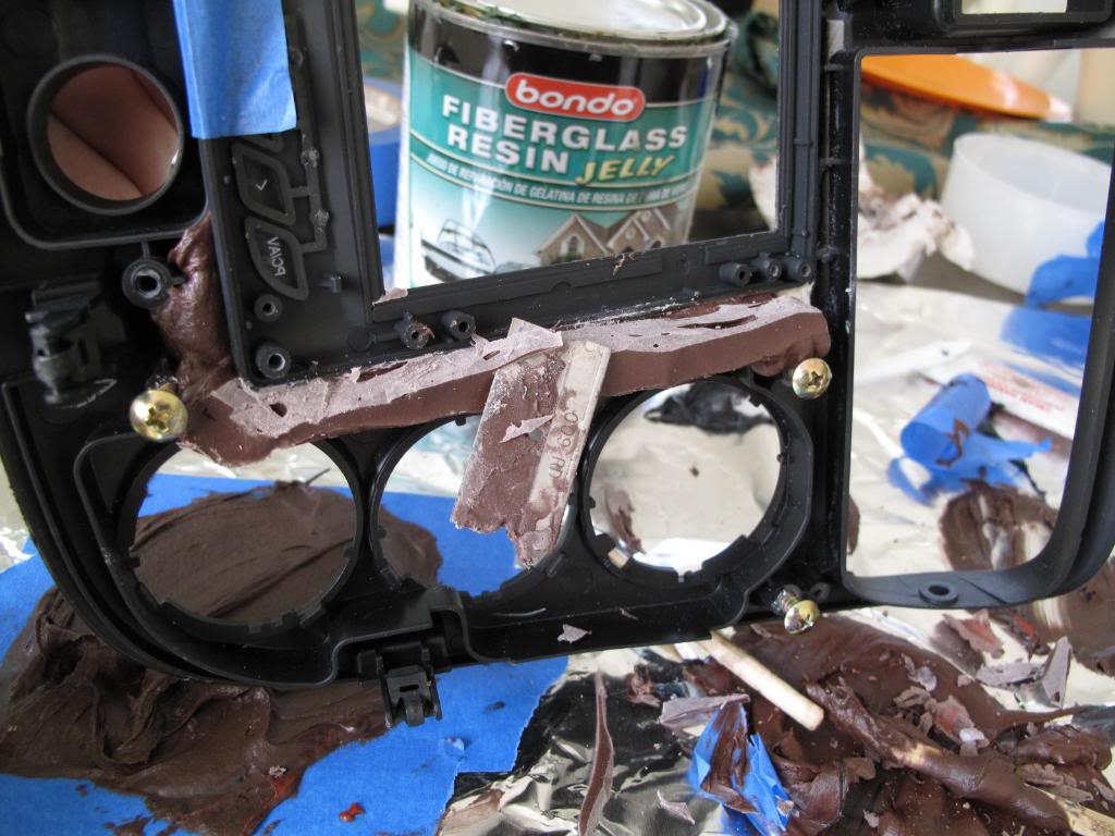

i skipped the bottom area for now, and went ahead and went to the other side:
here i taped the back again, so it doesnt go everywhere.
then i put some bondo on that ISH!

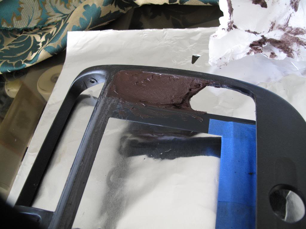

again, i used a razor blade to shapen the mold. and to straighten it.
remember that it doesnt have to be perfect......yet

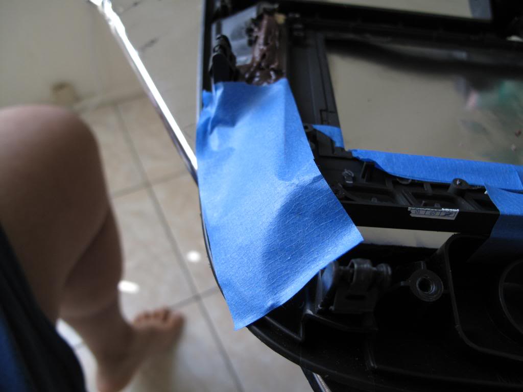

picture of the back and the tape:
peel the tape off, and you get a nice molding...haha

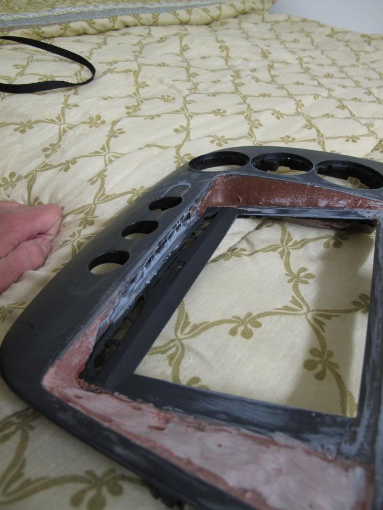

take a razor and shave some of it off, so it will chear the screen...for now... you will dremel alot of it off later...

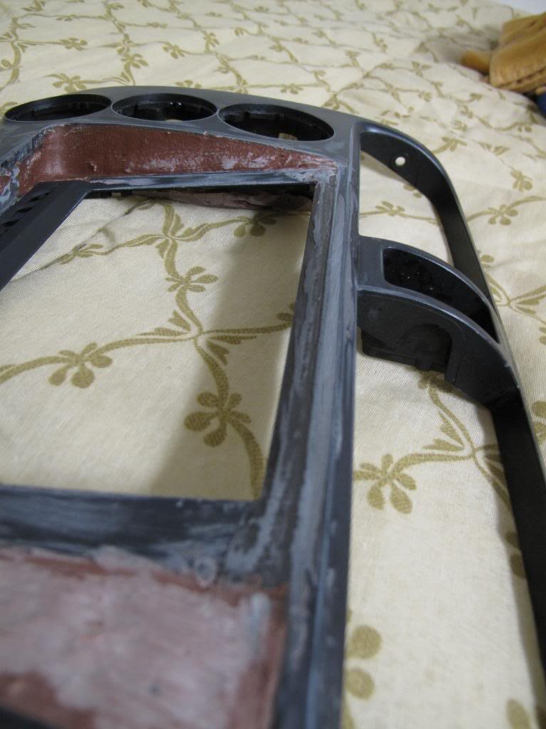

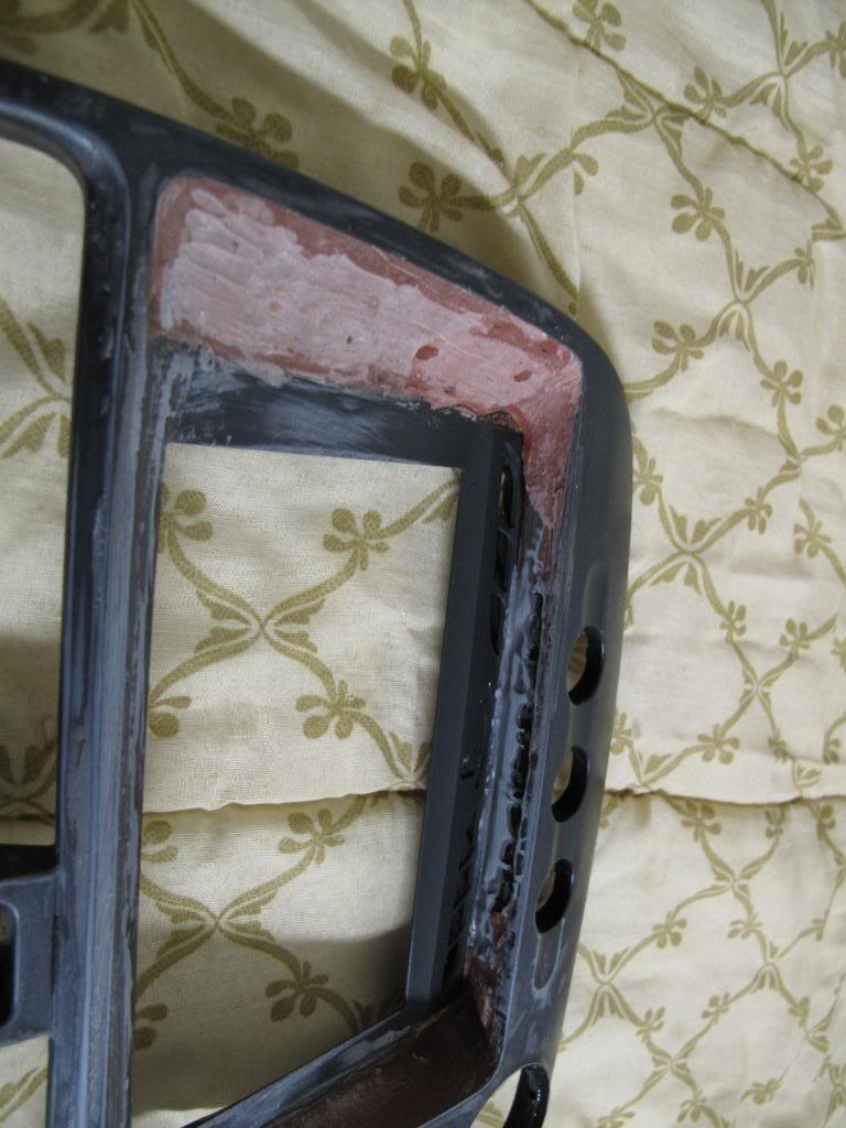

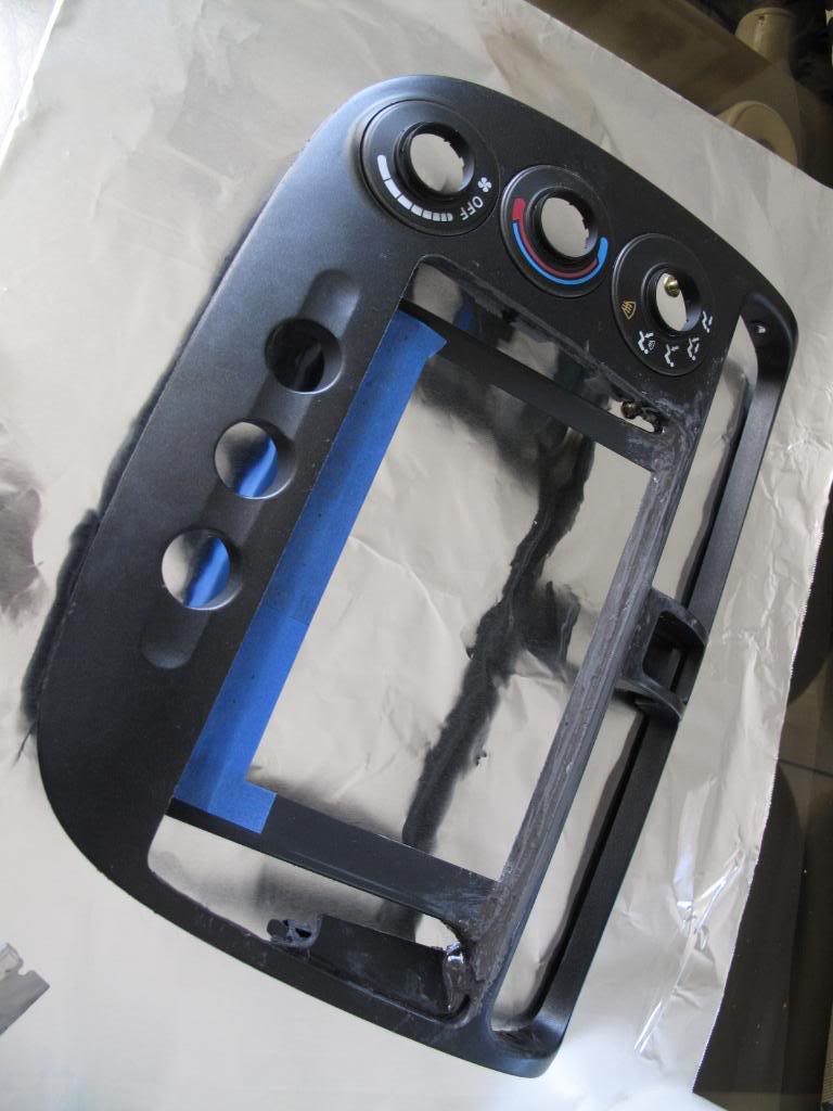

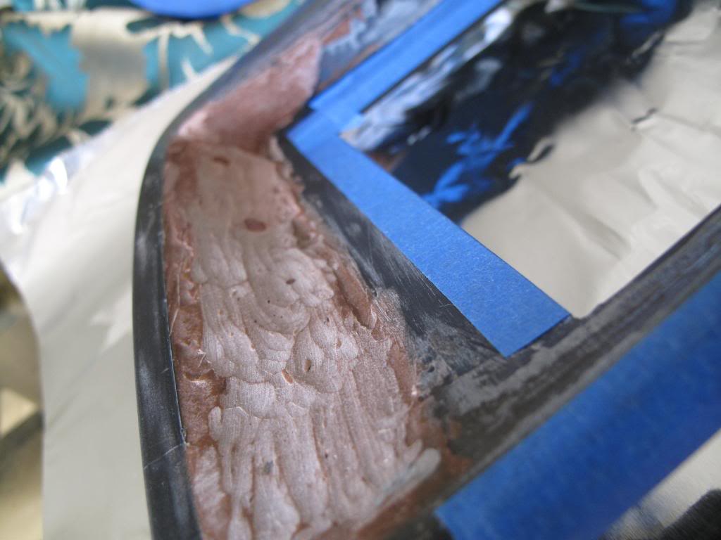

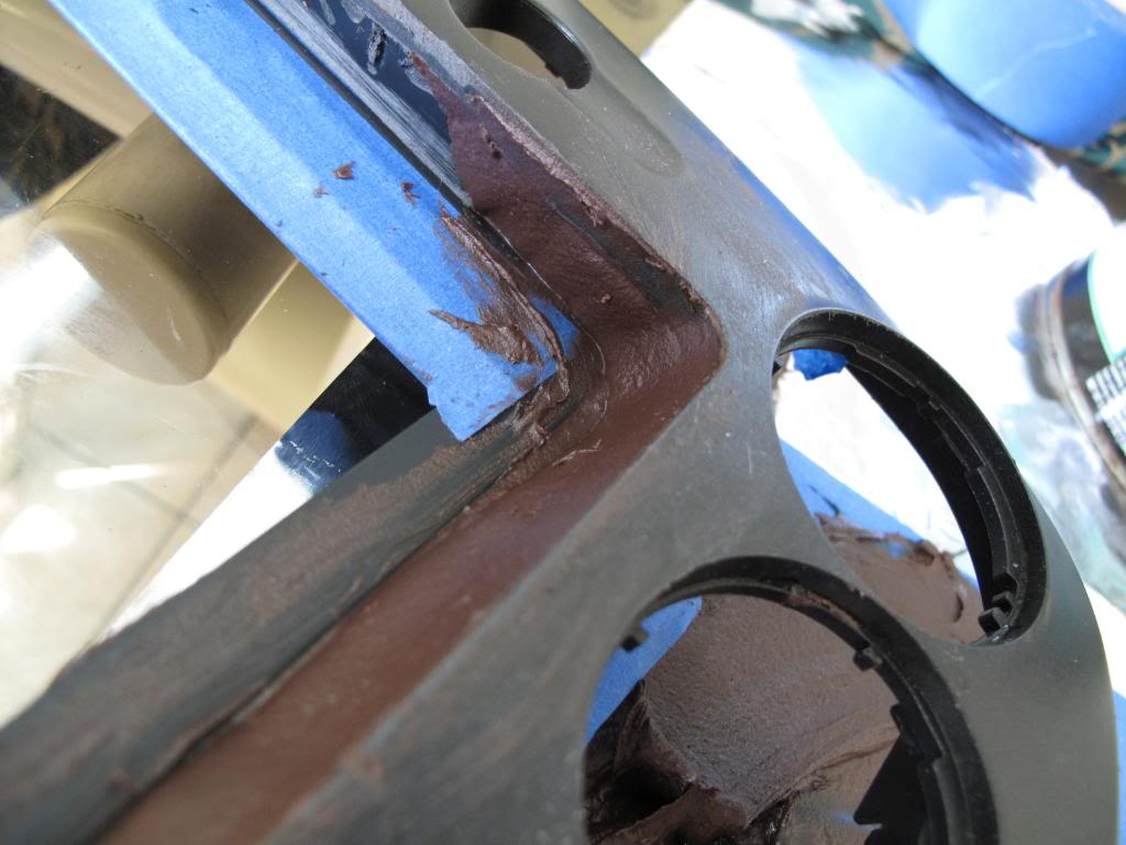

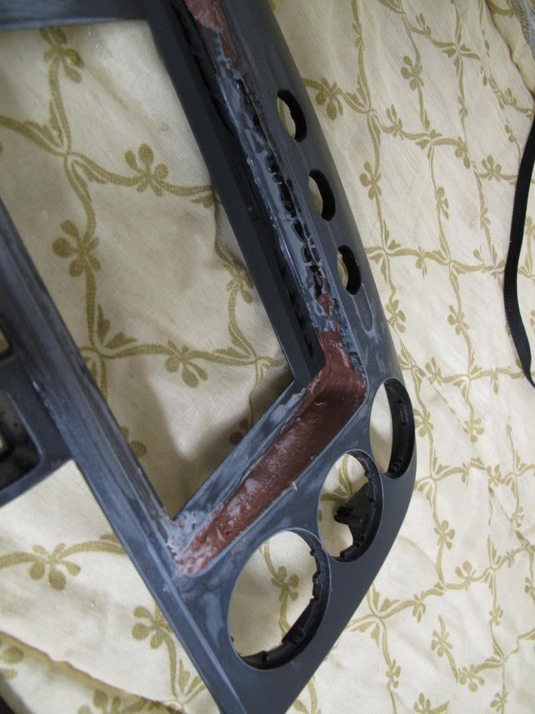

HERE IS WHAT YOU HAVE SO FAR:
i also nicked off some bondo, to create a ruff surface to put the final layer of bondo (not untill way later)
i havnt touched the bottom or top yet.
notice that the glue (JB WELD) that i first put to hold the bezzle to the dash.
see how its not perfect...? but doesnt look too bad either

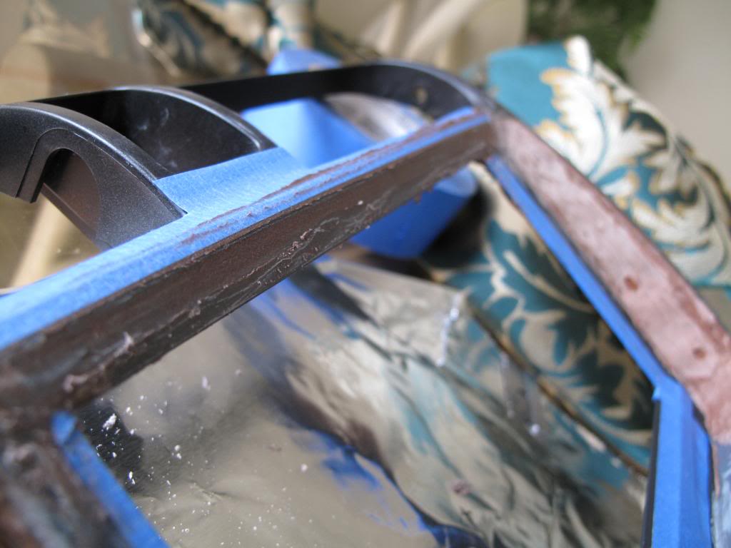

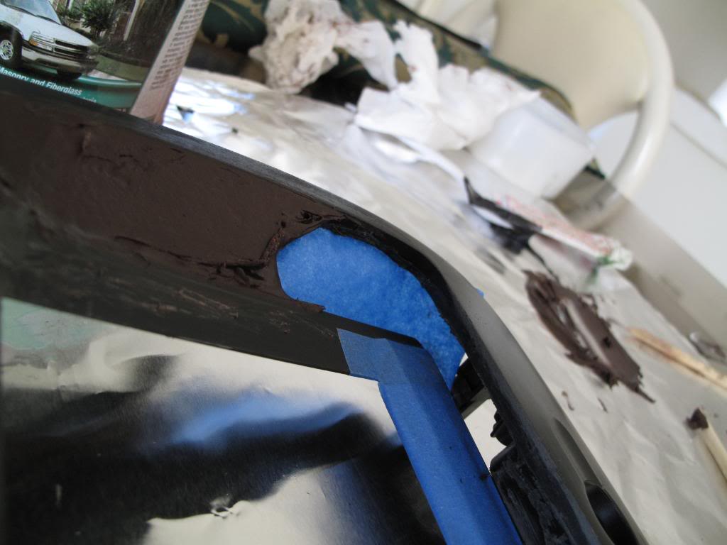

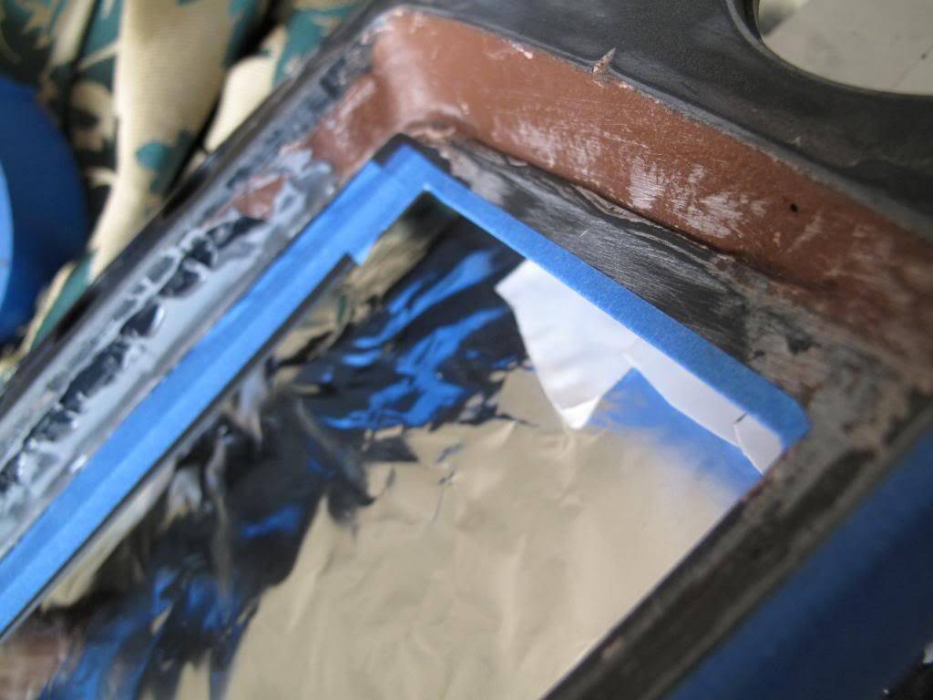

NOW ITS TIME TO MOLD THE TOP/BOTTOM:
put some tape over the top half of the screen so excess bondo wont go on it...less cleanup later
and some tape on the bottom as well:
cover the buttons (that you took out already) less clean up later.
put tape on the inside as frame as well. less clean up later.

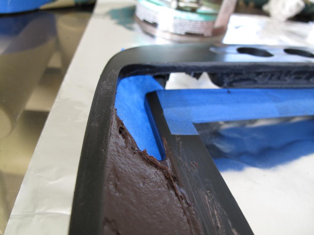

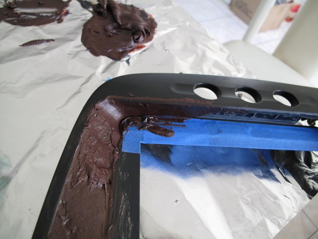

apply some bondo on top
then some on bottom:
