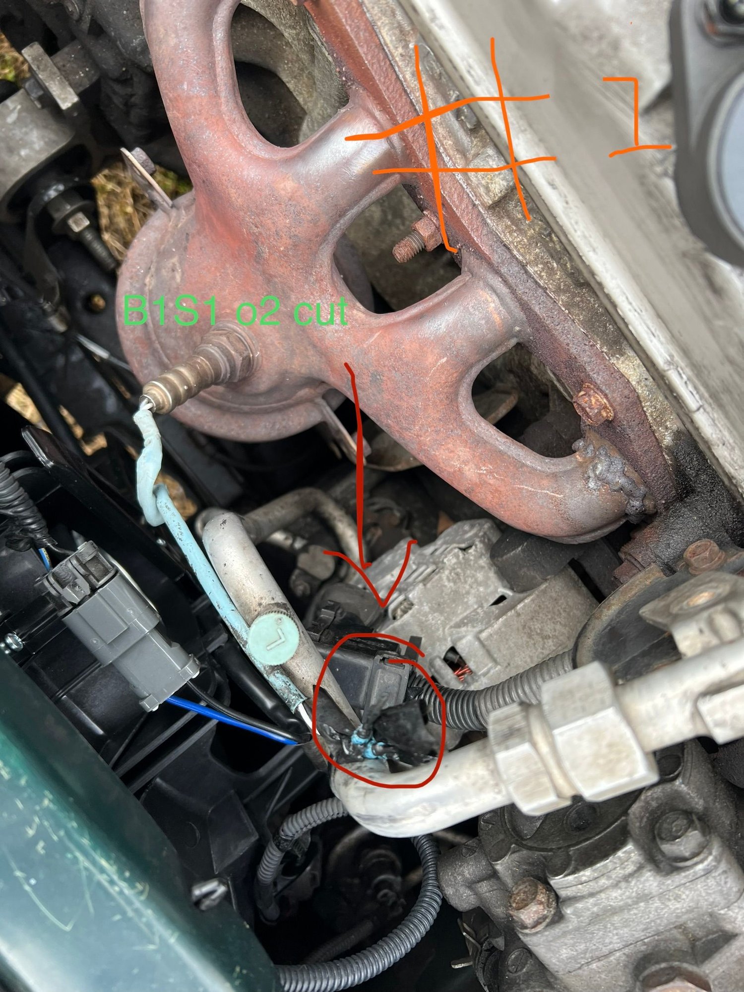

*2002 Honda civic ex*
B1S1(on manifold)sensor harness where it plugs in is not there.sensor harness also cut…What can I do..:PHOTO#1&2
is this a ground?is it supposed to be there?

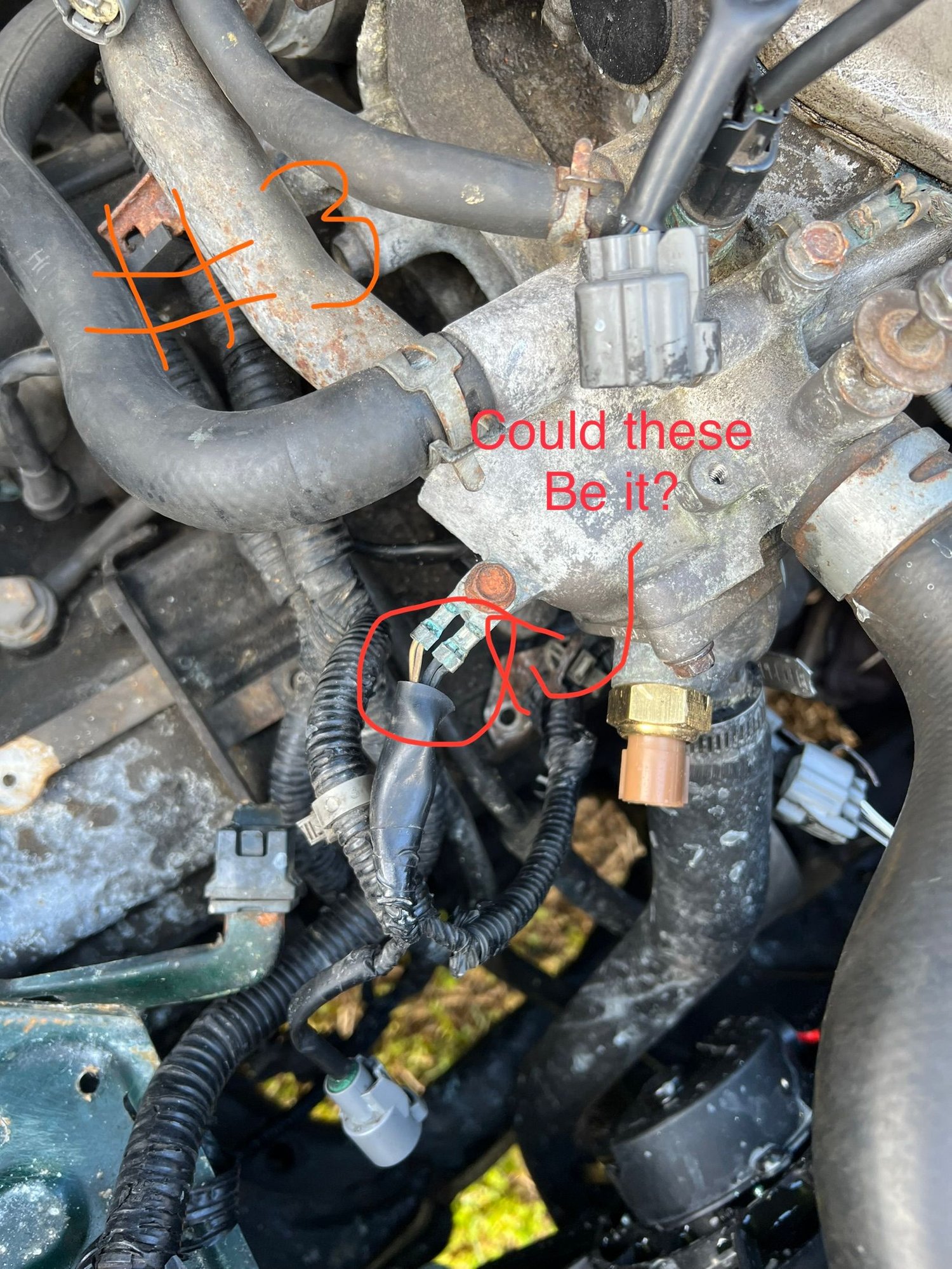

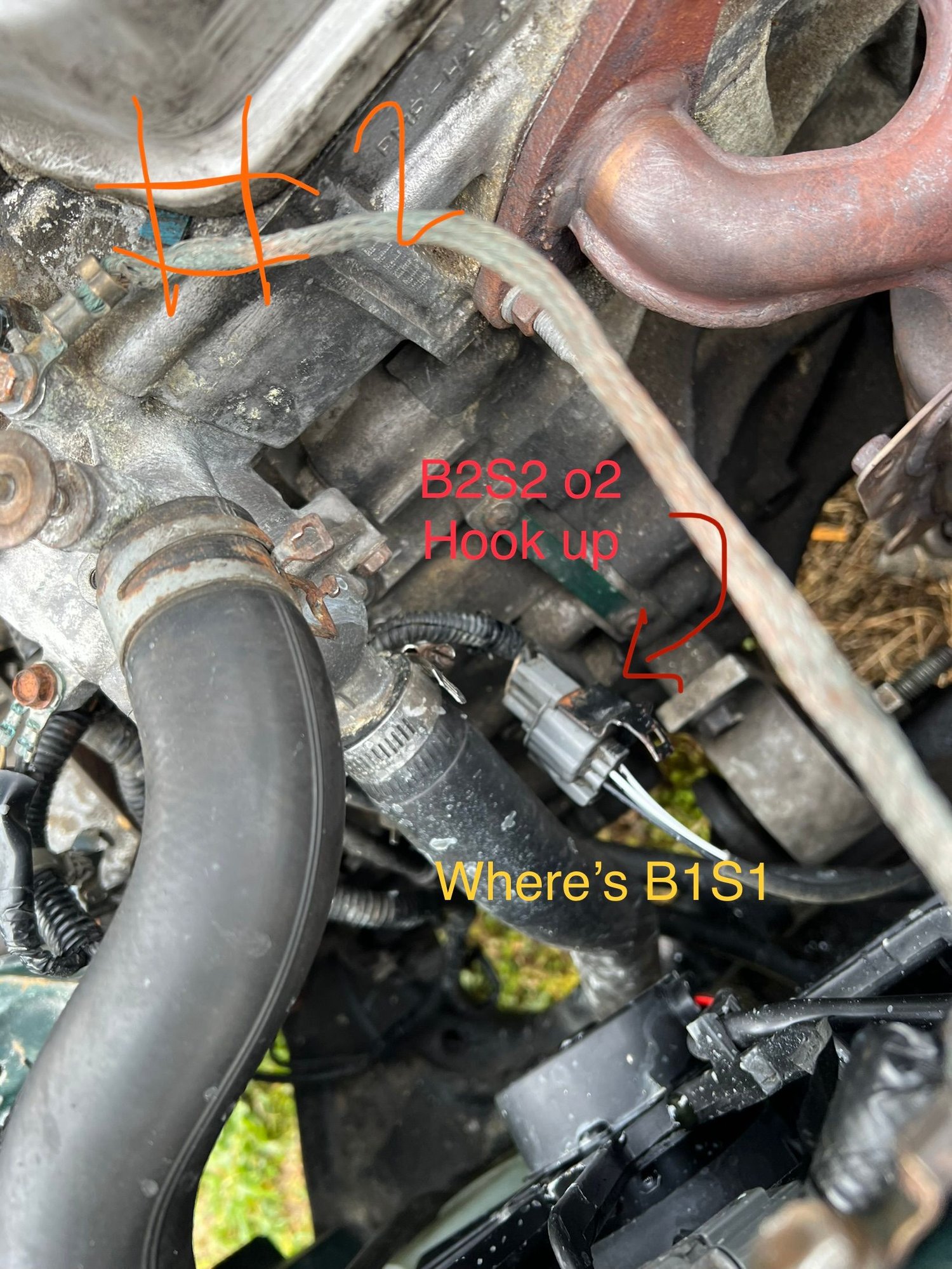

could it be the harness cords?!?…:PHOTO#3

That's not the right exhaust manifold if that's an ex. That's an lx manifold with the cat integrated into it. Is there a vtec solenoid on the head? What's stamped on the block?
Ex will have one sensor on the manifold, one under the car where the cat is supposed to be. Lx with have both sensors on the manifold, one above the cat, one below.
