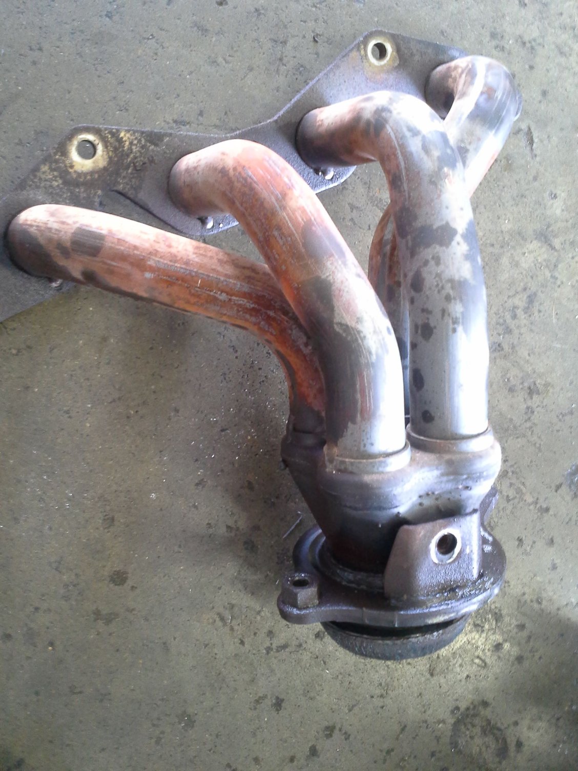

Here's the stock setup, of course.

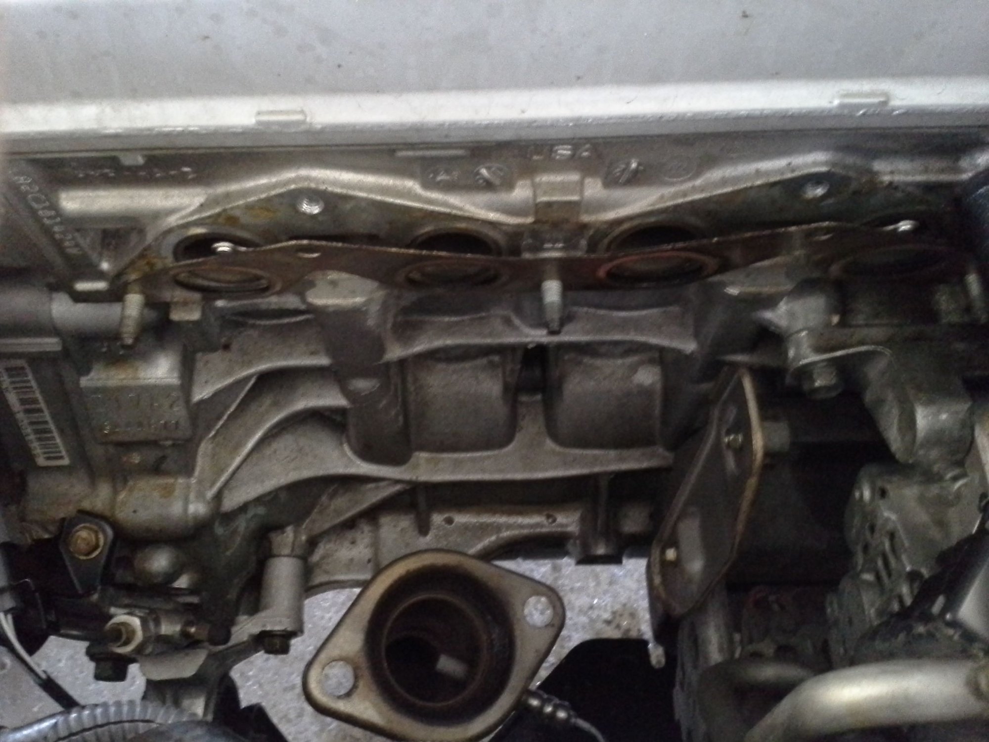

And with it off now. Unlike some people here, I didn't have much of a problem getting the bolts off.

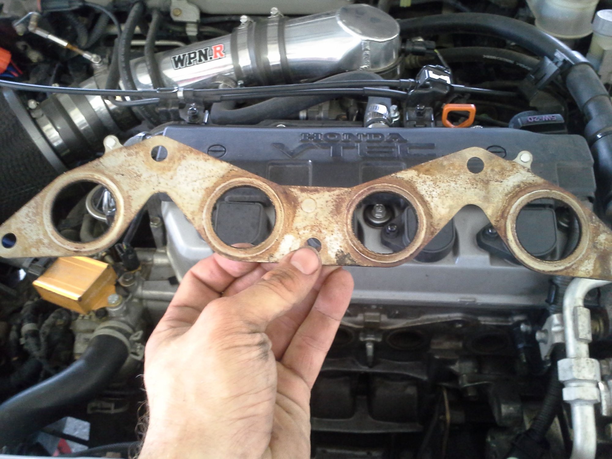

I made sure to take care of the gasket!
Here's the old one.

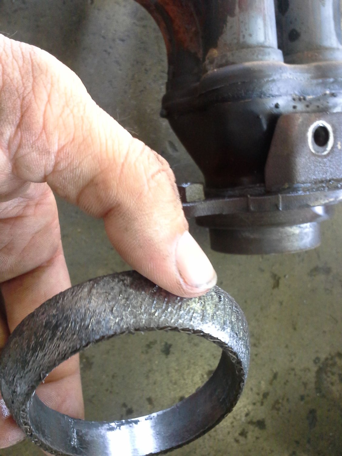

Make sure you take the donut ring gasket off of it and put it on the new one. Mine ended up causing an exhaust leak, so I got a brand new one. It's part 14 here.

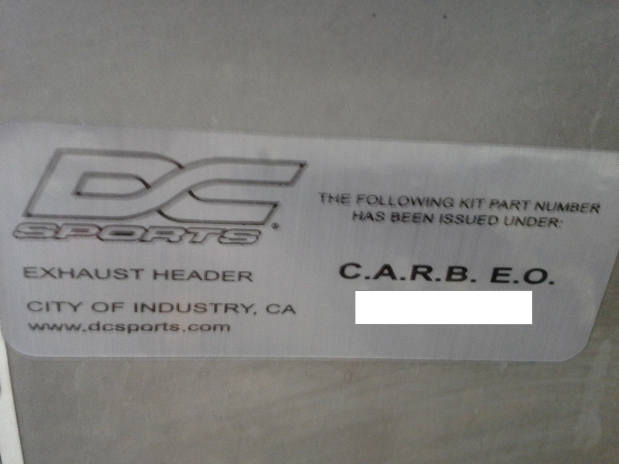

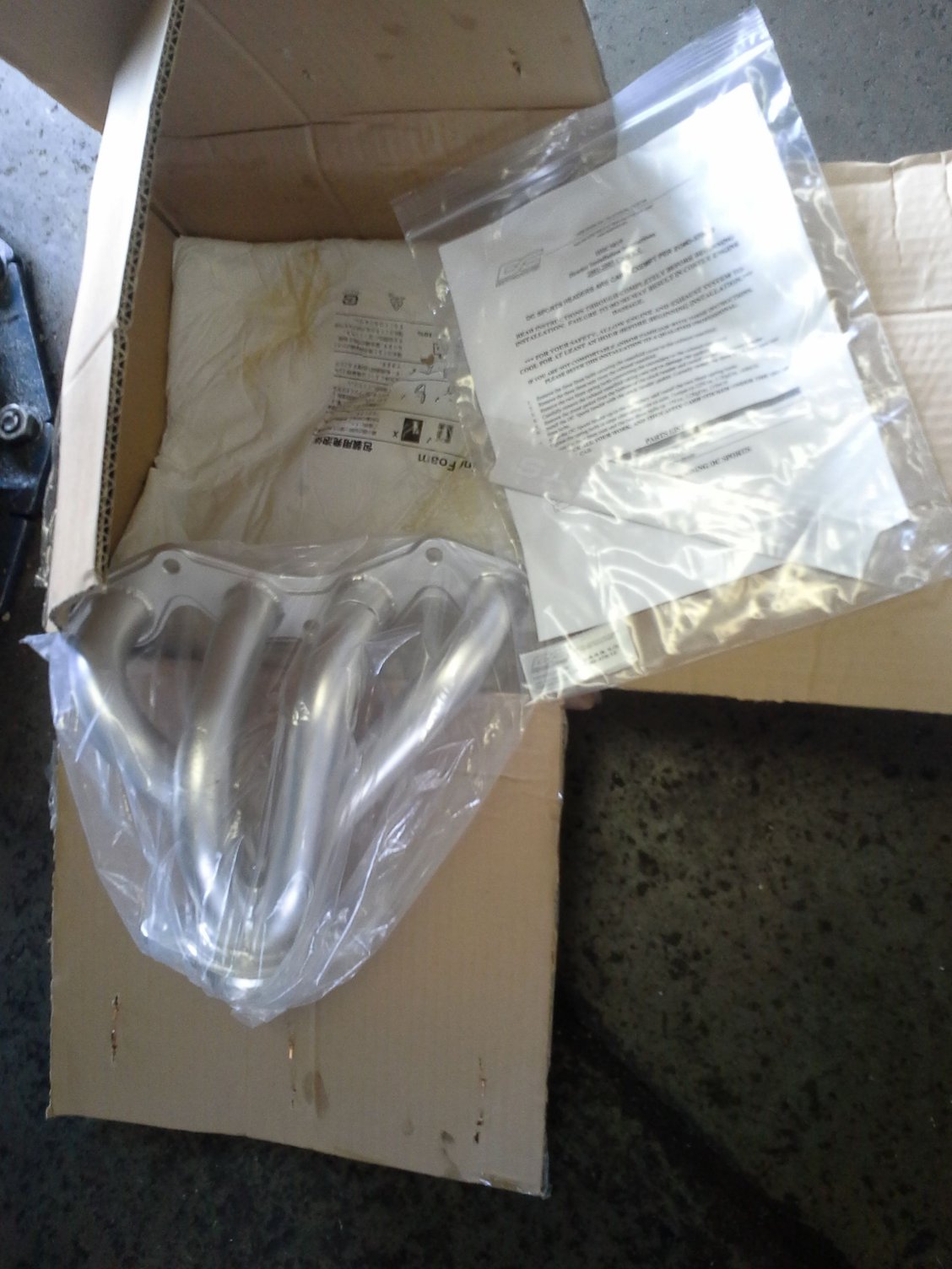

Fresh out of the box, it comes with the header, two vinyl stickers (white), instructions, and a metal CARB sticker for the engine bay. Thanks, Auto Anything!
There should be instructions in the box, but if you don't have them it's 23 ft-lbf for the top 5 bolts (I had to guesstimate the oneon the far right) and 16 ft-lbf for the two (pain in the ***) bolts holding the header to the downpipe. Don't forget the springs!

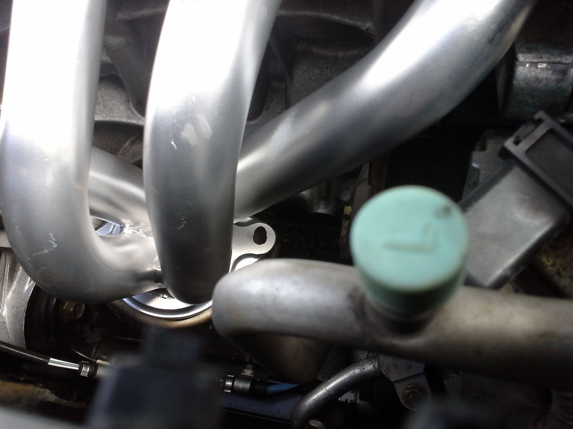

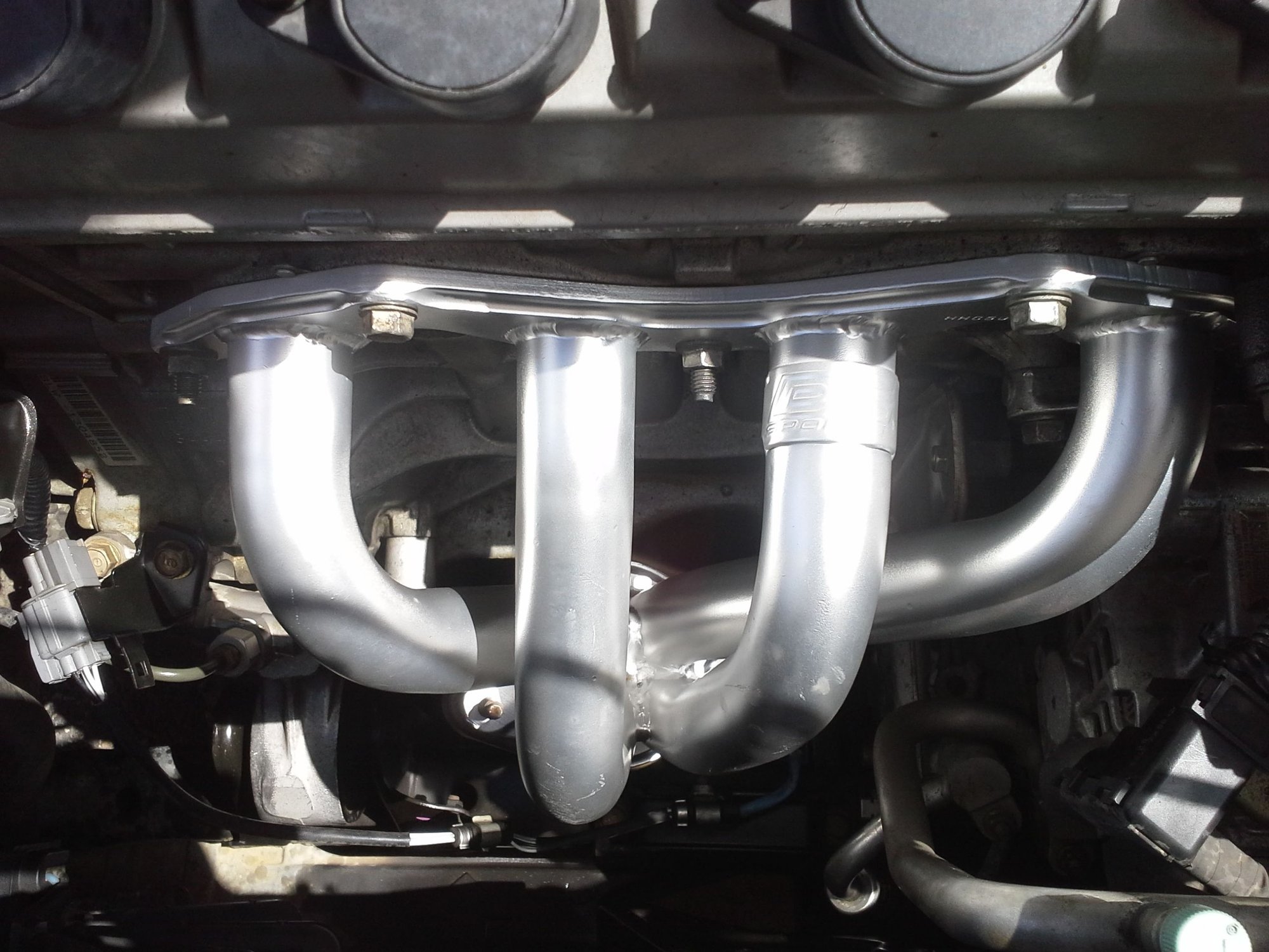

Here's a close up of it installed. Sexy!

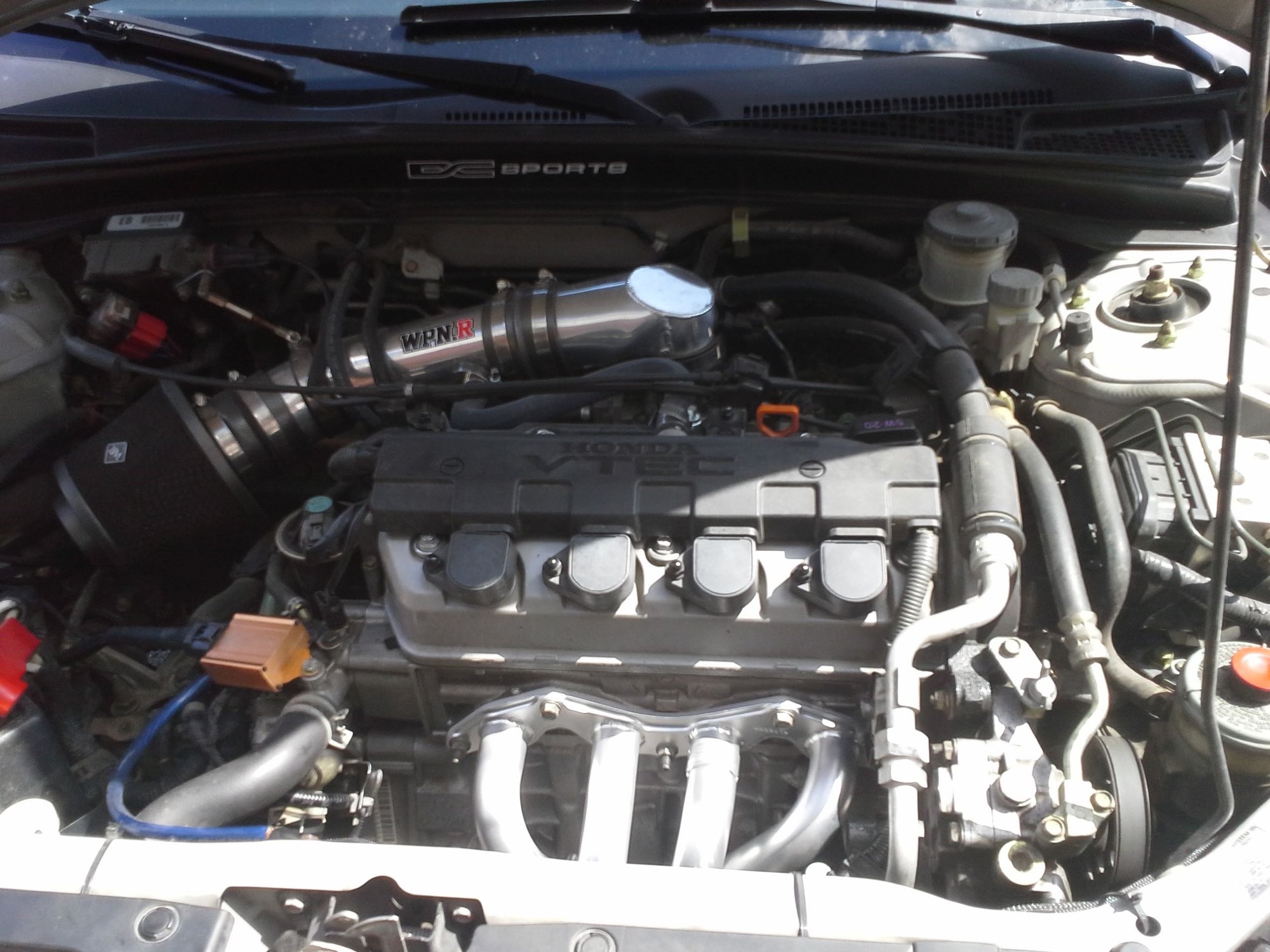

And all together, now!
The CARB sticker. I thought this thing wasn't CARB legal though.

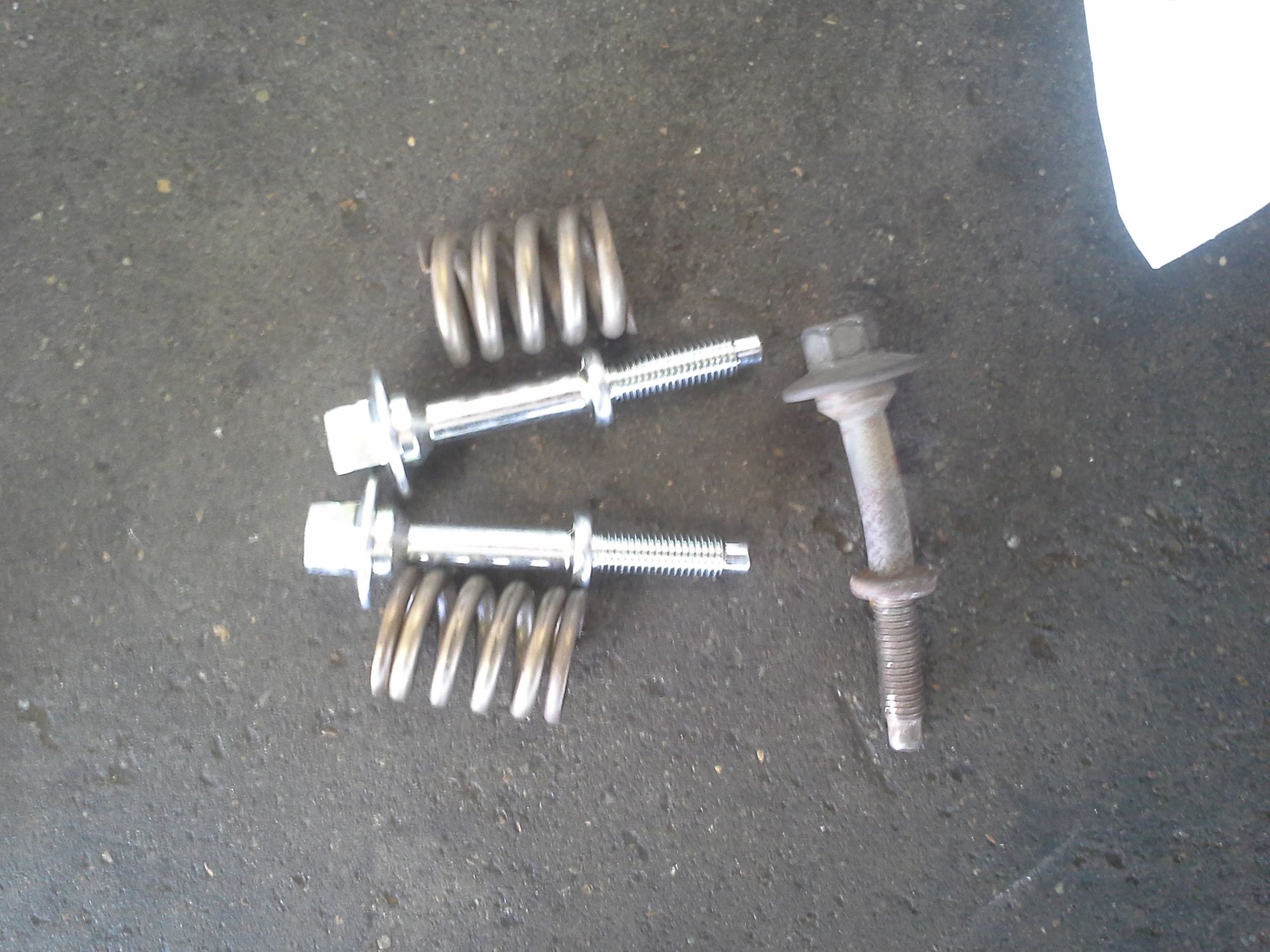

Unfortunately, what would have been an otherwise easy install was hampered by my own ineptitude. I over-torqued one of the spring bolts connecting the header to the downpipe. In doing this, it snapped so now I have an exhaust leak on the driver's side. Here you can see the offending bolt is in there. It's gonna be a booger to get it off next weekend.
Here are the two spring bolts. The one on the left no longer exists as you see it here.
Fortunately, the Honda e-Store sells them for $10 apiece, so I've already ordered another pair and will get them changed out soon. I'm already tired of smelling exhaust.
One again, the torque specs for the bolts are 23ft-lbs for the top ones and 16ft-lbs for the spring bolts. I was more careful during the reinstall a few days later. Since the downpipe was only connected with one bolt, it started warping. I recommend changing both bolts like I should have done at the start.
You can clearly see the springs, the new bolts and the warped old one here:
