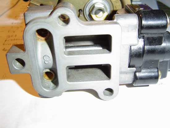

TB with iac removed
and iac by itself

I cleaned the egr valve, vtec solenoid. I couldn't remove the dam phillip screws on the iac controller. I just disconnected the coolliant lines and sprayed carb cleaner through there. All I can say is what a difference this made. Civic accelerates so much smoother. Thanks again Gearbox for the diy tuneup tips. Is there anything else I could do? I changed the evap canister and plugs already.
Old Nov 7, 2009
  #64
Rep Power: 812
Re: DIY: forgotten tune-up mods
unfortunately spraying carb cleaner in coolant line holes wont help, its the other chamber you need to clean next to the coolant lines. those screws suck tho i had a hard time taking em off.

updated with TB-IAC cleaning.

Originally Posted by gearbox
TB with iac removed
and iac by itself
what kind of throttle body is that ?
Old Jan 13, 2010
  #73
Rep Power: 812
stock d17a2 tb for auto trans
