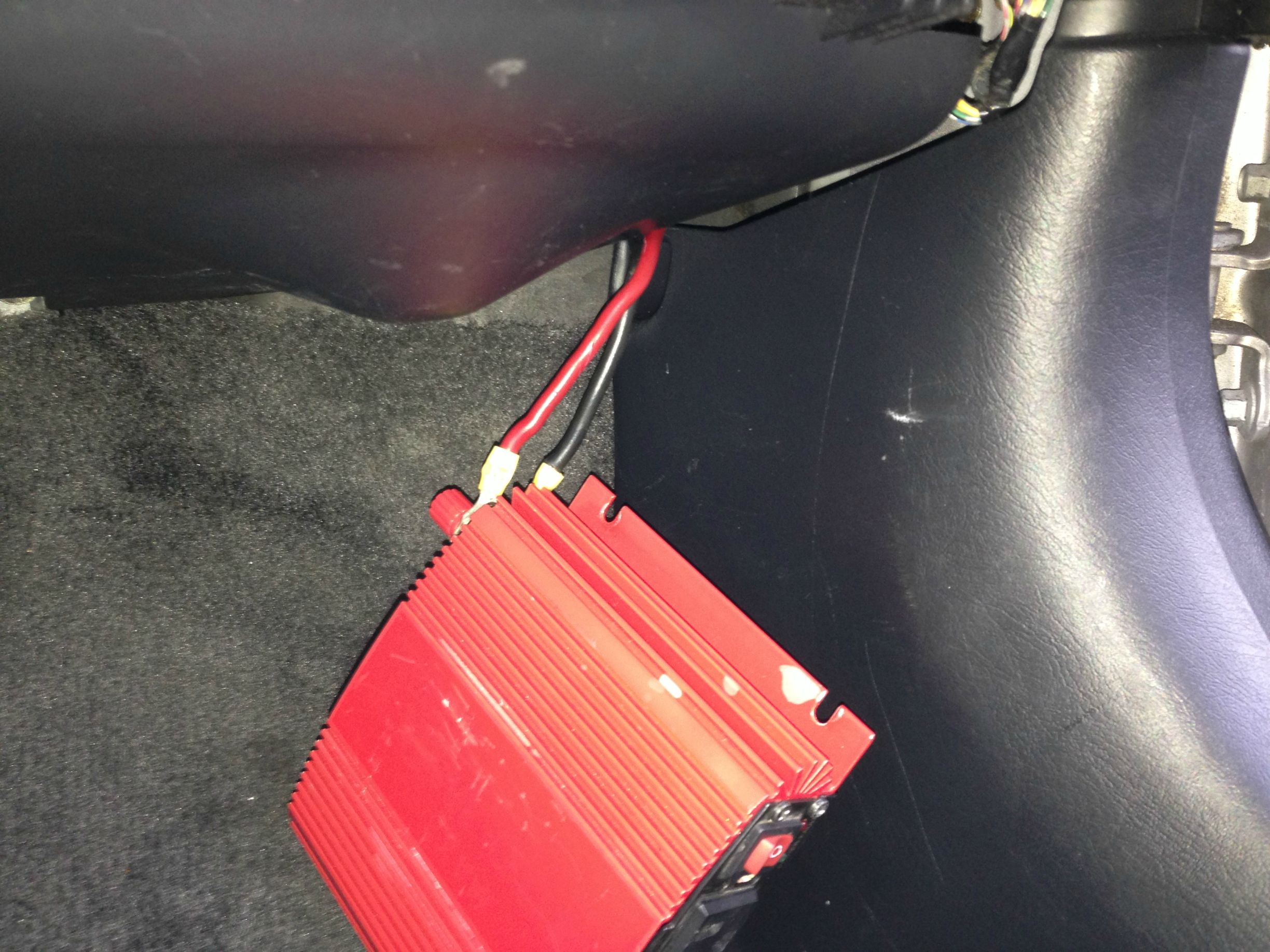

2.
Attach the cables to the inverter so you make sure you have enough. Place the inveter in the place that you want it.
