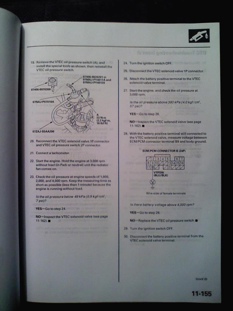

Special Tools Required
-Pressure Gauge Adaptor 07NAJ-P07010A
-A/T Low Pressure Gauge w/panel 07406-0070300
-A/T Pressure Hose 07406-0020201
-A/T Pressure Hose 2,210 mm 07MAJ-PY4011A
-A/T Pressure Adaptor 07MAJ-PY40120
-Oil Pressure Hose 07ZAJ-S5AA200
Step 1) Reset the ECM/PCM
to do this you need to pull a fuse under the hood. Its the No. 6 ECU 15A
pull this fuse for 15 seconds and then reinsert it
Step 2) Check the oil level, and refill is necessary
Step 3) Start the engine, put the car in park if you have an auto, neutral if you have a 5-speed. Hold the RPM's at 3000 RPM until the radiator fan comes on, don't turn off the car just yet.
Step 4) Time to go for a drive, accerlate in first gear to an engine speed over 4000 rpm. Hold the engine speed for at least 2 seconds. If DTC P1259 is not repeated during the first test drive the try this test 2 more times.
Is DTC P1259 indicated?
YES - Go to Step 5
NO - Intermittent failure, system is OK at this time, Check for poor connections or loose terminals at the VTEC solenoid valve, at the VTEC pressure switch, and the ECM/PCM
Step 5) Turn the ignition off
Step 6) Remove the resonator, basically your stock intake is 3 parts, the part right above the throttle body, we'll call this piece A. The middle part that runs from piece A and that extension pipe over by the battery. This middle piece is the piece you want to remove.
Note, im guessing that if you have an aftermarket intake your going to need to put your stock intake back on.
Step 7) Disconnect the VTEC oil pressure switch 2p connector
The rest of the steps will follow shortly
Old Dec 9, 2004
Got Boost???'s Avatar
Posts: 5,268
From: In a Box
Rep Power: 344
Step 8) Check for continuity between the VTEC oil pressure switch p2 connector terminals No 1 and No 2
Is there continunity?
YES - Go to Step 9
NO - Replace the VTEC oil pressure switch
Step 9) Turn the ignition switch to ON (II)
Step 10) Measure the voltage between VTEC oil pressure seitch 2p connector 1 and body ground.
Is there battary voltage
YES - Go to Step 15
NO - Got to Step 11
Step 11) Measure the voltage between the ECM/PCM terminal B9 and body ground
Is there battery voltage?
YES - Repair the open wire between the VTEC oil pressure switch and the ECM/PCM (B9)
NO - Go to Step 12
Step 12) Turn the ignition switch off (II)
Step 13) Disconnect the ECM/PCM connector B (24P)
Step 14) Check the continuity between ECM/PCM connector terminal B9 and body ground.
Is there continuity?
YES - Repair the short in the wire between the VTEC oil pressure switch and the ECM/PCM (B9)
NO - Update the ECM/PCM software if it does not have the latest software, or substitute a known-good ECM/PCM, the recheck. If the symptom/indication goes away with a known-good ECM/PCM, then replace the orginal ECM/PCM.
More to come
Old Dec 9, 2004
Posts: 5,268
From: In a Box
Rep Power: 344
Step 15) Measure the voltage between VTEC oil pressure switch 2p connector terminals 1 and 2
YES - Go to Step 16
NO - Repair open wire between the VTEC oil pressure switch and G101.
Step 16) Turn the ignition switch off (II)
Step 17) Disconnect the VTEC soleniod valve 1p connector
Step 18) Check the resistance between VTEC soleniod valve 1p connector and body ground
Is there 14-30 ohms?
YES - Go to Step 19
NO - Replace VTEC solenoid valve
Step 19) Remove the VTEC oil pressure switch (A), and install the special tools as shown, then reinstall the VTEC oil pressure switch
Step 20) Reconnect the VTEC solenoid valve 1p connector and the VTEC oil pressure switch 2p
Step 21) Connect a tachometer
Step 22) Start the engine, put the car in park if you have an auto, neutral if you have a 5-speed. Hold the RPM's at 3000 RPM until the radiator fan comes on, don't turn off the car
Step 23) Check the oil pressure at engine speeds of 1,000, 2,000, and 4,000 rpm. Keep the measuring time as short as possible (less than 1 minute) because the engine is running with no load
[I]Is the oil pressure below 49 kPa (.0 kgf/cm^2, 7 psi)?
YES - Go to Step 24
NO - Inspect the VTEC solenoid valve
Old Dec 9, 2004
Posts: 5,268
From: In a Box
Rep Power: 344
Step 24) Turn the ignition switch off
Step 25) Disconnect the VTEC solenoid valve 1p connector
Step 26) Attach the battery positive terminal to the VTEC solenoid valve terminal
Step 27) Start the engine and check the oil pressure at 3,000 rpm
Is the oil pressure above 390 kPa(4.0 kgf/cm^2, 57 psi)
YES - Go to Step 28
NO - Inspect the VTEC soleniod valve
Step 28) With the battery positive terminal still connected to the VTEC solenoid valve, measure voltage between ECM/PCM connector terminal B9 and body ground.
Is there battery voltage above 4,000 rpm?
YES - Go to Step 29
Step 29) Turn the ignition switch off
Step 30) Disconnect the battery positive terminal from the VTEC solenoid valve terminal
Step 31) Disconnect the ECM/PCM connector B (24P)
Step 32) Check the continuity between the ECM/PCM connector terminal B15 and body ground.
YES - Repair the short in the wire between the VTEC solenoid valve and the ECM/PCM(B15)
NO - Go to step 33
Step 33) Connect VTEC solenoid valve 1p connector terminal No. 1 to a body ground with a jumper wire
Step 34) Check for continuity between ECM/PCM connector terminal B15 and body ground
Is the continuity?
YES - Update the ECM/PCM software if it does not have the latest software, or substitute a known-good ECM/PCM, the recheck. If the symptom/indication goes away with a known-good ECM/PCM, then replace the orginal ECM/PCM.
NO - Repair open in the wire between the VTEC solenoid valve and the ECM/PCM (B15)
Old Dec 9, 2004
Posts: 5,268
From: In a Box
Rep Power: 344
If you need further instructions on things like inspecting and/or replacing the VTEC solenoid valve, replacing the ECM/PCM, or anything else, just post here.

did you get all that out of the helm manual?
Old Dec 10, 2004
Mystic3030's Avatar
Yup, i'm an A$$hole.
Posts: 4,277
From: Florida
Rep Power: 329
Mystic3030 has a spectacular aura aboutMystic3030 has a spectacular aura about
that sounds more like a honda tech service manual
Old Dec 10, 2004
Posts: 5,268
From: In a Box
Rep Power: 344
Bingo
Just sharing the knowledge with my fellow 7thgeners
YES - Go to Step 28
YES - Go to Step 29
NO - Go to step 33
Is the continuity?

Originally Posted by emicha
How I can view the pictures of this great post?
Sorry about the fuzzy pics, phone cam.
